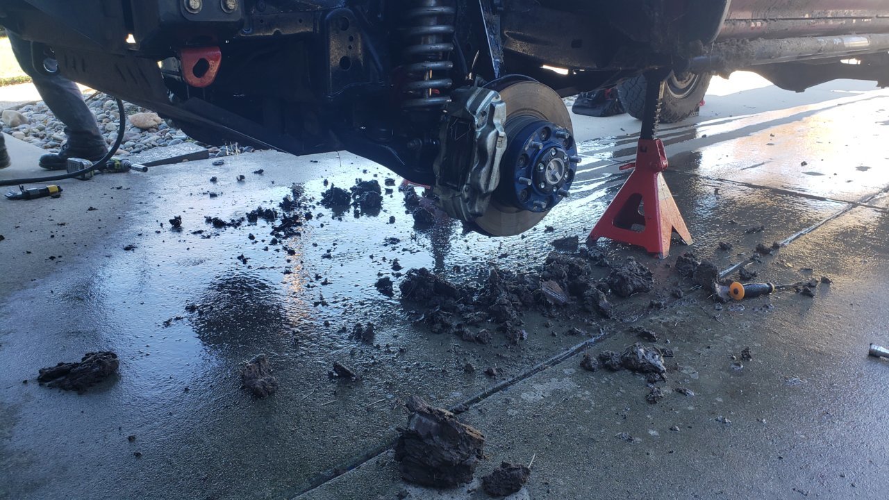

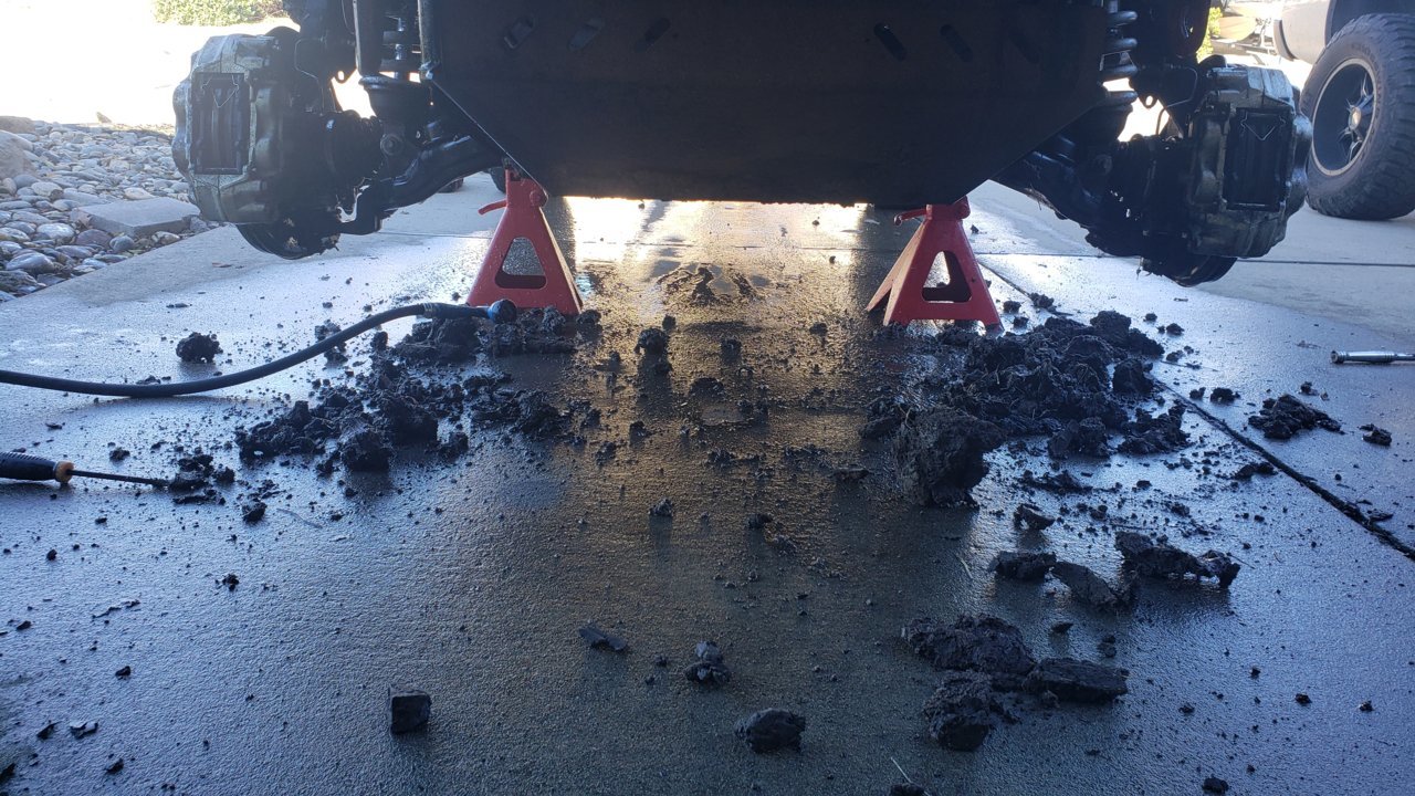

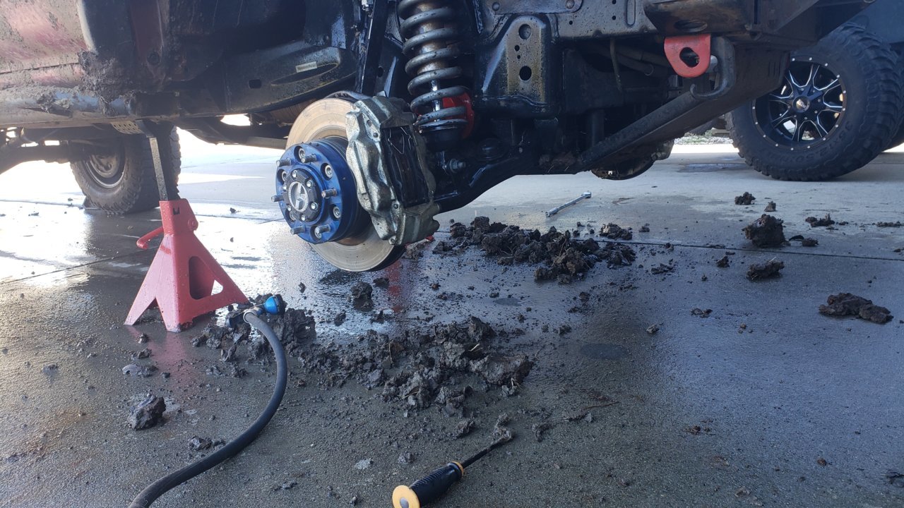

    And this is what I got to clean up :thumbsup:

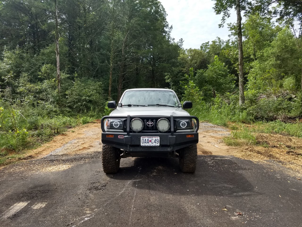

    Pumped to see what yours end up like. I don’t know how you want your wired but for mine I used these halos (boring only white) and they are always on unless my Peking lights or headlights are on. Figured it might help heat management. I used this relay and connected wires to the halos, ground, ignition switches power, and the parking light wires. If you want more info let me know. This is what mine looks like if you are interested. (100mm halo with everything blacked out)

    I was in the same place. Definitely not a professional job but I’m more than happy with how they look and the wiring isn’t half bad compared to some of the other stuff I have done. I think some red (or amber if you are worried about legality) halos would look good on yours.
    There is much more complicated stuff that people do to them but I did what I felt comfortable with without spending much so if I want I could make a nice set in the future.

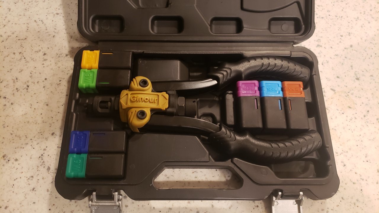

    Well, the Amazon dude stopped by to see me.
    More tools to fuck with :D

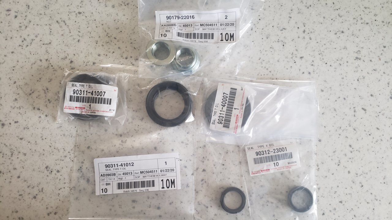

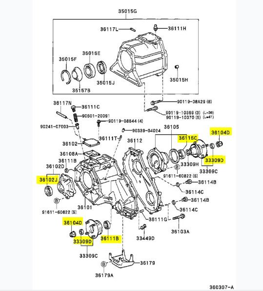

    My Tcase has been seeping a little oil. Not sure if it's one of the input/output seals, or if it's the gasket maker I used to seal the 2 sides when I reassembled the shell after doing the work to install the twin sticks.
    I'll have to drop the case to reseal the shell. So I decided to figure out which input/output seals are there to replace.
    Here's the diagram. I ordered all of the seals and stake nuts associated with the input/output shafts.
    Ordered on Wednesday from McGeorge Toyota in Virginia... to my suprise, they all arrived today.

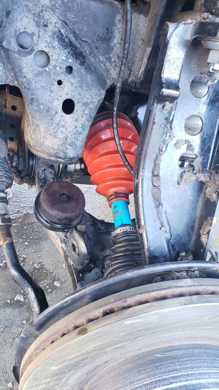

    Where does the ABS go?
    Did you ditch it?

    Mine never had ABS (thankfully)

    I should have ditched it. I feel that it's super dangerous in this truck.
    I had the opportunity to ditch it when I did my 4x swap (my 4runner spindles were non-abs) but I swapped over to my abs spindles. Was worried about insurace/accidents etc. :(
