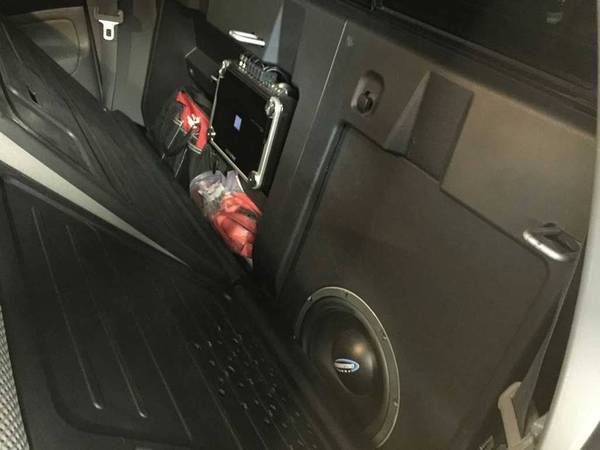

    Added a stereo system:
    Pioneer AVIC Z150BH installed with Scosche Kit
    Realm LS6C components front and rear doors
    Crossfire BMF 10in sub - Alpine PDX5 amplifier
    BAMF Sliders

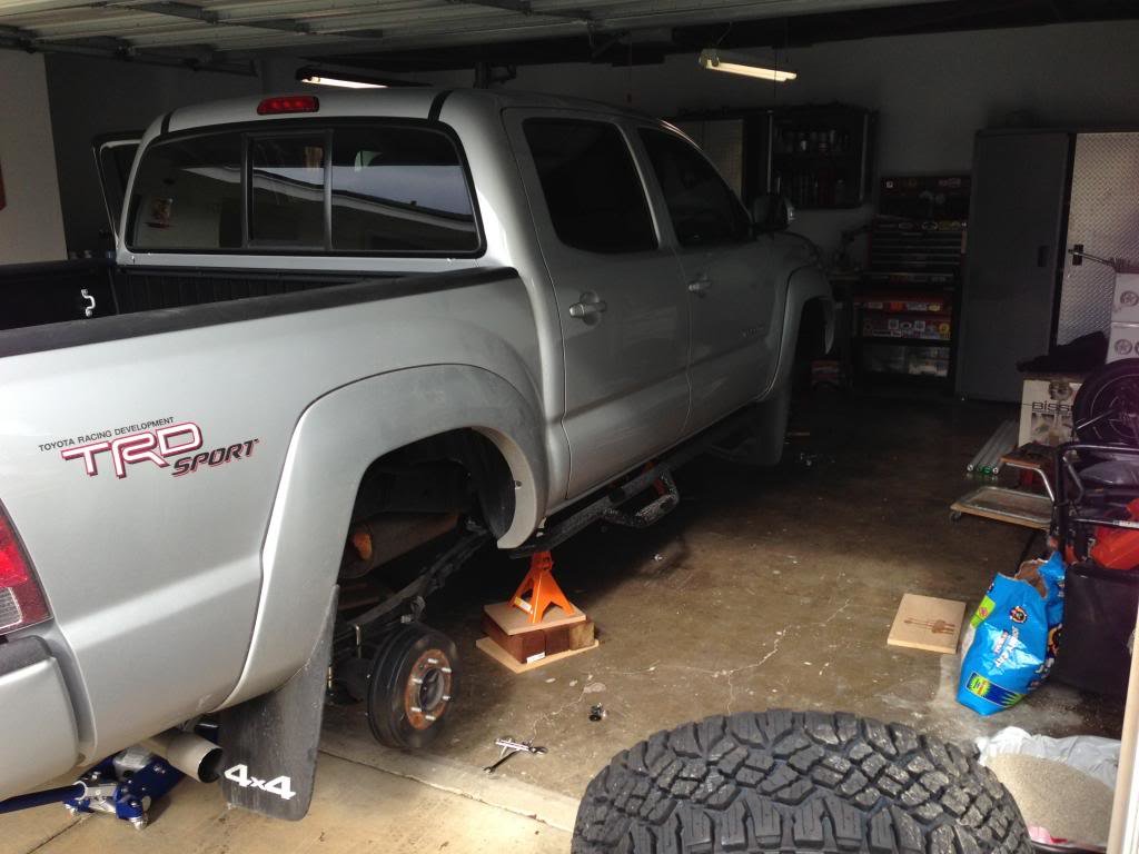

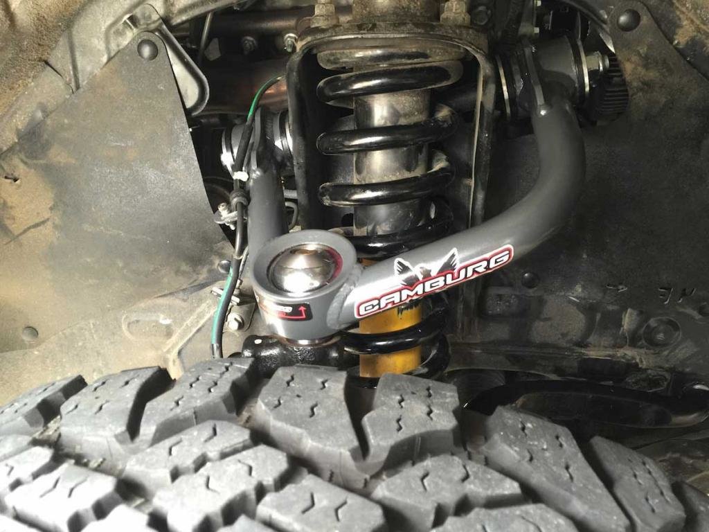

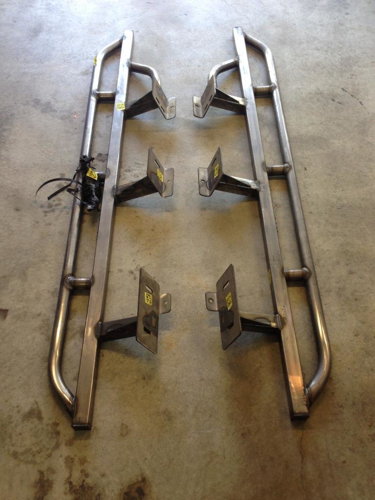

    I'm lagging. Still need to add my sliders, Snugtop, Stereo System install and now my UCA's.

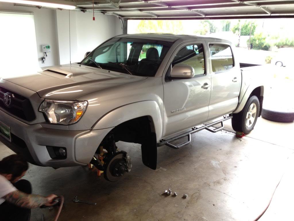

    Haha those aren't mine, we did the install at my buddy's house. I have some proper stands :)

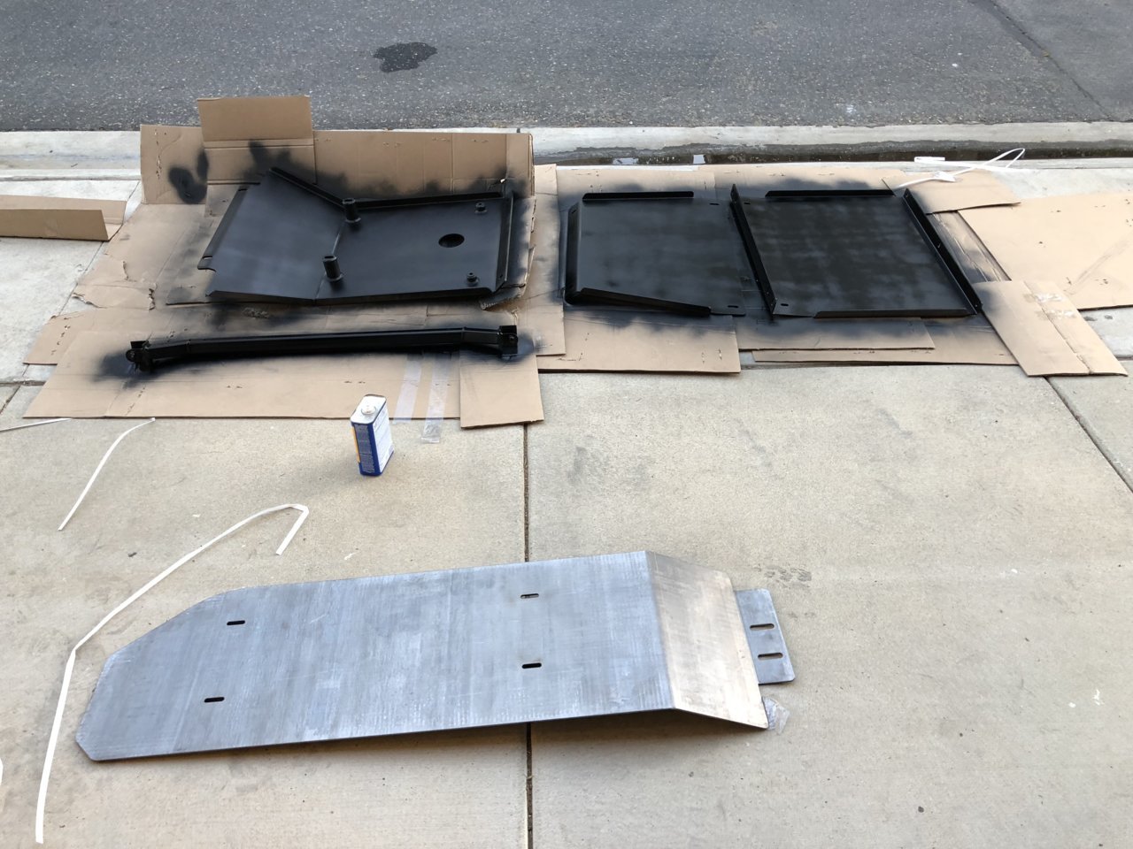

    SOS Concepts IFS Skid Plate
    SOS Concepts Transmission Skid Plate
    SOS Concepts Transfer Case Skid Plate
    SOS Concepts Gas Tank Skid Plates Skid Plate

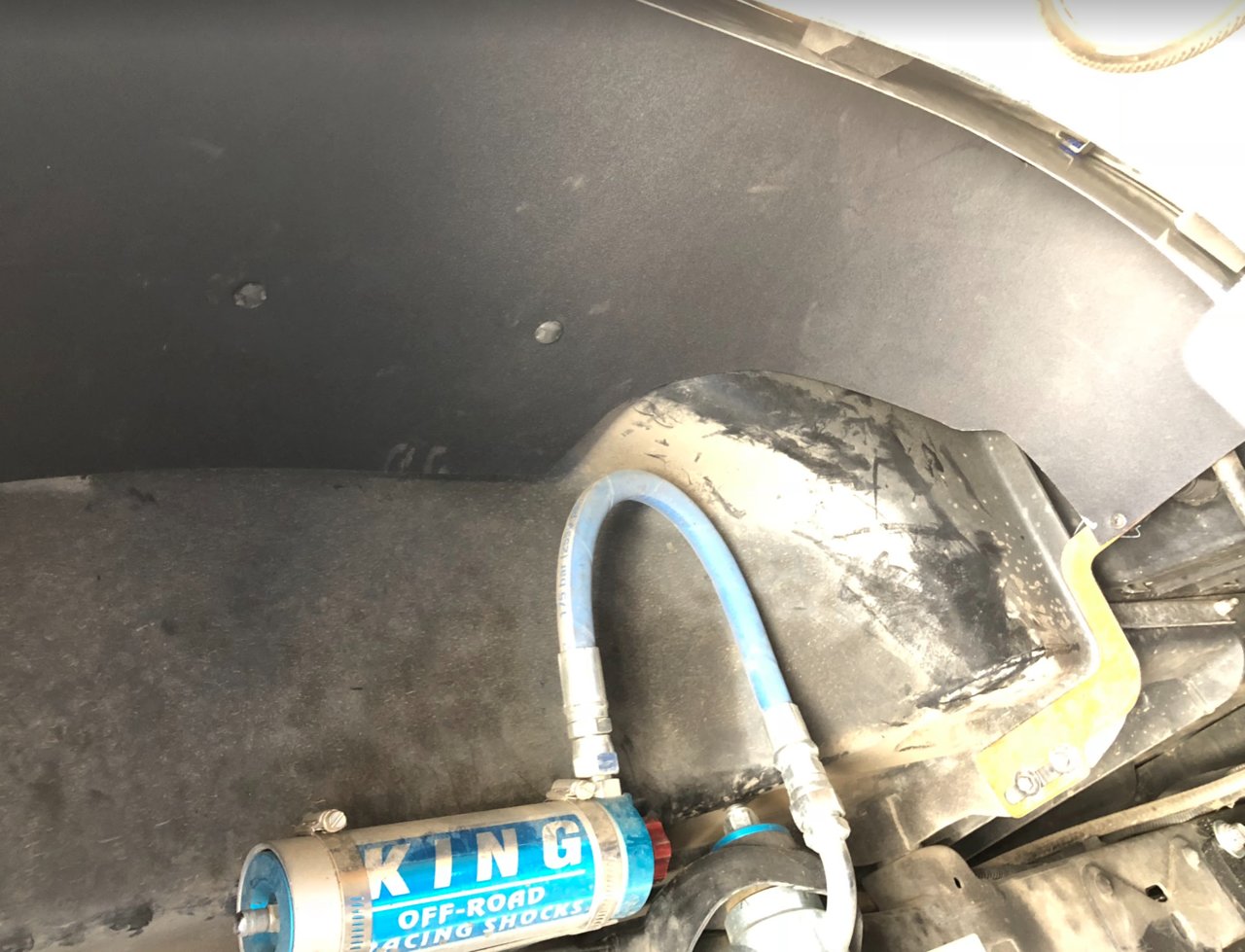

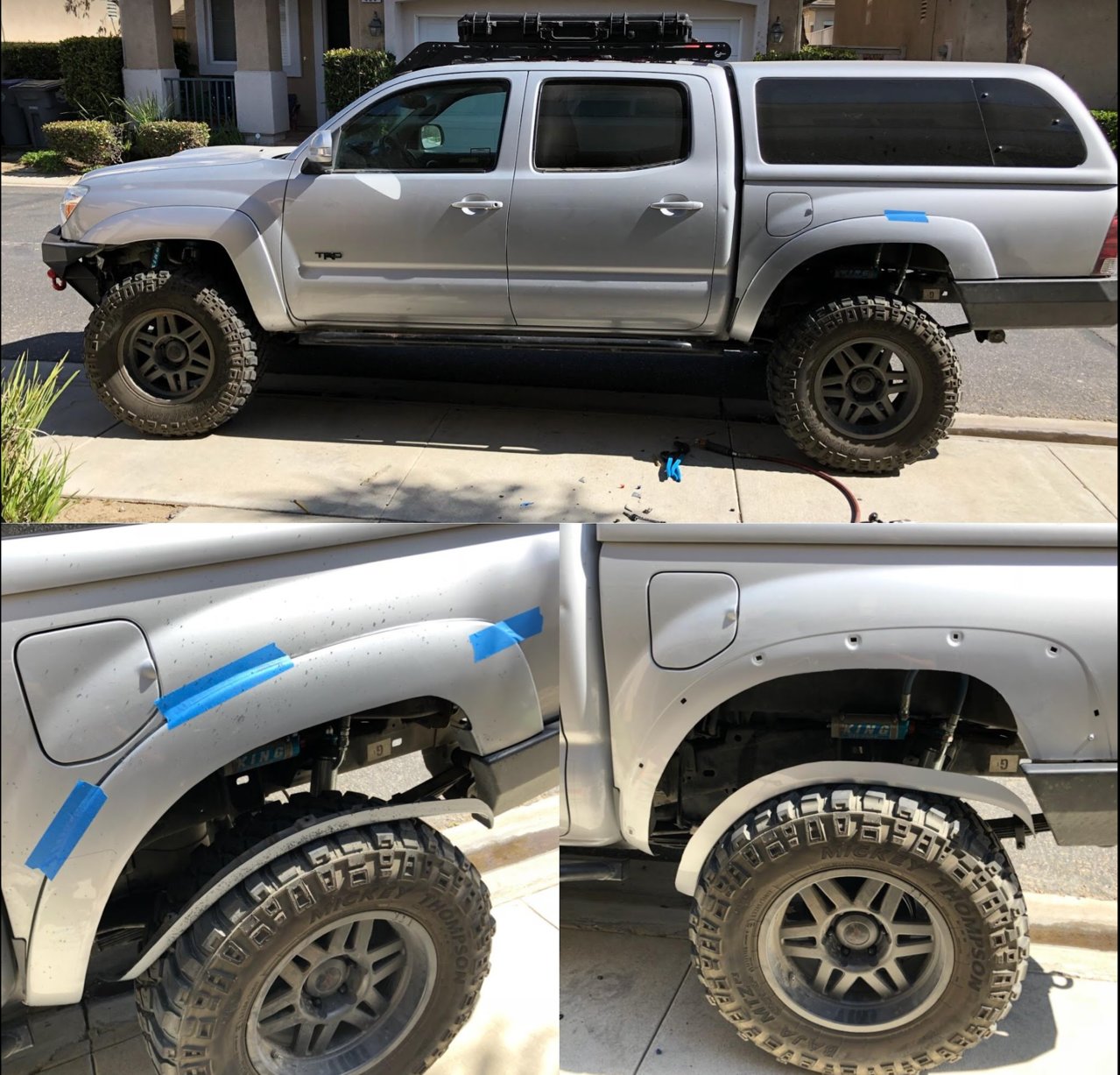

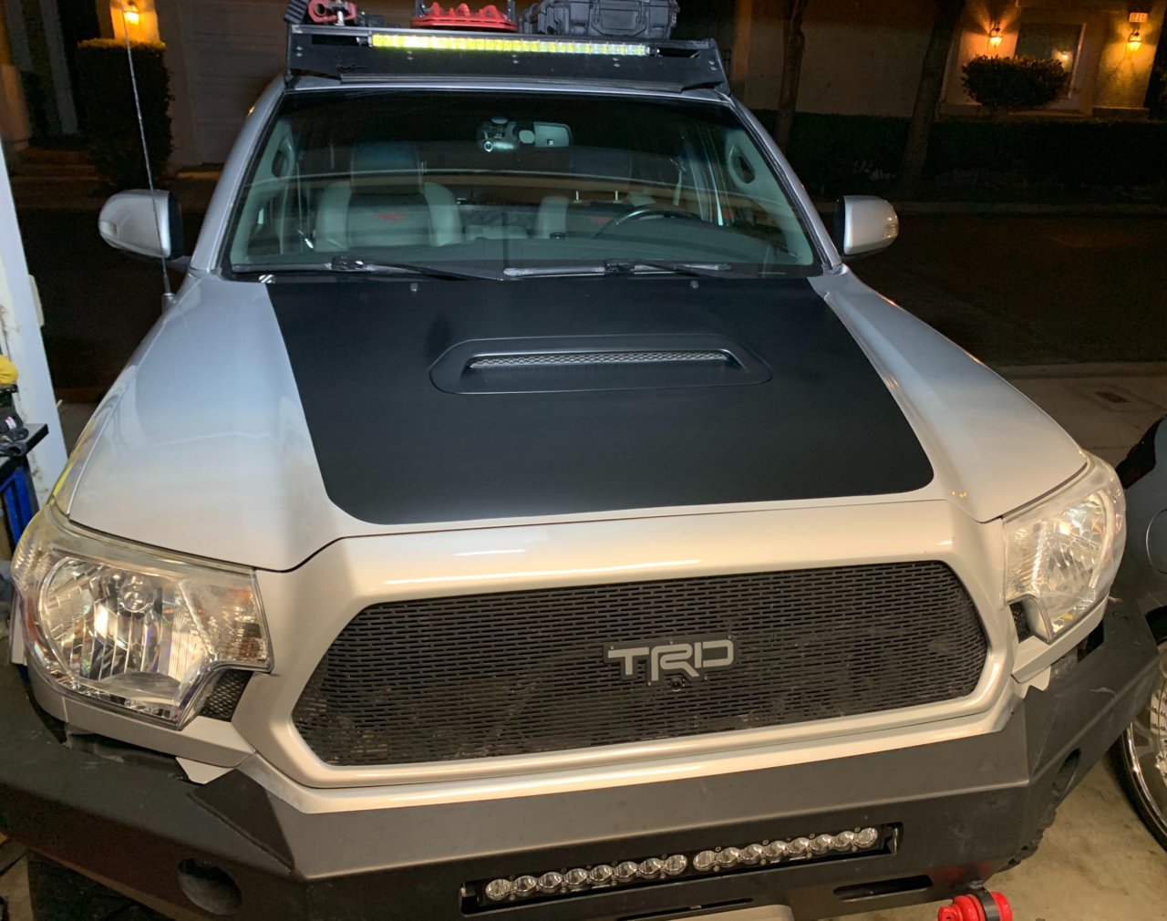

    After changing to the 285/70 17 MTs, my rear fender trim started to get ripped off by the tires on flex. Next step was to clearance the fenders.
    I also made some new inner fender liners out of HDPE sheet so rocks wouldn't dent up the body from underneath:
    Wrapped the hood to reduce glare. this wasn't a kit, I used 3M cutting tape for the outside edges.

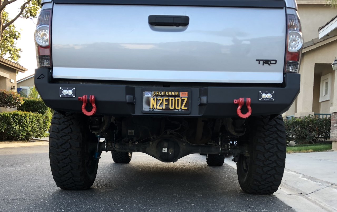

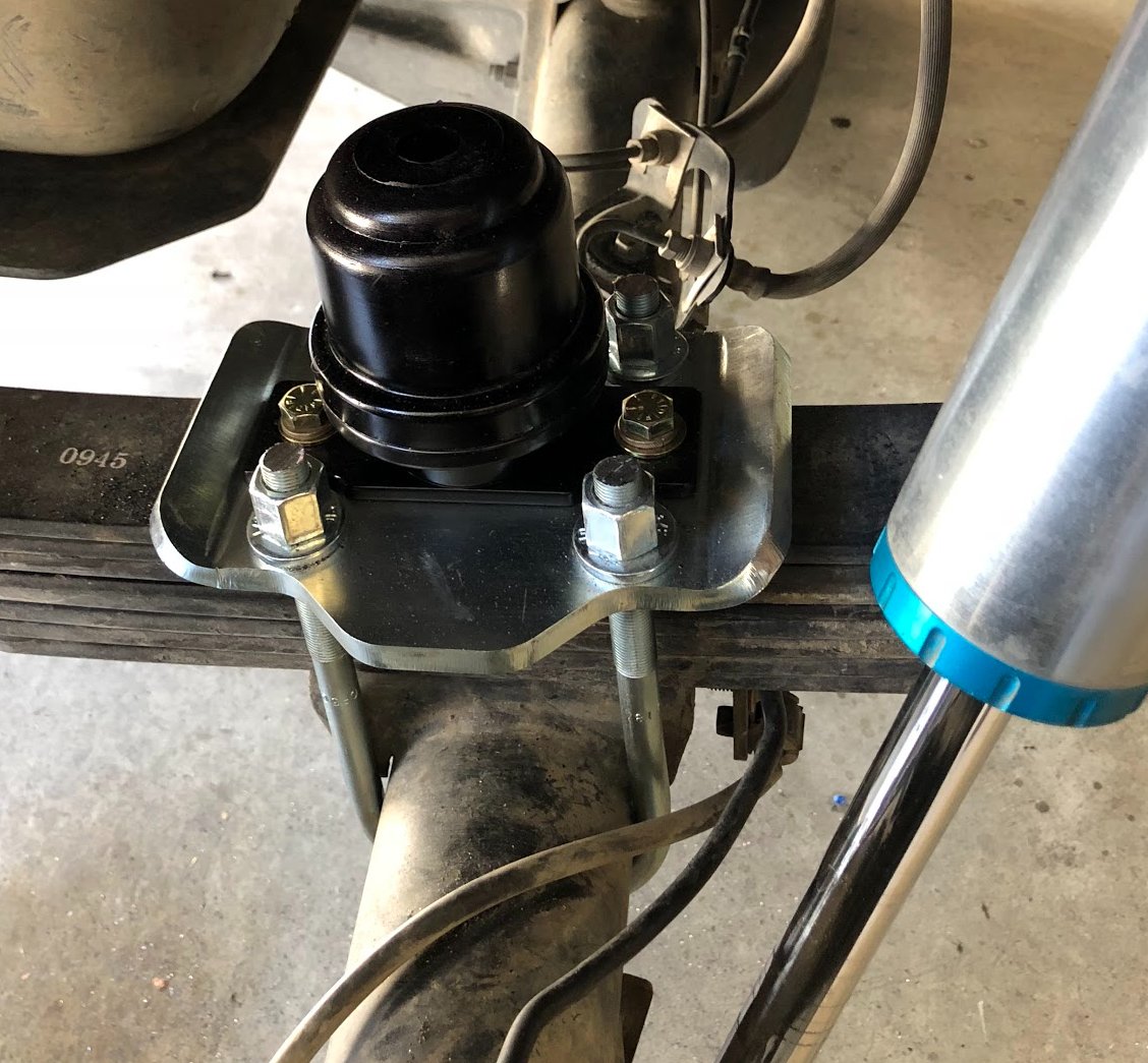

    Added Wheeler's Super Bumps front and rear (with flip kit):

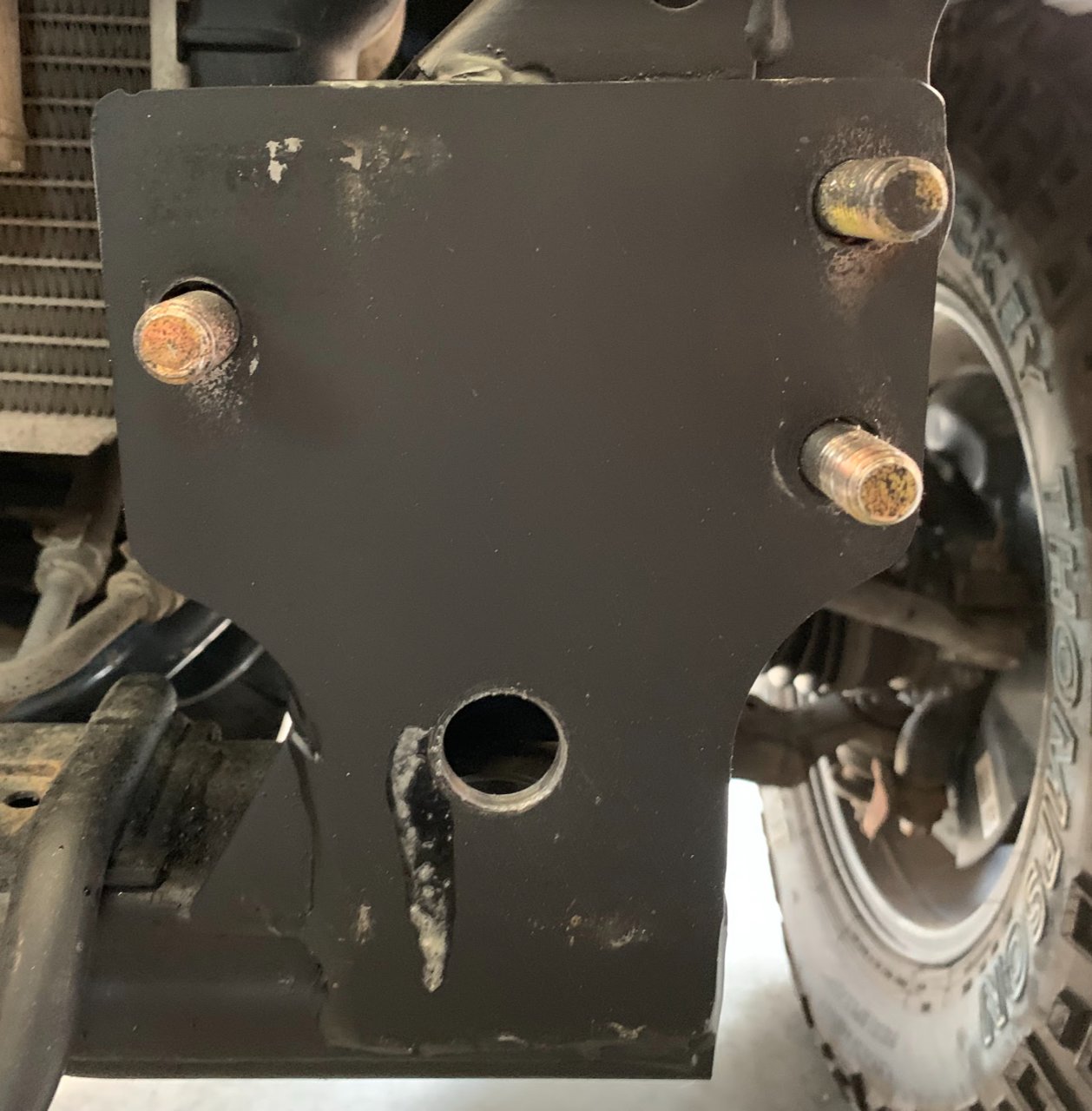

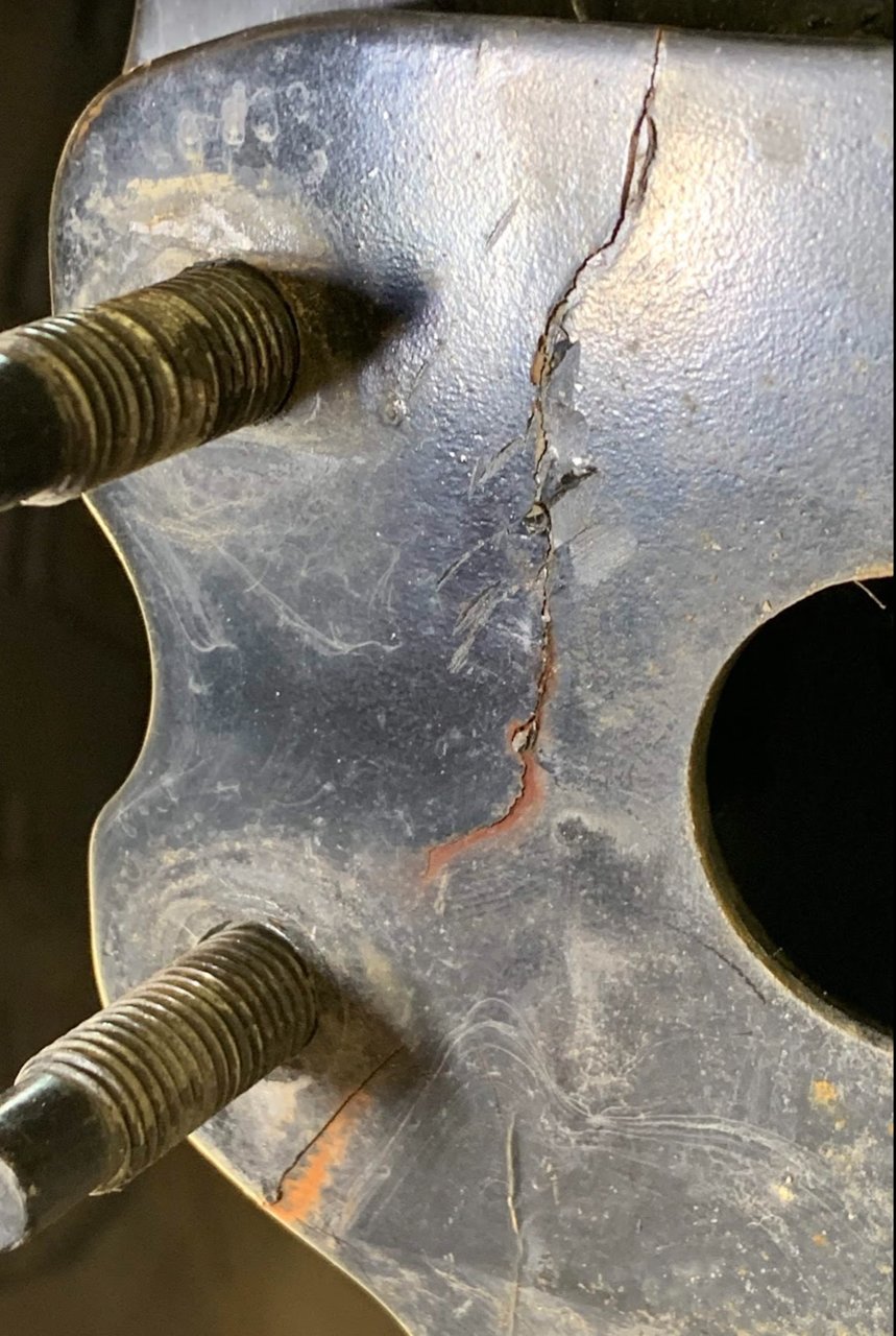

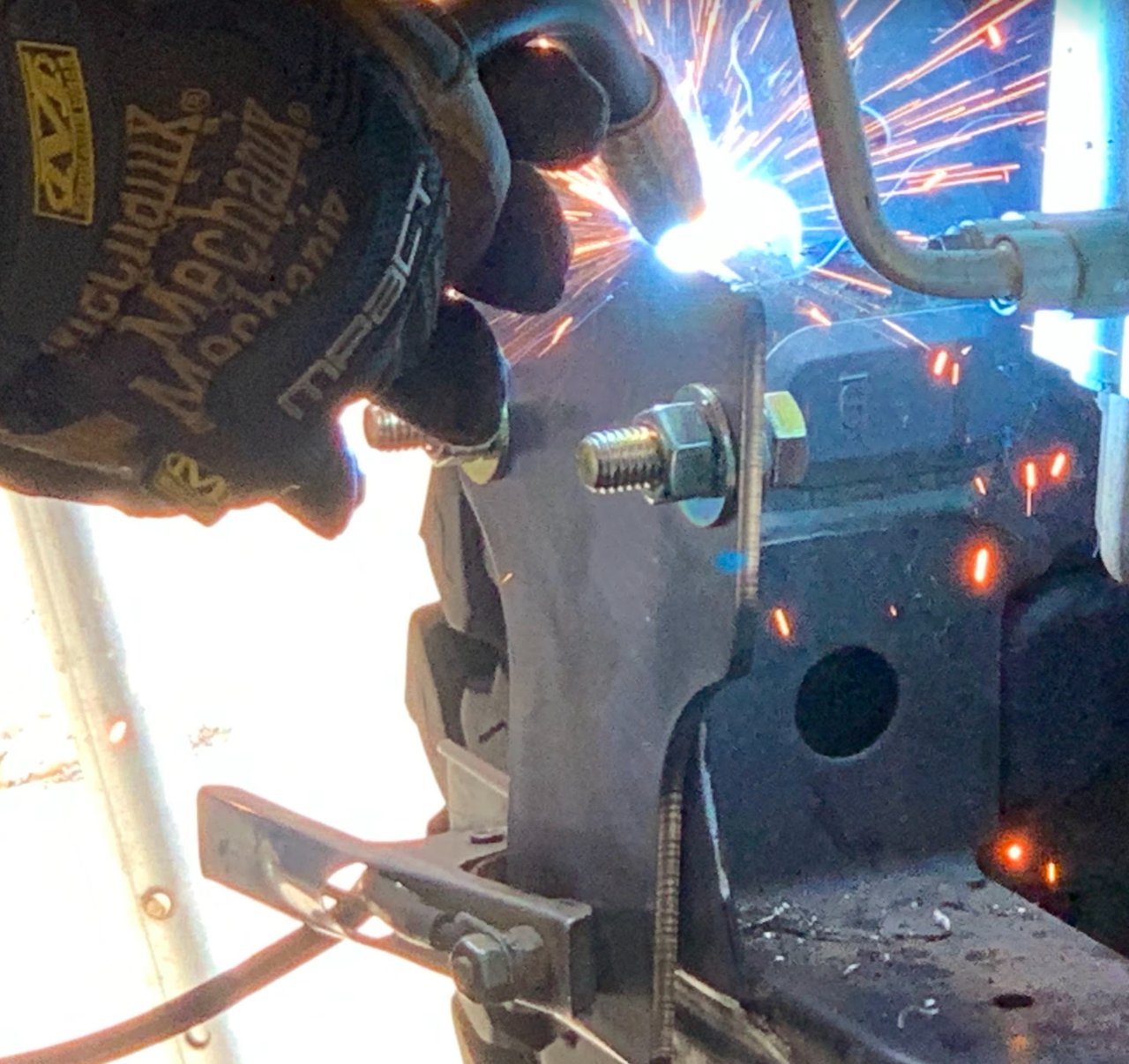

    Added bumper bracket reinforcement plates after seeing my buddy's brackets crack. Here's a pic of his before I did his plates:
    Adding the plates to mine:
