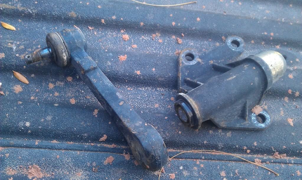

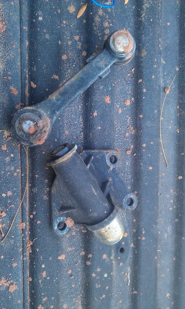

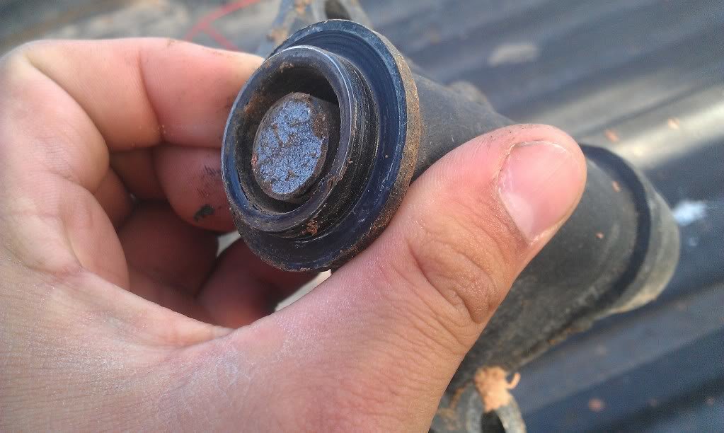

    Pictures of sheared bolt on idler arm.

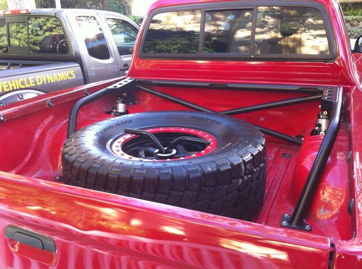

    This, I believe, is the cantilever system by Engage

    Here is a little better view

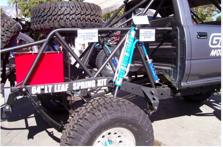

    canti systems are bad ass, but require ALOT of work to get them working properly and to tune the shocks. the top pic is a nissan titan and the canti was built by a place called boneyard fab here in my town (but they are closed now). the 2nd pic is a jeep JK with the off road evo canti kit.
    motorbikemike has a canti kit, but it's above the bed.... different take on it. the shop that built my bedcage built his canti and it's a work of art. check it out

    Ah i remember seeing that video a while back and it's so badass! Are these cantilever kits something that have to be built from scratch aside from the bed cage or is their a company that sells them as a kit. I fear This will cost almost as much as a 4 link.

    for our trucks, they are custom built. some companies offer kits for rangers, and at one time engage offered at canti kit for tacomas.... but i wouldn't go that route.
    like i said, there is alot of math and work to make a canti kit, and then more work to make it function. realistically, i'd just go with a sping under leaf/bypass set up with a simple cage similar to mine to maximize left over bed space. if you get a t-100 or tundra axle you'll be able to run the shocks outside the frame rails and it'll be much easier to keep most of the bedspace with a simple cage deisgn

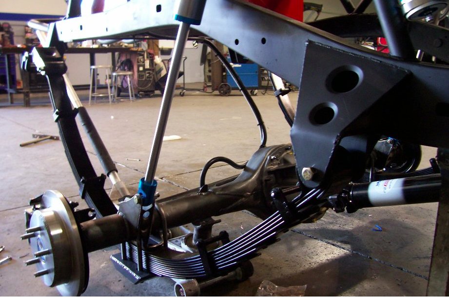

    I'm curious as to what other advantages besides more up-travel comes with doing a spring under the axle conversion. I'd like to do spring under but since I do the occasional rock crawling ect I would hate for the u-bolts and springs to get caught up on rocks since it's now closer to the ground. Could I do the rear and make it spring over like it is currently with out having my rear end in the air? Also who makes spring under conversion kit's that will work with the deaver's i plan on getting.

    look at adrian's truck from icon, hes got a tundra axle with full leaf under and tripples. badass set up with almost full bedspace. it's its more reliable and 1000x easier then cantilever. if wanted u could put ur spare tire underneath as well and have even more space
