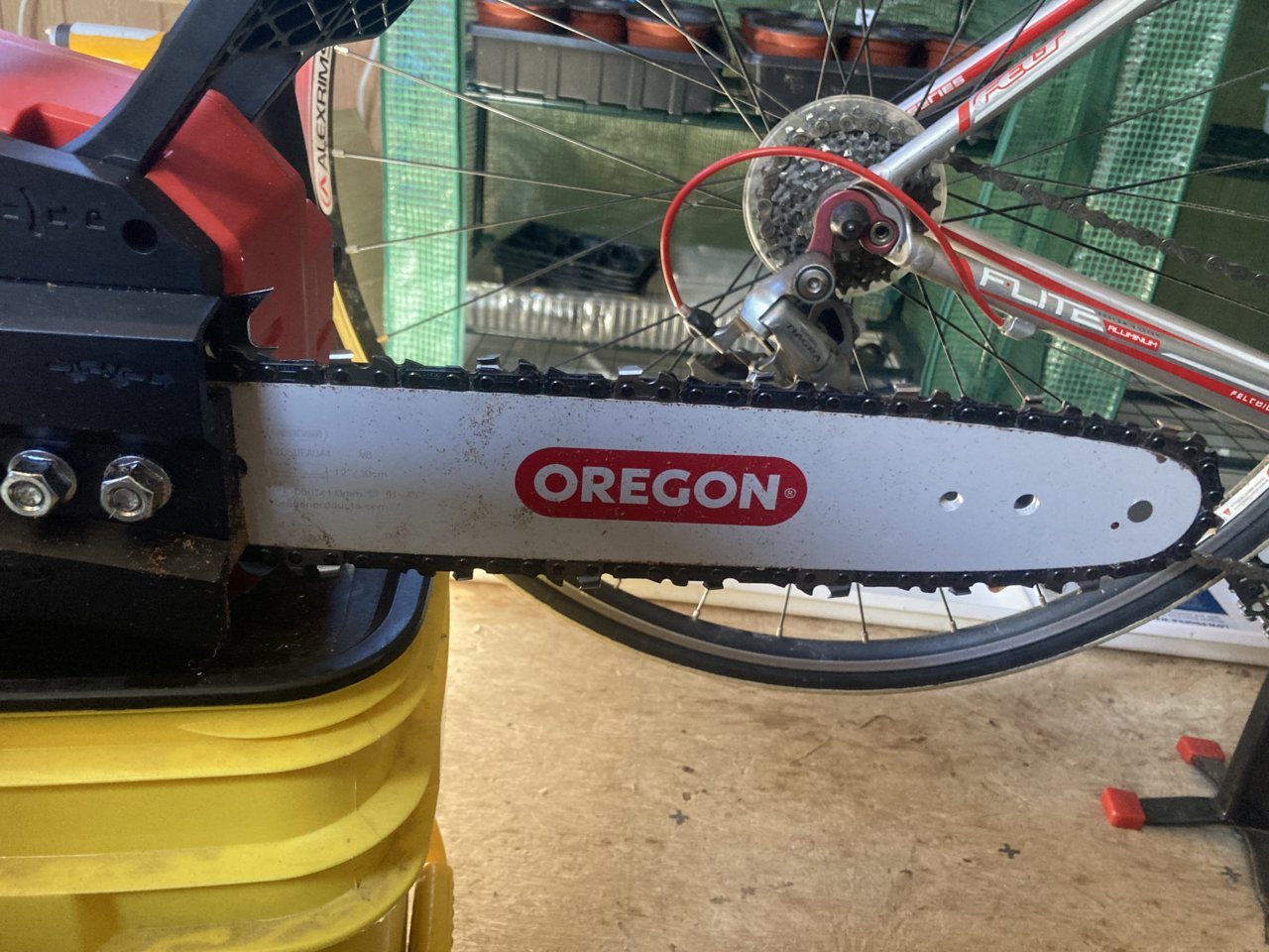

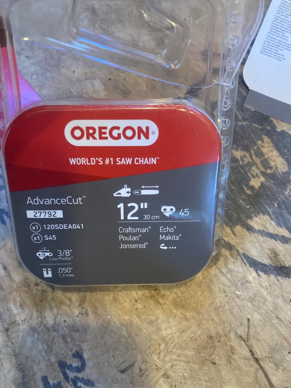

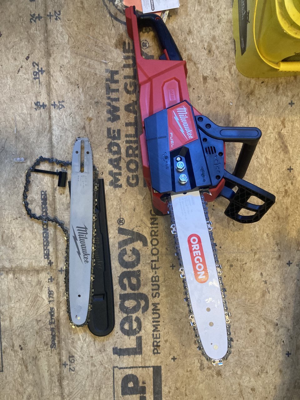

    I bought a Milwaukee M18 after selling my two Stihl chainsaws. I modified the saw and I am very satisfied with it for now. M18 chainsaw review with 12” Oregon Bar and chain.
    Good replacement for Stihl MS 192TC that I used to have. It is by no means a replacement for the FarmBoss 290!
    The Oregon bar and chain are slightly larger gauge but the chain is shorter and oils well with the existing oiler. 0.043 narrow kerf of the Milwaukee stock bar and chain IMHO are too small and leads to more binding when cutting. The Oregon bar I chose came with a chain and had a part number of 27792.
    I feel like the M18 chainsaw is a better fit for the 12” bar combination and would recommend it to others at this point. We are still talking that the M18 with a 12” bar can handle a tree diameter of 20-24” which is much larger than any on the properties I currently own. I’m only a few cuts in but feel confident this is the right modification to the saw.
