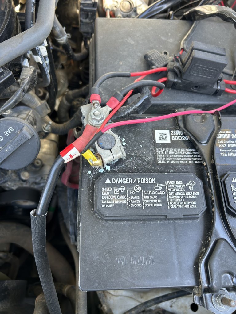

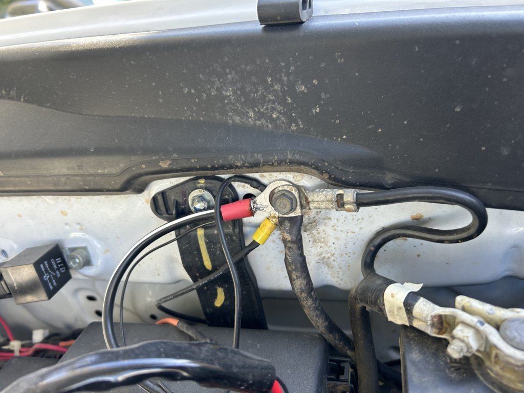

    Hello all,
    Over the years I have added on to my truck connected to the battery many times leaving me with a bit of a mess. Wondering if there are any solutions to clean this up. Any suggestions would be greatly appreciated.

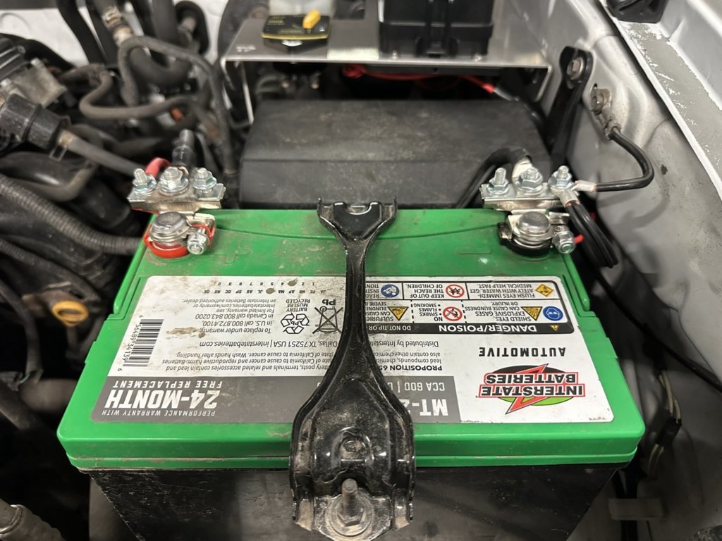

    "Military style" posts will go a long way in cleaning up flaky battery connections. Make sure you get lead ones, there are some out there that aren't and they will crack the first time you torque them down.
