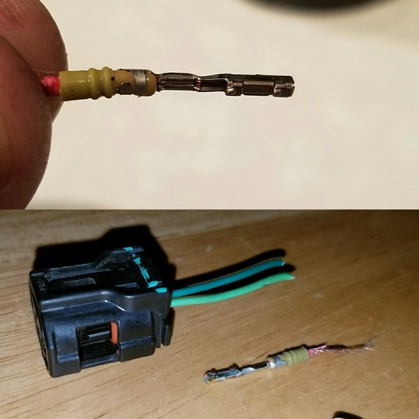

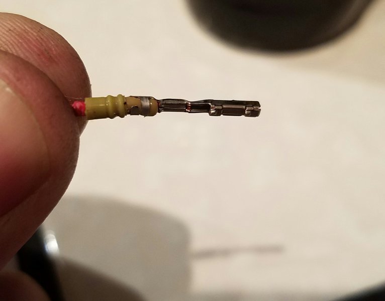

    So I had a mouse chew though a wire, resulting in a brake malfunction/CEL warning. Of course the stupid mouse chewed right at the connector, so splicing or soldering was not an option. Does anyone know where to get these metal pieces at a local store? I'm in So Cal, so I'd guess there'd be something local, otherwise, I might go to a junkyard just to pilfer one of these out of a harness.

    It's in between the intake plenum and intake manifold.

    It looks like the first one, but i'm supposed to go to Pismo this weekend, and a drive to PHX doesn't sound fun tomorrow.... but it is comforting to know that they have 27,000 ready to ship.... Thanks man! hopefully Napa can use that part number to get me something

    Try Fry's Electronics they are online and have brick and mortar stores. I have taken connectors, pins etc to the store to find what I need

    You can buy these from Toyota with a short length of wire already crimped onto the connector. Part number is 82998-24250.
