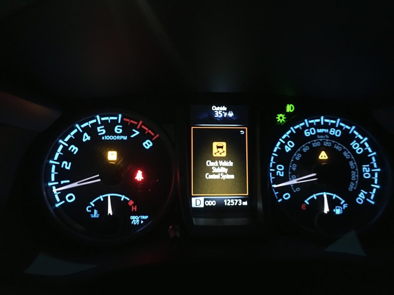

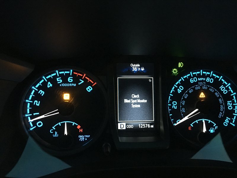

    Last week my battery died for the first time after a 3 day trip out of town.. no lights were left on, wouldn't even jump from another car. Battery was pulling >2amps. It's roughly 6 months old with just over 12k on the odo. 2 days later same thing. Dead as a door nail, only took a few hours for it die that time after driving. Went to the dealership yesterday abd they did a battery load test and said everything checks out it's good to go, yet the BSM error won't turn off and the traction control light won't turn off, WTF? Guy says he can just have someone clear the code, and wouldn't give me a copy of the battery test results. Sure as shit, heading out the door for work today and the truck is dead again.
    1. Anyone have issues with truck consistently being dead?
    2. Who is running an aftermarket battery? What brand/model should I go with? (If it's even the battery that is bad)
