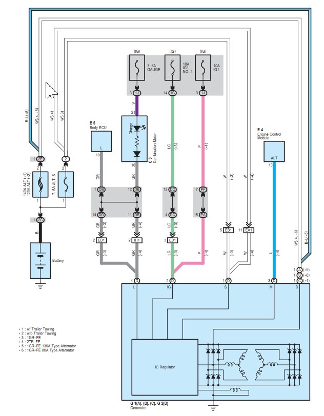

    I have a 2009 2.7 4wd. I have gone through several batteries and changed the alternator 4 times. Whenever the truck hits around 2100 rpms either moving or in neutral my battery light comes on and stays on. I have to recycle the key and it goes off. If I shift any gear under 2100 the light does not appear on the dash. Im pulling my hair out for months over this.

    check battery to frame ground(s) closely, check positive cable between alt and battery. Are they loose? Pull them around with your hands. Use a meter to check for a large voltage drop from one end of the cable to the other. For example, electrically, there should be no difference between the positive terminal of the alt and the positive terminal of the battery. Same with the battery ground cable.
    Looking at the diagram above, terminals IG and S should have 12 volts, pretty sure L should too. Probe the connector and make sure the 12 volts doesn't flicker or go away. Wiggle the harness with your hands, flex stuff around..
    Do all this stuff with the engine running
