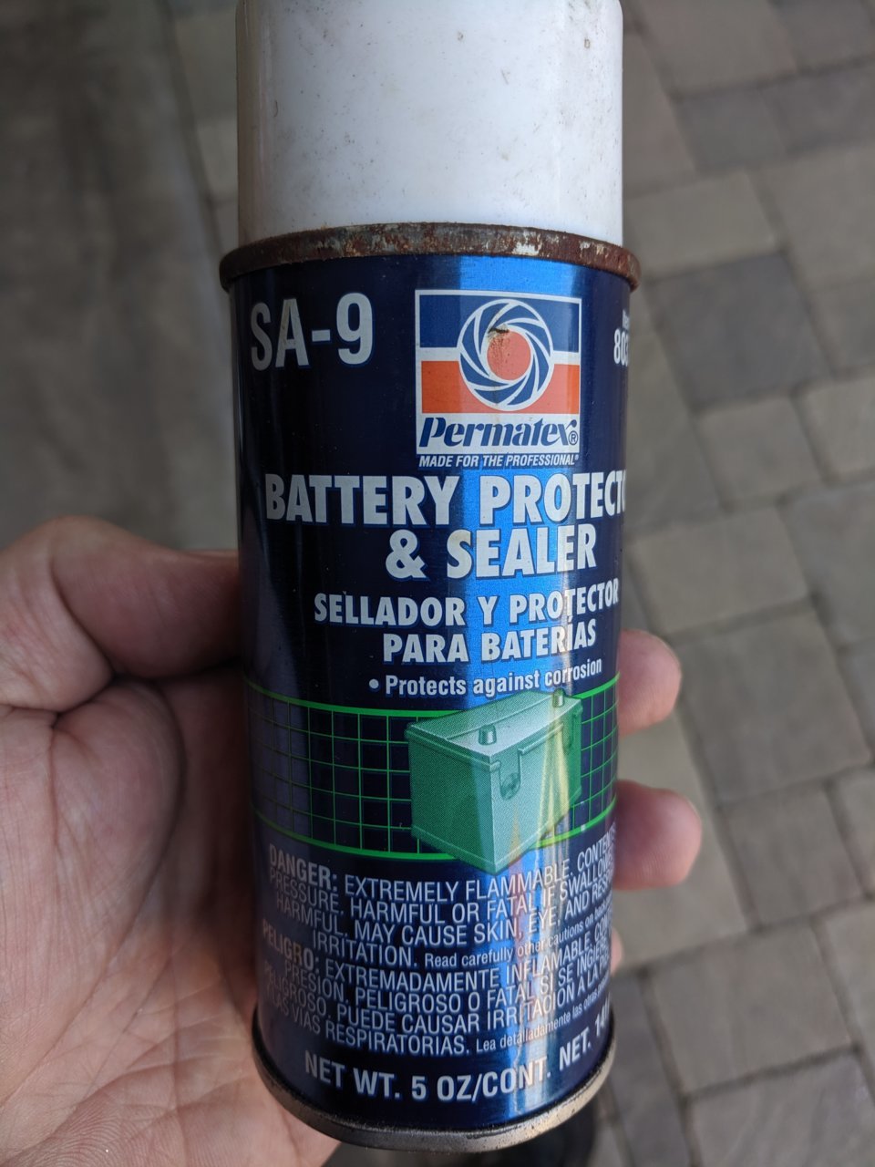

    Not suggesting to tear it apart, but yes terminals need to be clean, I found a good battery terminal spray that keeps the corrosion down and the terminals looking clean. Certainly driving on the beach like in his build thread could add an additional layer of corrosion potential.
