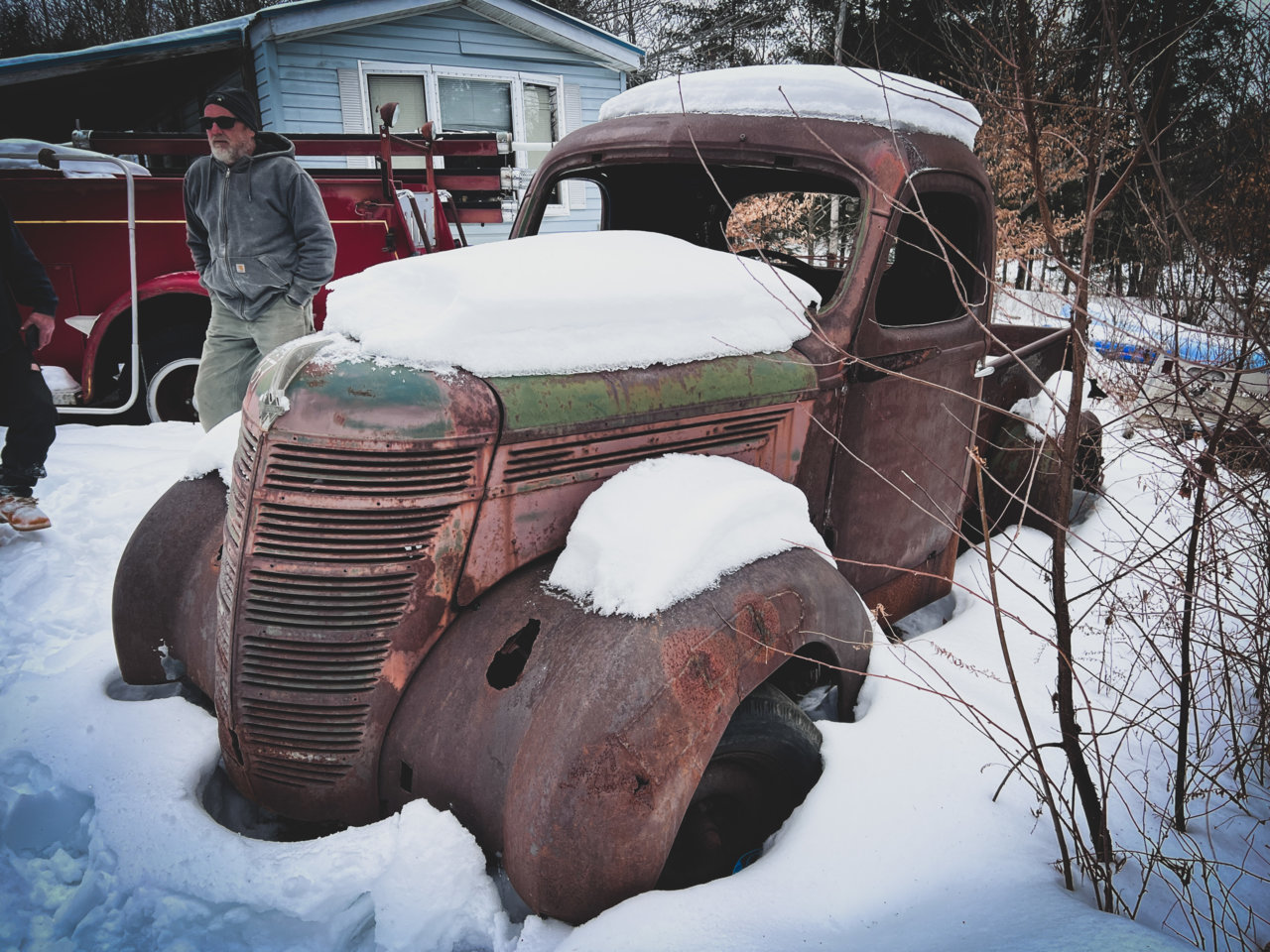

    All right here we go. I sold my 2016 tacoma for way more money then it’s worth. Bought a 1939 International D2 PickUp and putting a 4wd reg cab tacoma chassis under it. Keeping the abs and using swapping transfer case for a NP205. I’m dropping a cummins R2.8 And Tremec tr-4050 in it and putting a built dana 60 in the rear. All of this sitting on the higher end OME suspension and custom leaf pack.
    the abs is controlled on its lonesome just buy wheel sensors. So that is easy.
    but the 4wd is all digital in these damn things. How am I going to swap t-case and still get the front end to engage the ADD
    thanks for your help.

    Other alternative is drop an auto FJ case in with the AWD FJ tube and eliminate all the electronics. Theres a few different threads on it and lots of folks here who have done it.
    https://www.tacomaworld.com/threads/how-to-deleting-add-system.427258/
    https://www.tacomaworld.com/threads/lets-see-your-fj-case-swap.455278/
    Edit: I apparently wasn't reading the first time around about swapping tcases. No need for the FJ case if that's the route you end up going. Either swap the ADD tube for the AWD tube or manually slide the ADD over and unplug it.

    Even easier, some folks doing the FJ swap just manually slide the ADD over and leave it unplugged. No need to even dicker around with the ecu and custom switches or wiring or swapping tubes on the diff.

    Damn, sounds like a hell of a project. Like others said the FJ swap is probably the "easiest" way to go.
    But in theory you could also manually control the ADD with a switch, an indicator lamp, and little bit of relay logic to monitor the limit switches. I think..
    Also what part of the state are you in?

    You may have to rig up something to keep the sleeve slid over as it can just as easily slide around. I'm thinking of doing a plate where the add actuator sits and welding on an arm to keep the add sleeve in place and engaged
