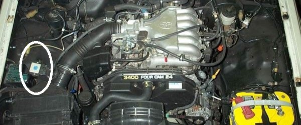

    Hi guys, i have a 2002 Toyota tacoma 4wd 6cyl and apparently my igniter or "electronic ignition igniter" is bad. Can anyone please show me a video or diagram on where to locate it??
    Ive been searching and cant find much on this part online. All i know is the shop wants to charge me $600 for one

    That's way to much. I believe I have a used one. I'll check. Its located by the air cleaner mounted to a bracket on the fender well.

    You are great help!!
    I couldn’t find anything on a ignition igniter for the life of me.

    4runner 3.4v6 ones will work also.
