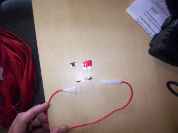

    Fuses and Fusible Links:
    A fuse is a device designed to melt or "blow" at its rated current. Fuses are not designed to protect some end device (e.g. lamp, stereo, etc) but rather the wires within the vehicle to prevent a fire. Your device may be fried, but your truck didn't burn to the ground.
    WARNING: A blown fuse is typically a signal something is wrong...don't just replace the fuse and assume everything is ok.
    The pic below shows 3 types of fuses typically used in vehicle applications. The top two are blade type fuses: top left is a low-profile mini fuse designated as ATM or APM, and the top right is a regular type, designated ATO, ATC or APR. The third type is a barrel fuse with an in-line holder.

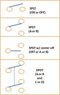

    We all know what a switch is, but maybe not the construction. The image below illustrates the difference between a SPST and a DPDT. A "pole" is a connection and a "throw" is the number of connections made within the switch. For example, a Sing-pole-single-throw (SPST) is the simplest on/off switch...it connects a single input pole to a single output pole via a single throw. Taking it a step further, a single-pole-double-throw (SPDT) is an "either or" switch. The single input pole can be thrown in two directions. (Note: you may realize that a SPST is a SPDT switch with one output lug disconnected). Lastly, a double-pole-double-throw is basically 2 independent SPDT switches contained in the same package. There are two independent input poles that each have their own throw to an independent output. These are useful if you want to turn on multiple device using different power supplies via the same switch.
    WARNING: If you plan to run any significant current through the switch, make certain it is capable of handling that current. Unfortuntely, most switches are rated for Alternating Current (AC), not Direct Current (DC) which is what vehicles use for power. You should look for a switch specifically rated for DC current because an AC rating is NOT the same as its DC rating. For example, a switch rated for 10A at 120VAC does NOT mean it can handle 10A at 12VDC. This is because when you abruptly open the contacts of a switch while there is high current flowing, an arc (like lightning or a static electricity shock) is formed inside the switch which will eventually over time melt the contacts of the switch, either destroying it or maybe causing a fire. Unlike DC, AC voltage is a sine wave, so when it naturally crosses 0V, it naturally helps to shut off the voltage before an arc is formed...DC voltage on the other hand will continue to try to maintain its contact resulting in an arc.
    Therefore, due to heat, fire, and the possibility of electrical shock, running high current through a switch is undesirable. Also, high current switches rated for DC current are hard to come by, expensive, and come in a limited variety of styles. Enter...the relay...

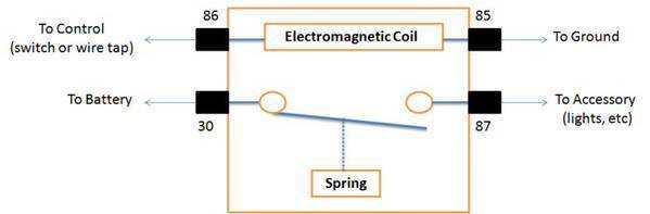

    Relay:

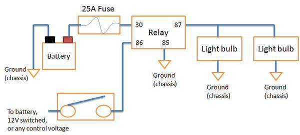

    A relay is a type of automatic switch. It is designed to handle the high current while allowing the user to switch it on without fear of electrical shock or fire due to high current at the switch panel. It works by energizing an electromagnet that pulls the switch throw arm, thereby connecting the input(s) to the output(s). When the electromagnetic coil is deenergized, the internal spring pulls the throw arm back open. This relay is a "normally open" relay...you can get relays that are the opposite and are called "normally closed". Relays are typically available in similar configurations to switches (e.g. SPST, DPDT, etc). Also, some relays have an internal diode (I won't explain why), so you may have to swap the coil wires if it doesn't work...read your wiring diagram.
    Note: the control wire and switch can now be of a lower current rating because the relay now handles the high current, freeing you to use just about any style of switch.
    WARNING: Relays are also rated for max current capacity...make sure you get one that can handle your application.

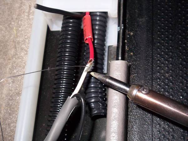

    Soldering
    Soldering and heat shrink is the best. It is a simpler task to learn than you may think and provides a safer and cleaner connection than any splicing option. For the beginner, you can get a decent soldering iron from Radio Shack for $10. Irons rated at 15W are meant for integrated circuit chips, transistors, capacitors, etc. and won't get hot enough to solder thick wires, therefore I recommend something on the order of 30W-55W. I prefer soldering irons to soldering guns because they are great for meticulous work.
    Check out http://www.tacomaworld.com/forum/technical-chat/103933-soldering-101-a.html for an excellent how-to. Also, see post #28 from Trap which contains great info regarding rosin/flux, which may be helpful particularly for the novice. Practice on some scrap wire to get use to it, here's a brief pictorial demonstrating a good solder joint:
    There are numerous ways to initially connect the wires...you can twist them together or use a hook method as I've done here. Notice the piece of red heat shrink tubing (be sure to put it on before you connect the wires), be sure to keep it away from the soldering heat or else it may begin to shrink prematurely.

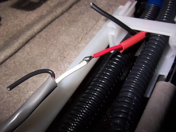

    Use the soldering iron to heat the wires, not the solder! Add solder to the heated material until it begins to melt and connect to the wires. Continue adding solder until the entire connection is covered...the solder should flow into all the threads and crevices of the connection. Be careful not to touch the iron to the wire insulation or it will melt it. Also, try to solder quickly so that you don't heat up the wire too much...sometimes if it gets too hot it can melt back the insulation or, if it is thin wire, can actually melt the wire itself. If it gets too hot and you aren't done adding solder, stop for a bit to let it cool, then begin again by warming up the existing solder until it turns to a liquid, and begin adding more solder until you're satisfied. Your iron is most efficient when it is kept clean: keep a wet sponge nearby to clean the tip in between solder applications. Also, if your iron is new, be sure to use some rosin paste and pre-tin the tip (coat the iron tip by melting some soldering directly to it) before you start soldering your project.

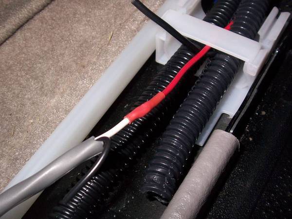

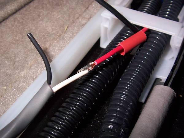

    Here's the finished solder joint. Don't glob a ton of solder on the connection, but use enough so that it is a strong connection evident by the flow of the solder into all the crevices. You shouldn't be able to see any of the raw metal, but you should be able to make out the individual wires and the basic shape of the connection. Also, the connection should have a shiny luster, not a dull grey, if it is, just briefly reflow the solder (touch the iron to the solder until it all "flows" and looks like liquid, then simply remove the heat and let it recool).
    Slide the heat shrink over the joint, gently heat it with a heat gun or cigarette lighter...and you're done. Don't overheat it or you could split it and expose the bare connection. Also, I typically use two layers of heat shrink to ensure a safe connection in harsh environments.

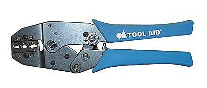

    Crimping

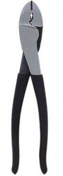

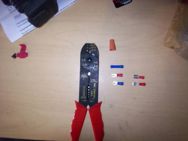

    Crimp connectors are the next option. The pic below shows a cheap crimp tool with some various connector types. This crimper is fine for the occasional crimp, but if you plan to do a lot of crimping, get a quality tool such as the one in the second pic below.
    At the very top is an electrical wire nut which is designed to twist 2 or more bare wires together in a temporary connection. I do not recommend these for permanent connections. The next one is an in-line connector...insert a stripped piece of wire into each end and crimp each end to secure the connection. Note that there is a standard color coding that fits certain wire sizes. If you're still unsure, there are other connection options available from auto parts stores like the one found here: http://www.posi-lock.com/posilock.html.
    Although the crimper in the pic above is suitable for the occasional crimp, the crimper style below is of slightly higher quality and can typically be purchased for under $10, and are well worth it!!
    This represents a higher quality or specialty crimper...this is unnecessary for the occasional or novice crimper.
    WARNING: Soldering and heat shrink tubing is always the best and safest connection, particularly in a harsh environment, but crimp connectors are ok for the novice. Even if using crimp connectors, I typically use heat shrink tubing around the crimp to ensure a clean/safe connection. I also like to zip tie the connecting wires together for strain relief. Electrical tape is over rated and I do not suggest using it for any connection. Wire nuts should not be used for any permanent connection.

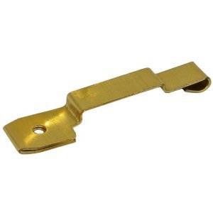

    One way to power a new accessory is via a fuse tap. This expands a singular existing fuse location into 2 locations. Be careful when using these because the wire coming from the battery to the exisiting fuse must be able to handle the additional current of the added circuit.
    This tap allows you to add a fuse for your new circuit.
    This tap uses the existing fuse and you can tap either the input or the output side of the fuse. The hook on the right side loops around one of the fuse lugs allowing the lug on the left to be attached to a crimp connector.
    WARNING: If you use the input side, be sure to fuse your added circuit properly. If you chose to use the existing fuse to handle your added circuit, take care not to overload the existing the fuse.

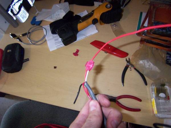

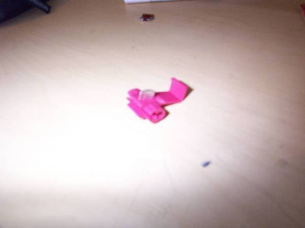

    Wire Tap/splice:
    These devices are great if you want to tap a stock wire and you don't want to cut it. For example, if you want your fog lights to turn on when your parking lights do, use a splice on the parking light bulb's wire. These are great because you can easily locate the right wire and tap it without cutting wires (improperly modifying your electrical system is a quick way to void your warranty). Another example is if you want running lights to turn on when you open the door...simply splice into the courtesy light wires (see my build).
    Note: these are color coded as well for the wire gauge they are meant to splice.
    WARNING: They are not water proof, so beware. Also, they expose the bare wire when removed, so I recommend not removing them, or repair the wire using tape or liquid tape.

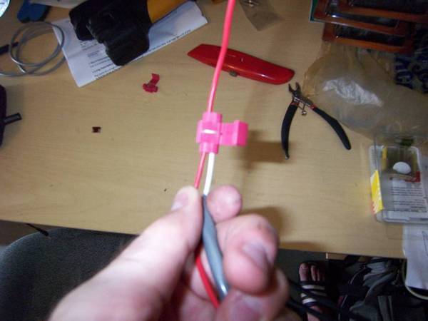

    Here's what it looks like:
    In this pic, the red wire represents the existing stock wire. The white wire is the one I want to tap into the red wire. Next, push down on the metal piece which will cut into the red and white wires, connecting them.[​IMG]
    Now close the plastic lock over the metal piece to secure it...you're done. Now zip tie the wires for strain relief.

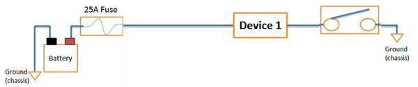

    Basic Circuit Design
    I also see a lot of questions on how to wire lights or some new accessory. Here I will take you through the step-by-step design of a simple circuit. Included is a discussion regarding component and wire selection.
    WARNING: I am not designing a circuit for you, but rather showing you the steps you should take to put a circuit together...or it can be used to understand how a pre-wired circuit is wired. You should take this generic circuit and modify it for your specific application...specifically, you should consider things such as current draw, wire location (e.g. heat, scraping, shorting, etc), wire length (effects chosen gauge), fuse size, etc.

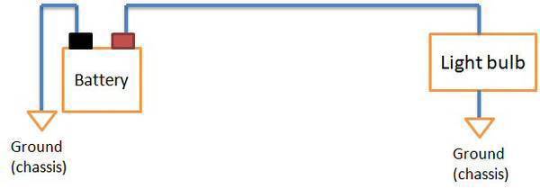

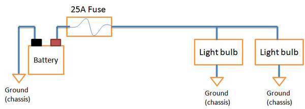

    We'll start with the simplest building block and we'll build from there. I'll use a light bulb as an example.
    So how do you know what wire gauge and fuse to use? You need to figure out the maximum current your accessory will draw. However, lights (for example) are rated in Watts not Amps...so here's how to calculate current draw from wattage...

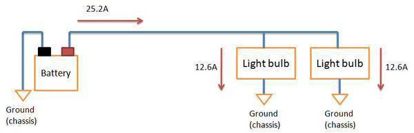

    Let's assume that this light bulb is a 130W bulb. Recall the two formulas P=VI and V=IR. The power rating of the bulb (130W) is in reference to its operating voltage (12V). Therefore, from P=VI...130=12*I, solving for I=10.8 Amps. Now, using this new information, plug it into Ohms law (V=IR) to determine the resistance of the light bulb.... 12=10.8*R, solving for R=1.11 ohms. For simplicity, it is reasonable to assume that the bulb's resistance doesn't change.
    Now we're interested in knowing the worst-case scenario for the current draw. This is important because as we all know, the battery voltage fluctuates as it gets old or charges/discharges. Assume that the battery could be anywhere between 8 volts and 14 volts. Therefore, using ohm's law (V=IR)... 8=I*1.11, solving for I=7.2 A. Now do the same for 14V... 14=I*1.11, solving for I=12.6A.
    Therefore, one 130W bulb draws anywhere from 7.2A to 12.6A depending on the state of your battery voltage. Since you typically have two bulbs, and each bulb draws 12.6A, the total draw of both bulbs on the battery is 25.2A (12.6+12.6=25.2). Therefore, we must select all components sufficient enough to handle this load.
    Here's the updated diagram with the maximum current draws indicated.
    Referring to the wire section of this post (assuming a conservatively low-efficiency insulation), 14 gauge wire would be sufficient for each light because it can handle 15A. However, the wire coming from the battery has to carry a total of 25A, therefore 10 gauge wire is the minimum. If you're on the edge or not sure, it's always a good idea to go one gauge up to provide some overhead. Don't forget that the wire going to ground from each light has to be as big as its power wire because the same amount of current has to continue through the bulb to ground.
    Note: as discussed in the wiring section of this post, these are conservative ampacities and can be improved upon depending on the heat dissipation rating of the wire you choose. This is why pre-wired lighting kits use more reasonably sized wire.
    Next, we'll need to add a fuse. As previously mentioned, the fuse is meant to protect the wires from burning up and starting a fire. The fuse capacity should be selected so that it burns up ("blows") before the wire burns up, but capable of handling the typical current load for long periods of time. A good rule of thumb is to select a fuse that is 10% below the wire's ampacity. For example, since we've selected a 10 gauge wire that can handle 30A, the fuse should be 10% below that...30A-(30*10%)=27A fuse. The closest standard fuse to this is 25A. However, remember that we could potentially see a 25.2A max draw if the car battery is up around 14V, but since this is highly unlikely, selecting a fuse at 25A is better than picking a 30A fuse that doesn't blow before the wire.
    WARNING: always physically place a fuse as close to the battery as possible. This is because if you have a few feet of wire in between the battery and the fuse, a short could occur in the unprotected length of wire resulting in a possible fire.
    WARNING: try to use the same gauge wire throughout your circuit to ensure proper fusing. Always choose your fuse to coincide with the smallest/weakest wire in the circuit. Similarly, if you add a circuit or need to repair some wire, always go equal or bigger in size.
    Next, we'll want to add a switch. You could simply insert a switch in between the fuse and the lights...simply find a switch that is rated at for at least 25A at 12VDC. However, as discussed earlier, it is undesirable for safety reasons to have high current run into the cab and to the switch panel. Instead, the switch should power a relay....again, the relay in this example should also be rated to handle at least 25A. Also note that if you wire the switch directly to the battery, you should also add a fuse for the switch and wires. However, if you're tapping off a factory wire, the factory fuse should provide sufficient protection assuming you use a reasonable wire size for the factory fuse.
    Here's the end result:

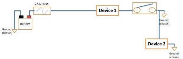

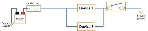

    Tacoma Specific Info - Tapping Ground Activated Circuits
    Many systems use a ground activated circuit. These circuits are extremely common on vehicles and can result in wacky stuff if you aren't careful when tapping into the stock wiring (for example, you turn on an aftermarket device and it turns off your CD player or turns on a dash light) and this thread would be incomplete without mentioning these types of circuits. You should refer to a Haynes manual or the manufacturers wiring diagrams that are available on this site.
    Here is an example of a ground activated circuit. Instead of the switch controlling the power going to the device, it instead controls whether or not the device has a ground. I don't recommend this when designing your own circuit, but you need to understand it when dealing with the factory wiring.

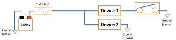

    Now, suppose that you want your aftermarket device to operate with a stock device. Most people would assume that the power wire is switched and may wire as seen below. The problem here is that Device 2 will be on all the time. Now lets say you turn on Device 1...if it has a lower resistance than Device 2, electricity will bypass Device 2 all together and it will shut off. The opposite is true too...if Device 2 has a lower resistance, than Device 1 may never turn on. This is true even if you install a switch on the positive side of Device 2.

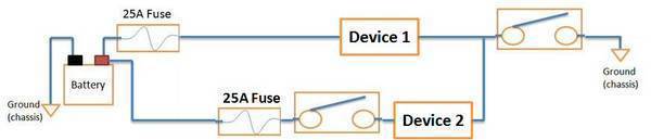

    The problem in the diagram below is that Device 1 and Device 2 will be on all the time and will not respond to the stock switch (Device 2 is acting as a bypass). If you placed a switch on the positive side of Device 2, it would turn on both Device 1 and 2...but turning on the stock switch would then bypass Device 2 and only Device 1 would be on.

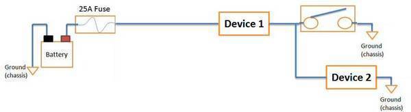

    In the diagram below, Device 2 will never turn on because electricity takes the shortest path to ground. Device 2 is basically tapped off ground.

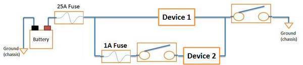

    So how do you do it properly??
    It should become apparant that there is a myriad of ways to mess this up and you won't know what's happening unless you have a factory wiring diagram. You could even do permanent damage to your wiring and devices if you're not careful. Once you've obtained a wiring diagram and realize your dealing with a negative activated circuit, here's how to do it properly.
    Note: you could place a switch on the positive side of Device 2 if you want the option to turn it off even if Device 1 is on. You should also insert a fuse if the wires of Device 2 are smaller or in a harsh environment (see below).
    This is the exact circuit diagram for my running board lights (see link in my signature)...I wanted the running board lights to turn on when the dome light comes on (e.g. when the door is opened or doors unlocked). Therefore, Device 1 is the dome light and Device 2 are the running board lights. Since the running board lights are outside the cab and use smaller wires, I wanted to specifically isolate the factory wiring from my aftermarket wiring...also, in the event of a short, the smaller wires of the running board lights would burn up before the factory 7.5A fuse for the dome light, so the 1A fuse specifically protects the aftermarket wiring.
    Note: you could provide its own power wire and fuse, just ensure the ground wire can still handle the added load...see more below...
    WARNING: If the factory wiring and fuse can't handle Device 2, don't assume you can run an independent power wire and fuse while still using the factory ground. The ground wire has to handle the load too!! (see below) In this diagram, the ground switch and wires have to handle 50A!!
    (***This is incorrect and could result in a fire***)

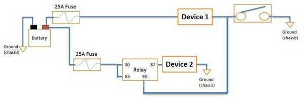

    Therefore, just like before, you need a relay to provide the high power. A relay can be operated using a negative activated circuit via the diagram below. Basically the relay has power, but the coil's ground is floating and is therefore not activated until the stock switch provides the ground. Therefore, the low power coil can be safetly activated via the stock wiring but the high power wires are provided by you.
    **WARNING: This is a theoretical solution because I've never actually done it before. Again, I'm providing ideas and take no responsibility for your actions!! I recommend you prototype this idea before actually attempting it. When in doubt, get help or wire your circuit independent of the factory wiring**

    Heat-shrink tubing: Always remember to slide it onto one of the wires BEFORE you solder the splice.
    Wire type: Look for "automotive" or "oil an gas resistant" wire.
    Wire gauge: Try not to approach the 'maximum rating' of any wire if it will not be in open air. If it is bundled with other wires, or under insulation or carpet, it may reduce the capacity of the wire depending on how it was rated.
    Crimp connectors and wire taps: Avoid these when possible. Definitely avoid these in areas where moisture and contamination are likely, such as under the hood. Corrosion of the joint is likely. If it can't be avoided, weatherproof the joint with shrink tubing, self-fusing tape, or liquid electrical tape (sealant).
