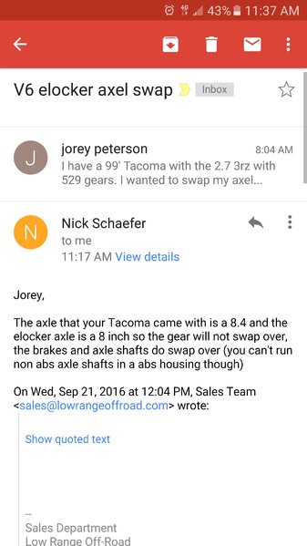

    This was the reply from one of guys at low range.

    Maybe there's something I'm missing. But I'm pretty sure the ARB locker option on the market for the first gen tacoma fits the 8.4" rear end...
    What he's saying about not being able to run non abs axles in an abs housing is true, for reasons that I won't bother explaining because it's not important to your question. But if you're getting a whole axle assembly from a junk yard you can just run whatever axles come with it and that won't be an issue.
