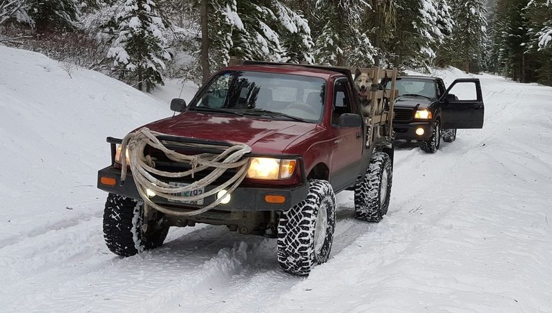

    Here's the bigger side by side :)

    Sweet lookin rig up front :thumbsup:

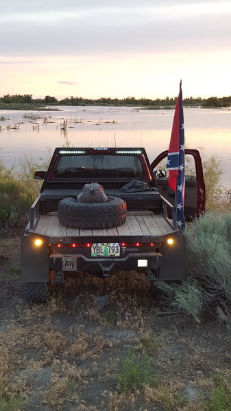

    Thanks man! Appreciate it. I think it's getting there, slowly but surely it'll be a bad ass yota one day lol. Here's a booty pic too...
