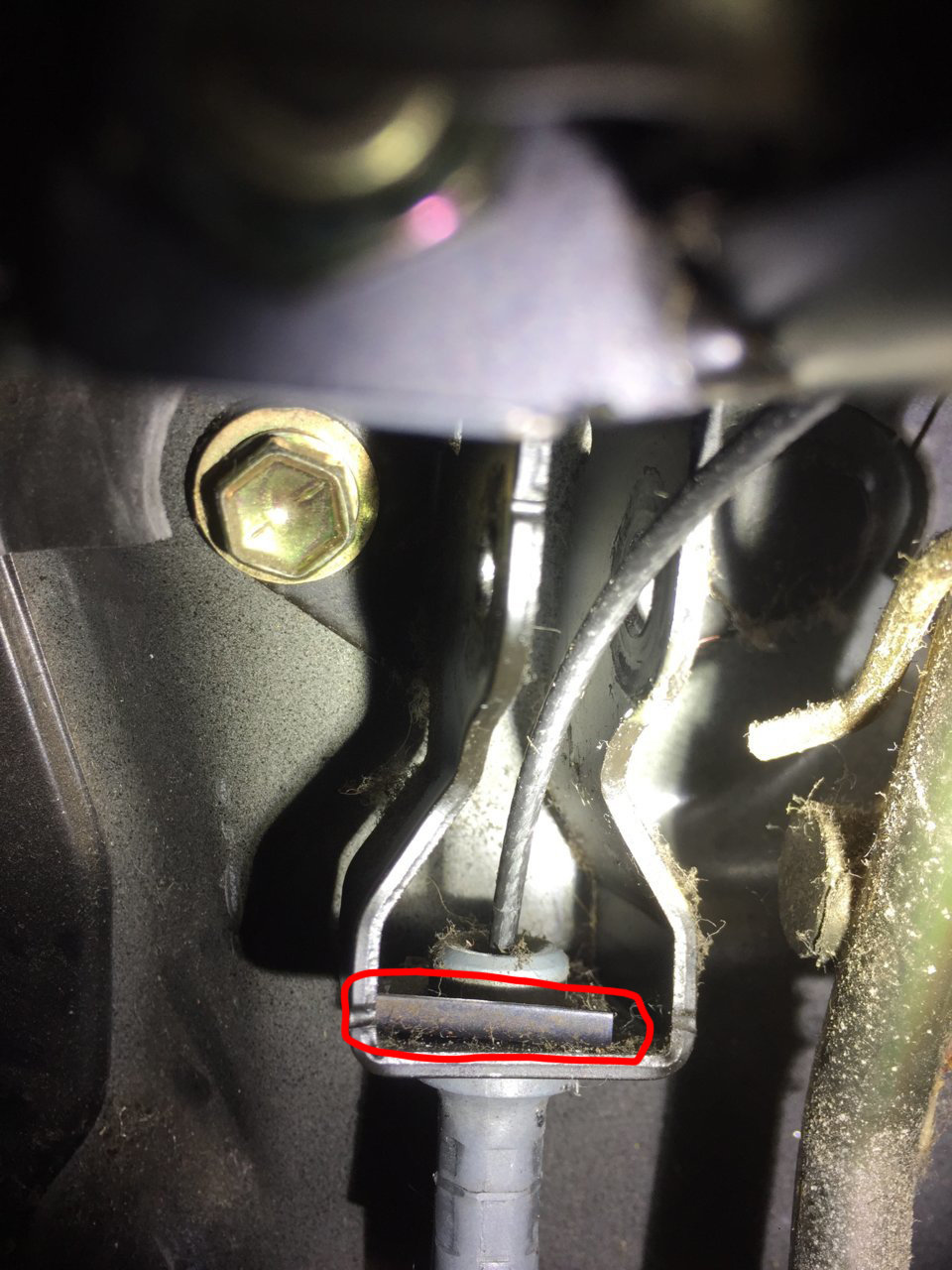

    Cool. All the other instructions were great here, I was able to disconnect it from the handle and everything. It’s just getting it out of that square mount. I did a general search of brake cable replacement in here but didn’t see much other than this thread. Will check YouTube. Thanks!

    Pull this part out. It slides out toward you.

    Got the cable out and changed; I have a parking brake again! Additional shoutout to A&D Autowerks if you're in the San Diego area, they helped me get a seized pin unstuck. Thanks for all the help, TW, you guys are awesome.

    After trying to fight the cable end back into the shaft through the groove for about an hour or so,this thread has informed me of the 2 things on top of the shaft to get that extra space to reinsert it.
    I was able to take the old cable out without doing this before hand. Such a pain in the ass
