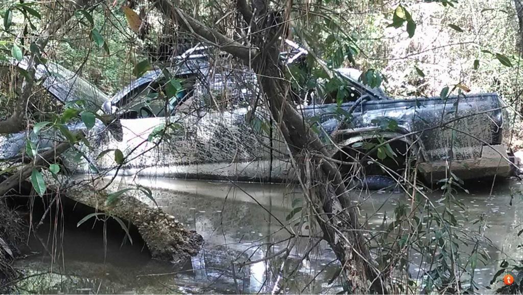

    Here is what happened:
    Last Sunday I put my 2009 V6 Tacoma in 4 feet of water. Flooded the interior up to the top of the seat cushions and up to the lower-most portion of the intake. I was able to prevent any hydrolock by pulling the spark plugs and purging the water that got sucking into the cylinders. I also disconnected the exhaust from the Y-pipe and Y-pipe from the headers to purge the water that was in them. Since we could not start it Sunday, we left it on the trail overnight with no luck starting it today (Monday). I decided to strip the interior of all valuables and leave the doors and hood open to allow it to dry overnight and most of tomorrow. Luckily it is in a fairly hard to reach location that all these Florida guys probably wouldn't be able to reach, let alone take anything from it. If it doesn't start tomorrow we will winch it out, tow it home, and let it dry out more in my driveway.
    The facts:
    1. The spark plugs were tested on another vehicle to be working fine, but when tested on my truck, they weren't sparking.
    2. The spark plugs have constant power from the black wire but no noticeable voltage from any other wire while trying to start the motor.
    3. No fuses are blown that we were able to check. Can't really check the big fat ones...
    4. Several plugs located under the dash in the cab were submerged and still wet after one day.
    5. Since flooding, new alternator was installed.
    6. Since flooding, new ECU did not allow engine to start.
    7. No CELs are able to be read.
    8. No fuses are blown.
    Any advice, especially from those that have run into a similar issue, is very much appreciated.

    Here is a picture of it in the drink
    This is us purging the water from the cylinders

    From your pic, it looks like the passenger side was more deeply immersed. If so, hate to tell you, but you may be so screwed. The ECU sits on the passenger side kick panel, if it was immersed in the water, I suspect you are in for an ECU replacement.
