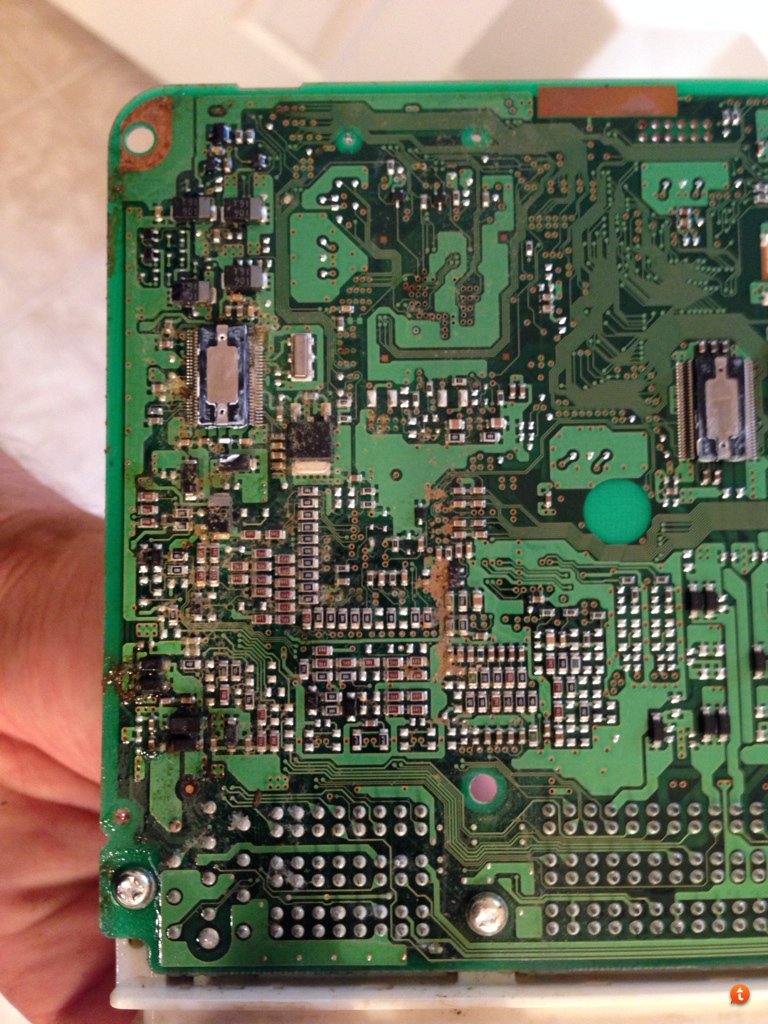

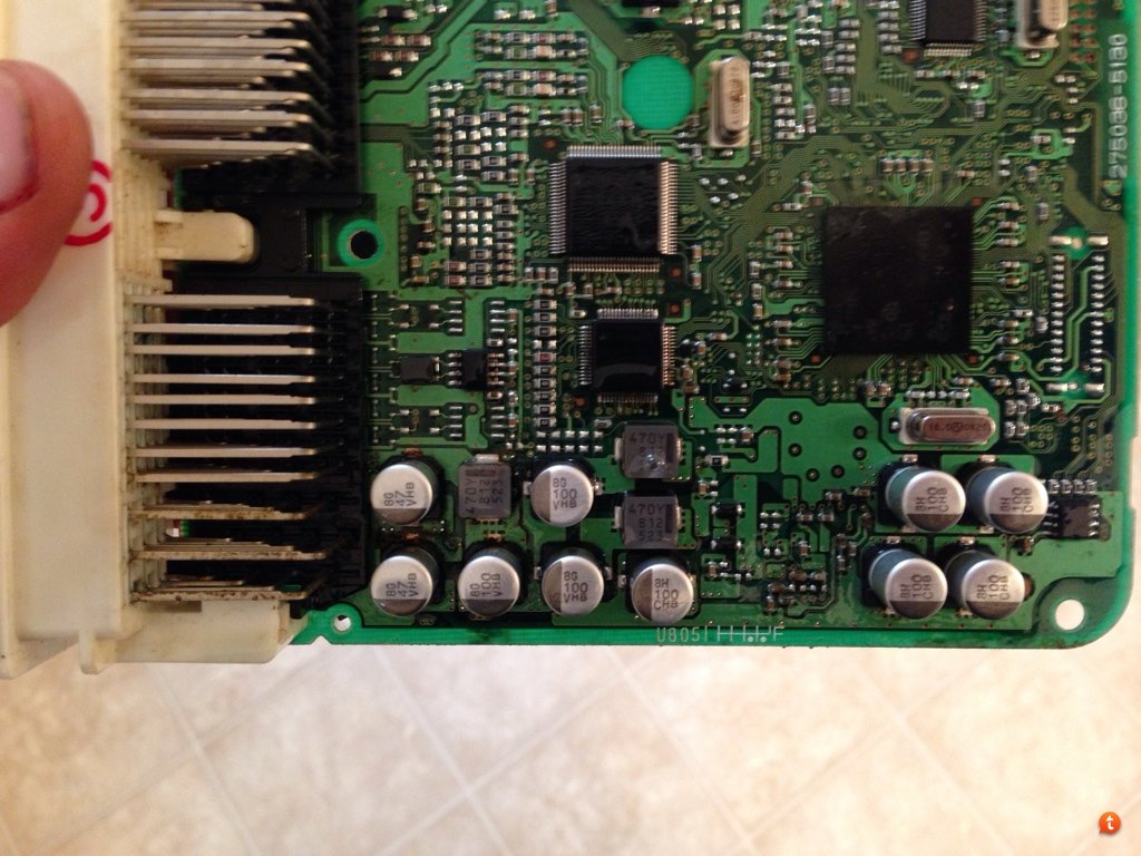

    Day 6:
    Pulled the ECU. Found some rust/corrosion. Cleaned off with alcohol and old toothbrush. Left to dry. Removed seats and carpet. Hosed down carpet and interior. Left carpet hanging in garage and truck doors open to dry overnight.
    Pics of ECU

    Wow nice find hopefully that is all it takes!
