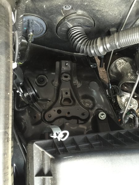

    2016 TRDOR DCLB tech & towing package. This is behind the air filter box and in front of the firewall. What is it designed to hold?

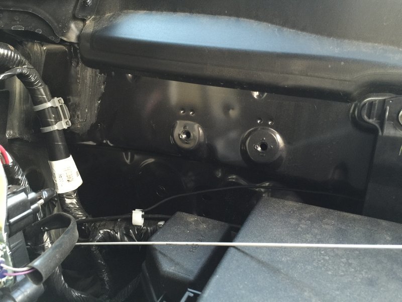

    No that's all on the drivers side. I've now noticed another set of mounting points on the inner fender on each side. image.jpg image.jpg

    Hmm. Maybe it's a mounting bracket for some California emissions components that your non-Cali vehicle doesn't have to have.

    The ones on the driver side fender are for the clutch hydraulic fluid reservoir on manual transmission trucks.

    Pretty sure there is an ABS block mounted there on the trucks without ATRAC. That block been giving the non-OR dual-battery guys fits.

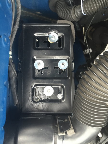

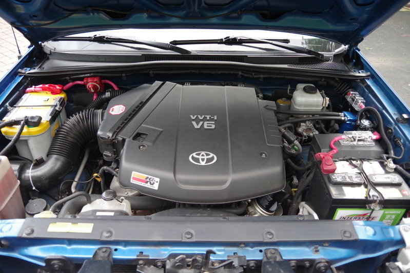

    I have the same space on my 2005 TRD OR.
    Added a 27F Battery Tray
    Now have my second battery for my dual battery setup.
    File IFR, EDDO, nevadabugle and 2 others like this.

    It's for mounting the ABS modulator. Off road models have it built into the master cylinder so the space is open.

    its for onboard air.....:)
