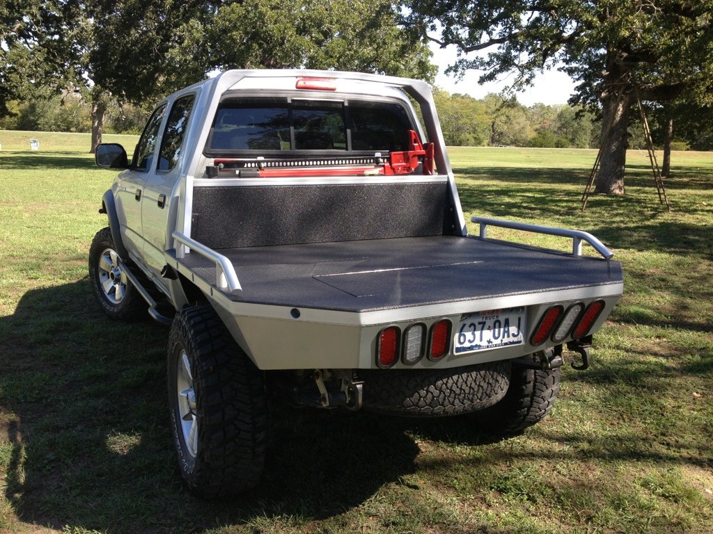

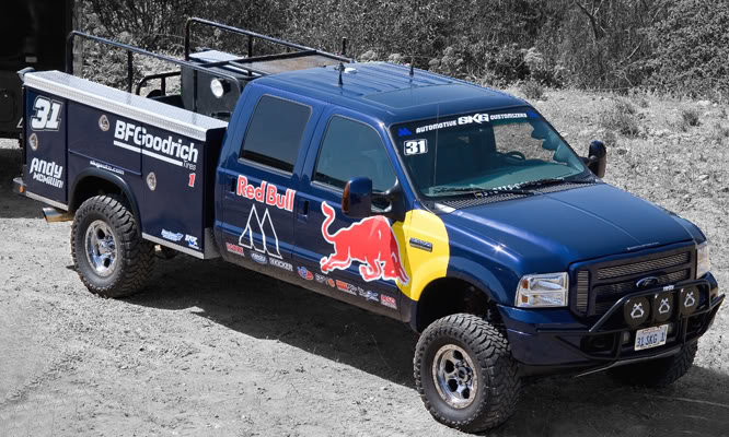

    I've always liked the look of badass offroad trucks with utility beds. You'll need all the storage for air, linens, meds, etc. Some custom storage designs for backboards and a stair chair could be pretty cool
    Obviously not a taco but it's a good example of the storage bed.
