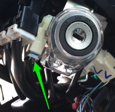

    how about trying this first...
    it will take you 5 minutes to test...
    remove steering wheel column lower trim, you dont even need to remove it, just lower it. there is a three (or two) wire plug on the bottom of the ignition tumbler. unplug it, and test. this plugs only job is to sense a key is inserted into the ignition for lock out protection and door buzzer. give it a try
  15. Nov 29, 2018 at 12:02 PM
    JEtaco03
    JEtaco03 Well-Known Member
    Jul 30, 2018
    #261048
    489
    Justin
    New Market, AL
    08 Tacoma TRD
    Lifted on 18s and tires, LEDs all around
    I'm sorry for reviving an old thread, but did unhooking the wires from the ignition work? I just got my taco a few months ago and its getting cold, so I would like to be able to securely warm the truck in the morning.
