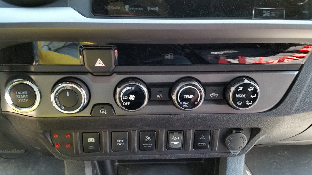

    There are several threads on doing this. I did find it a little confusing when researching doing this. I used this backup camera anytime harness a fellow makes. It lets you splice into the wiring without messing with the factory harness.
    https://www.anytimebackupcamera.com/product-page/camera-override-dongle-28-position-1
    I did the backup camera anytime and navigation anytime mod at the same time. The only thing I did differently is add a small 5 pin relay to the navigation anytime mod so the switch operates properly. I've been running the mods for several months and they work perfectly.

    It is the switch panel that comes in the trucks with the tech package. Mine came with the panel that only had three switches. So I ordered the part from Toyota (it wasn't cheap).
    There are several threads on that switch panel, I'll try to find them. It wasn't easy getting to it but I think it was worth it. I couldn't have done it without the help from the great folks here.
    I removed the Qi thingy switch which I found useless, and installed the switches for the rear camera anytime, navigation anytime, and a switch to activate the rear light strobe.
    The red lights on the left I installed as additional indicator lights, so I'll know if I have accidentally bumped on of my light switches.

    Ahhh, gotcha. Looks like all the surrounding panels have to come off before that center one can. Kind of a pain! I'll keep it in mind, I'm not exactly hurting for more switches, but I'll keep the spot in mind haha.
