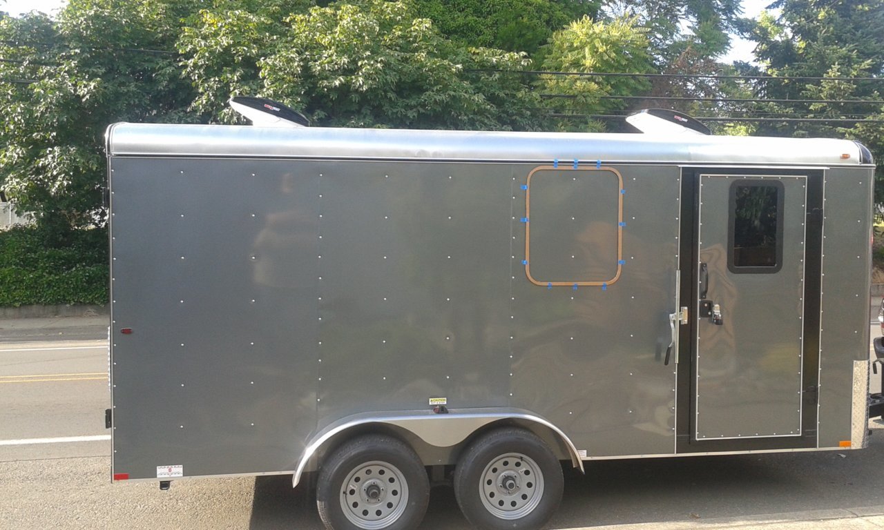

    I didnt get the one with the remote, but the MaxxFan is definately the way to go.

    Nice. You could do one set to intake and one to exhaust. I wasn’t going to do a fan or vent at all but once I started researching the Maxxfan had the best features overall. The reversible and the auto features were huge but the #1 feature I went for was the hood design that can be run in the rain.

    I also like the dual arms (no twisting of the lid when driving with it open or in the wind) and the lifetime warranty on the lid.
