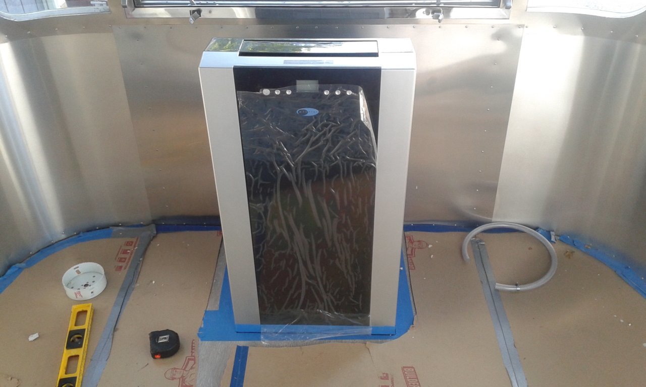

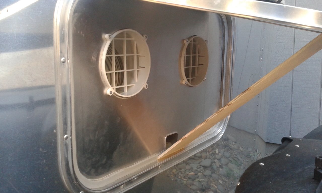

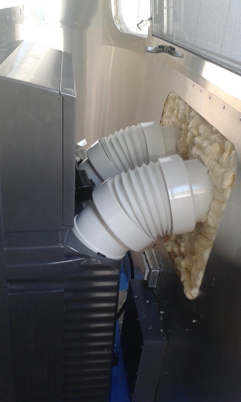

    I will chime in on the air conditioner portion. The reason the two tube is better is that the second tube draws outside air through the separated portion of the unit while single tube draws air from the room (any leaking seams or vents). This causes the single tube system to draw in outside heat.
    Note: there is a brand that uses a single tube that actually has the intake tube inside the exhaust tube.
    In the Airstream, I built in a Whynter ARC-14SH. They do require some time to get the room to temp if the room is hot, but work great to maintain temp if they are turned on before it gets hot.
    I used an access panel to allow the vents to be covered while parked and sealed while driving. A modified shop vac wet filter (black plastic spongy filter) works great as an intake filter to keep leaves and bugs out.
    It does require a drain as it sucks a lot of water out of the air.
    A Yamaha 3k barely notices the AC turn on or run.

    Edit: If you decide to get a "portable" ac, get one that has a heat pump built in. It is a nice feature.

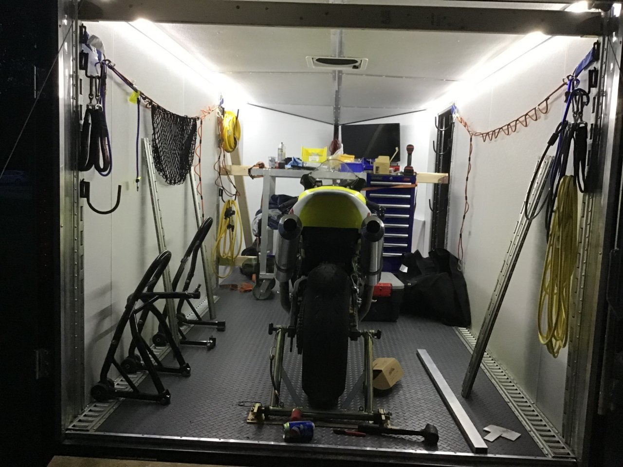

    Already have that sorted. Just didn’t make it into the pictures. In addition I have an aluminum platform I am working on that will be above the racebike for additional storage. Will hang off the e-track lumber connectors. There is a ton of wasted air space that can be utilized if you are creative and it doesn’t have to be a pain to install and remove at your destination.
