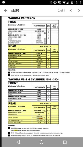

    I now see that OME offers bushings SB89(for stock shackles). @HeadStrong Off-Road is this for 2 shackles, reading (Pair)

    Crap OME SB89 Is for 1st gens...

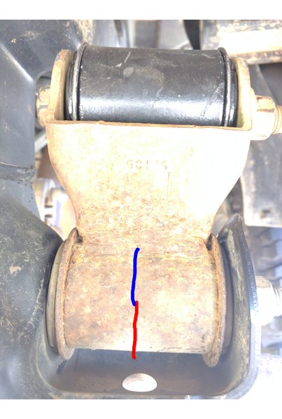

    Yes. I'm pretty sure my factory rubber bushing have a metal outer shell that's pressed into the shackle.
    In this not-so-good photo, you can see that the bushing shell is rusty colored compared to the rest of the shackle

    I wish I would've taken pics of mine when I removed the factory bushings. I have those flared edges on mine but they look to be one piece with the shackle. The inside of the shackle had a low half ring(blue) on one half and high half ring(red) around the other half, where it looked to be welded together. If there really is a sleeve in there I guess that's where the 2 halfs meet, and the one side was filled with crap?? I want to get my hands on another set to try and see if that comes out..
