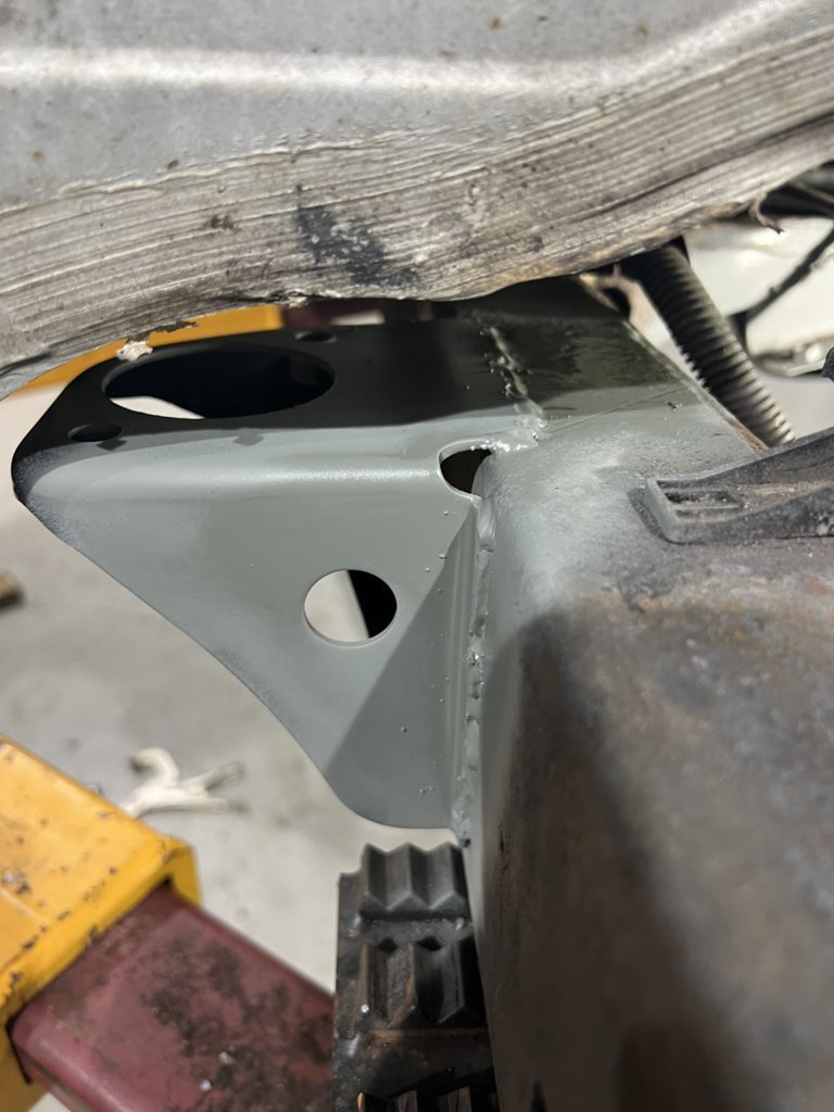

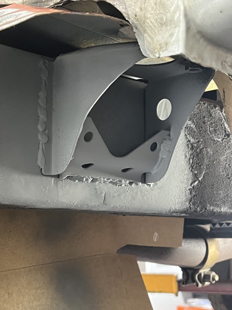

    It was just sort of rusted in the sleeve. I used Kroil and a hammer and a block of wood eventually knocked it loosed. I didn’t have the same problem for the driver-side Position 1 bolt. That one came right out. I wound up cutting off the Position 3 perch on the driver side and welded a new one in. It wasn’t as rusted through as the passenger Position 3 perch, but it was getting there. The only one remaining for me is the driver side Position 2. The perch is in good shape but the bushing plate bolt heads are completely rusted. I am going to have to cut those welded nuts out. Here are my new perches.

    Nice work on the new perches. My position 1 ones are slightly more bent than they should be, but I didn't realize parts were available to replace them.
