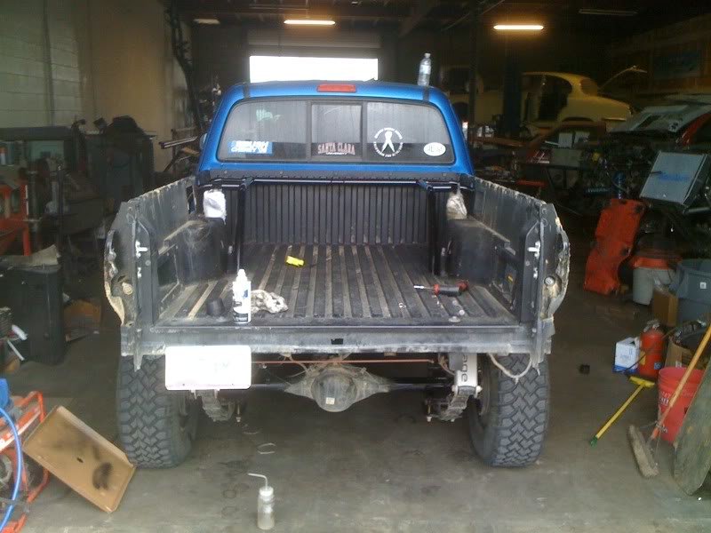

    I saw pictures of the 5ft bed saver cage but it had a boat load of things in it, do you guys have a picture of the bed saver cage without everything in the bed to really see the cage itself? Also do you have a set-up for the long bed?

    6 ft bed with nothing in the bed:
