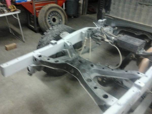

    can you get a few more pics towards the cab, did you do it yourself or did engage weld it up for you, what thickness material 3/8,1/8,3/16???? Im thinking about driving up there and buying this. Seems like engage is the only shop that has any sort of "kit" to box our frames. Its definately not hard to make a template and cut out the material myself but im just a lazy SOB :eek:

    Sorry but i cant take my bed off for pictures due to my cage:cool: and i didn't take any ones of that area when i did it.
    Basically it goes up to the cab and just has notches for brakelines and whatnot were needed. I'd say 1/8" idk but its thicker than the damn frame itself so its worth it. My cousin and i welded it up.
