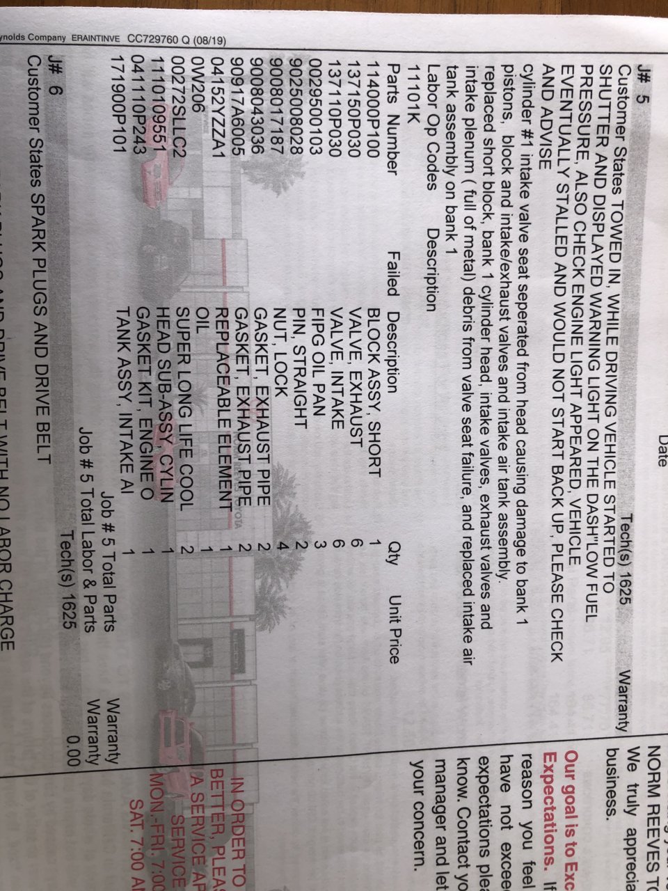

    Here's what I got. I don't think I ever got much more via conversation, it's more of a 'we sent diagnostics to Toyota and this is what they said to do' kind of a thing

    Ohhhhh.... the valve seat came loose and dropped into your #1 cylinder. So they ended up replacing the engine short block (the block, pistons, rods, crank, etc as a single unit). Along with 6(?) each intake and exhaust valves.
    edit: oh... they did all the valves on one bank (side) of the engine. 2 intake and 2 exhaust valves for each of the 3 cylinders.
    Considering the entire short block was replaced, that's some fairly major surgery... guessing the mechanic forgot a step which caused the 2nd failure. More than likely, the second failure was just human error. Hopefully they'll get it right the next time around.

    Have they diagnosed the current engine?
    Something doesn’t sound right.
    I noticed they didn’t have spark plugs, but did have “customer states - spark plugs,
    I don’t know of any shop that wouldn’t replace the spark plugs after a situation like this.
    Anyways, I’d like to see the current diag on the new engine.

    Yeah they sold me on replacing the spark plugs with no labor cost while the work was being done. I haven't heard back from them yet on the most recent service issue, I'll keep ya posted.

    That first attempt was pitiful, even some amateurs know better. What is really odd is that in most mid to large dealerships, a factory field tech will usually diagnose and has to approve warranty repairs. They also request a fuel sample as standard MO and I don’t see it on the RO.
    So if I’m not misunderstanding, this will be the 3rd attempt?
    You can try lemon, but you rarely come out whole, the law is a sham and waste of time for the consumer. To trade in would be a loss if they finally get it right.
    I would wait and see how it runs and if it looks like they did a good professional repair. A good pro will leave no trace that the vehicle has been worked on to the untrained eye. If you see wires hanging and tape rolling off harness, greasy prints everywhere, trade it while its still running.

    Second failure 100% on the mechanic. They should have put a long block in originally.
