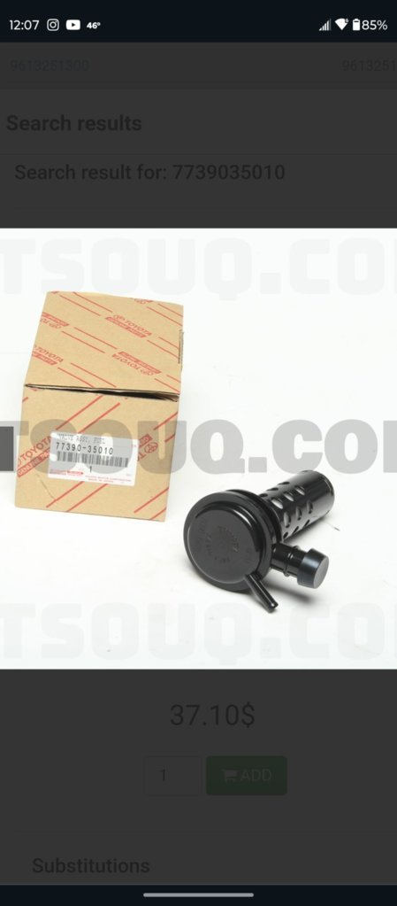

    So you're on the right track. It's going to be one of 4 items: Gas cap, filler neck, charcoal cannister, or fuel tank check valve. I'd start with a new gas cap, since it's much cheaper and easier than the other 3 items, then go from there.
    I had the same problem, and couldn't add more than a couple gallons of gas at a time last year. Ended up replacing both the charcoal cannister (very pricey), and fuel tank check valve. I believe it was the charcoal cannister that was the problem, but cannot confirm, as I replaced both at the same time.

  7. Mar 19, 2025 at 9:53 AM
