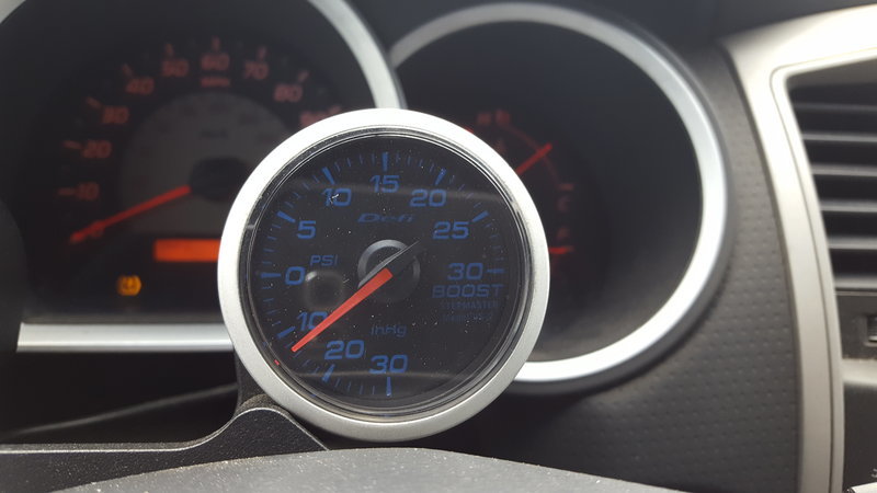

    No A/C, idling. Cams cause my engine to pull less vacuum at idle. Thus showing a "higher" load. Without cams, it reads between 18 - 21 in/Hg.
