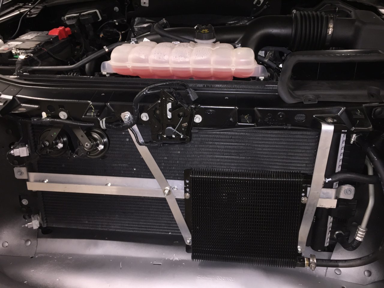

    I have a '13 Prerunner, no tow package. I am having the trans cooler installed as we speak, it is the B&M supercooler. I just purchased a 3900lb trailer, not counting gear. How important is an engine oil cooler like the tow package equipped Tacoma's come with?

    engine oil cooler ? do you mean automatic transmission fluid cooler instead ?
    because that is what we get,
    an additional atf cooler, not an 'oil cooler'
    (though it's the same damn thing really,
    a finned heat exchanger)
    yes it is important to keep atf fluid as cool as possible for longevity, and towing anything makes that temp climb
    an additional atf cooler can only do good when installed correctly
    and the atf volume compensated for the added space the lines and cooler make
    if you have a manual tranny then just change the goop on the 'extreme service interval' in the owner manual

    The trans cooler is being installed today, which I put in my post. 2nd gen Tacoma's have a factory oil cooler installed with the tow package, along with the trans, alternator and battery upgrades.

    that's what comes with the tow package and is much better than the external trans cooler types that can over cool oil if not done right
    you can upgrade your Alt and Battery too if you want to match the tow package

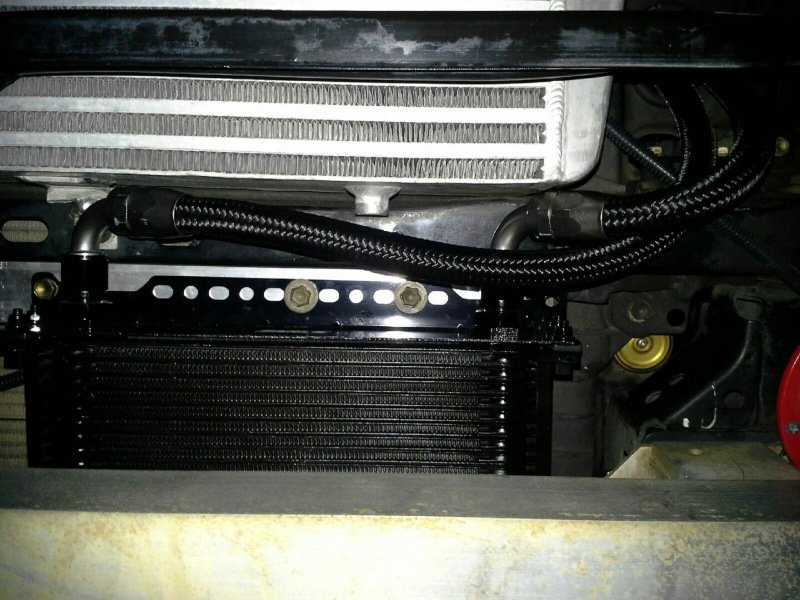

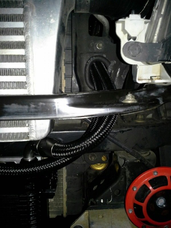

    It works, but taxes the cooling system. Since coolant is used to take heat out of the oil. Just the nature of its design. Being that the ATF also uses the coolant system to cool the ATF, it gets taxed even more.
    Here are two options.
    CSF larger radiator, with larger reservoir for cooling the ATF:
    https://www.tacomaworld.com/threads...mance-radiator-for-our-trucks-finally.539151/
    Air to air oil cooler:
    20131027_191412_zpsf95a92fd.jpg 20131027_191435_zpsee70ce4f.jpg 20131027_180335_zps619535b7.jpg

    Where can I find the right sandwich plate for an air to air cooler for taco? And the adapter to support our oil filter too like in that image? I checked the mishimoto oil cooler sandwich plate, but I am not so sure if we have enough room to fit that one. I am looking for an oil cooler sandwich plate for taco that has atleast two NPT ports one for oil temp and another for oil pressure gauges. Thank you.
    Edit : Also want to add that the stock taco comes with this weird contraption, but I don't see an air-to-air cooler there.

    That in my pictures is a Greddy oil cooler sandwich plate.
