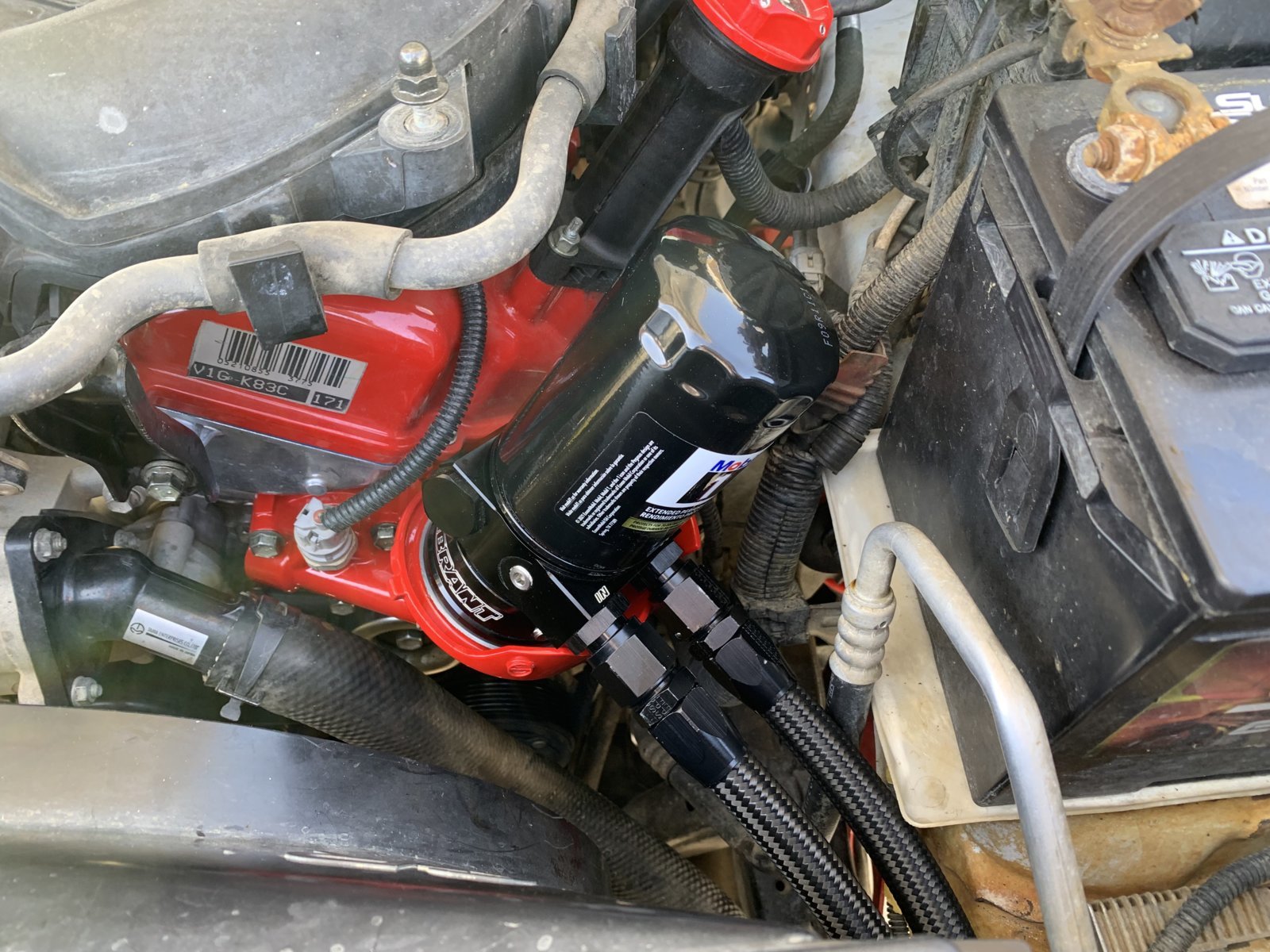

    Do you by chance know whether adding an external oil to oil cooler would add additional stress/strain to the engine to push oil through the system which is not designed for it?

    It won't.

    Greddy sales team just replied :
    "Unfortunately we do not offer anything for your truck. We do have a good amount of oil cooler core universal kits. We also carry the Toyota thread pitch to run the sandwich plate adapter. You'd just need to custom make the hose."
    I'm a little confused. I was only asking which sandwich plate adapter would be compatible so I could buy.

    I spent less than 15 seconds searching their website to find the piece you want. Which matches the one in my photo.
    The thread pitch is 3/4x16UNF.
    So what confuses you?

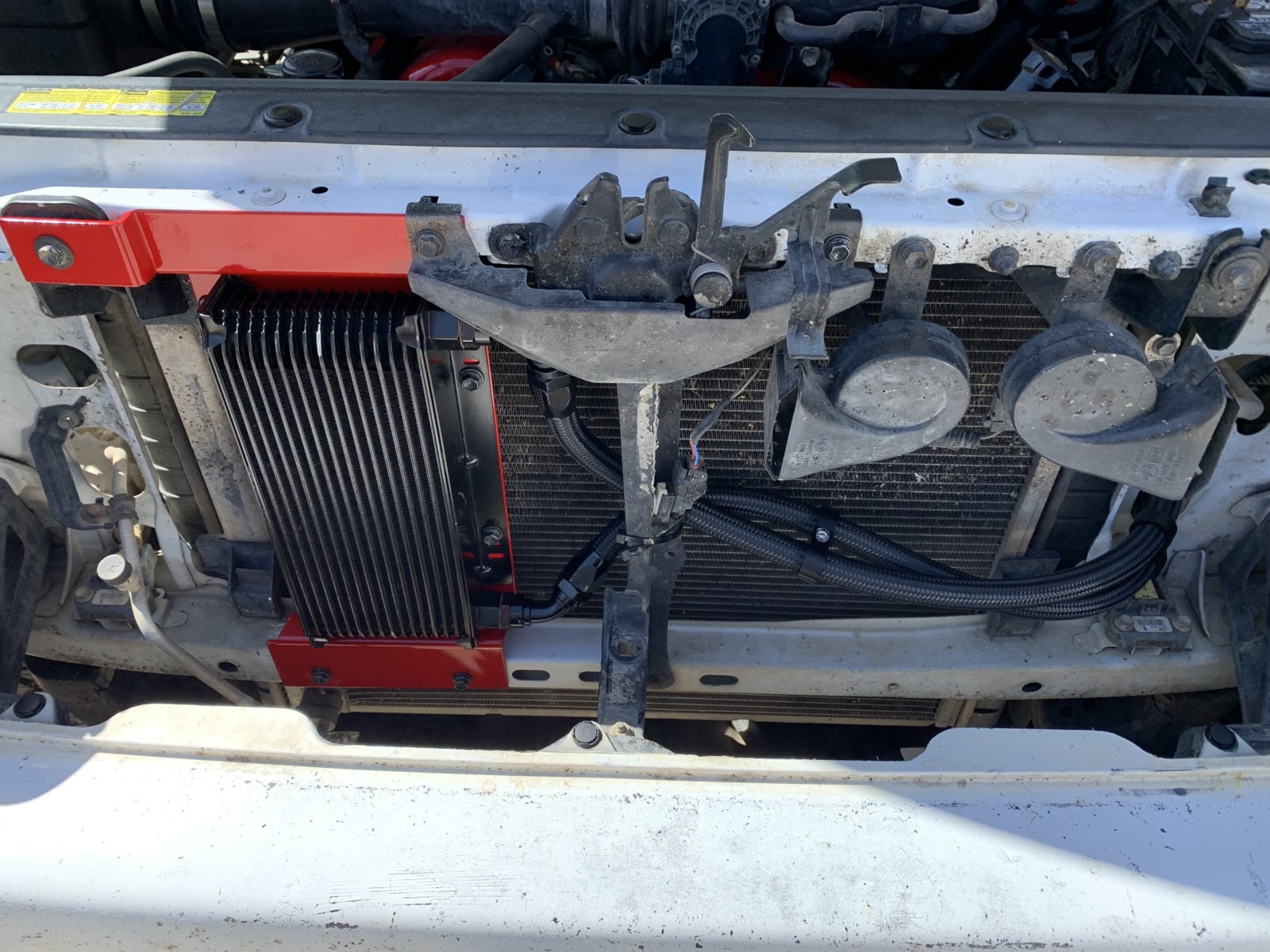

    Torspd, thank you for the basis of the idea.

    What's the vibrant oil adapter part number?

    Turned out very nicely. :thumbsup:
