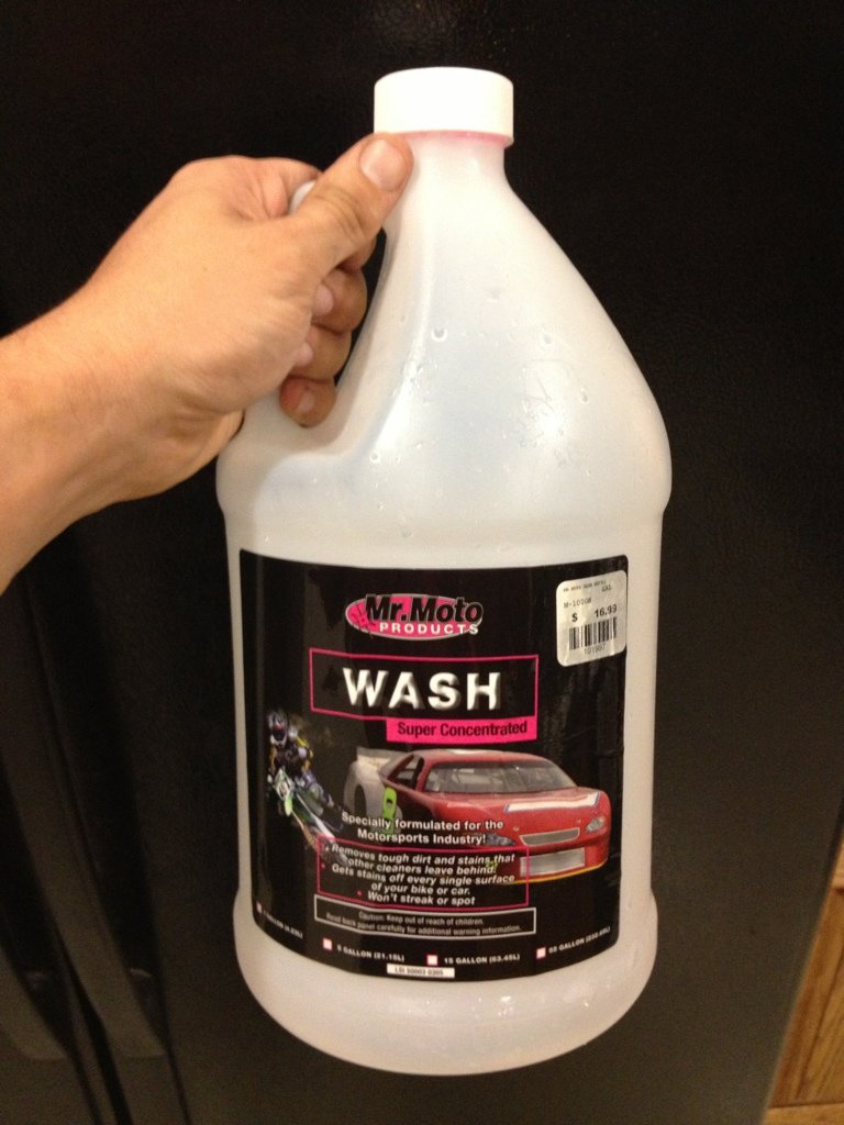

    First, you'll need an empty bottle. I chose to use an empty bottle of Mr. Moto bike wash (since I had one lying around :p), however a screw top windshield washer fluid bottle should work the same:

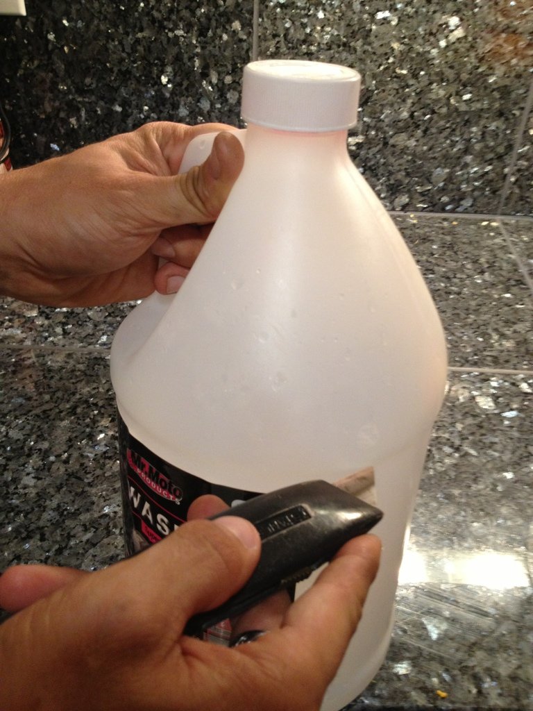

    Next, carefully cut off the top of the bottle using your razor knife:

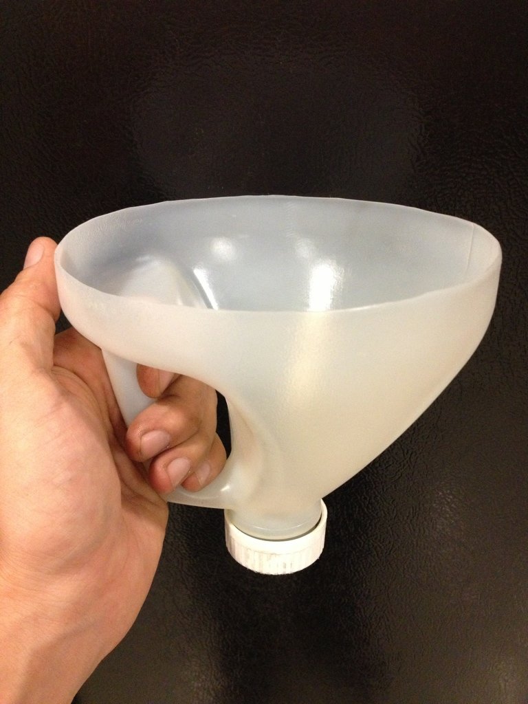

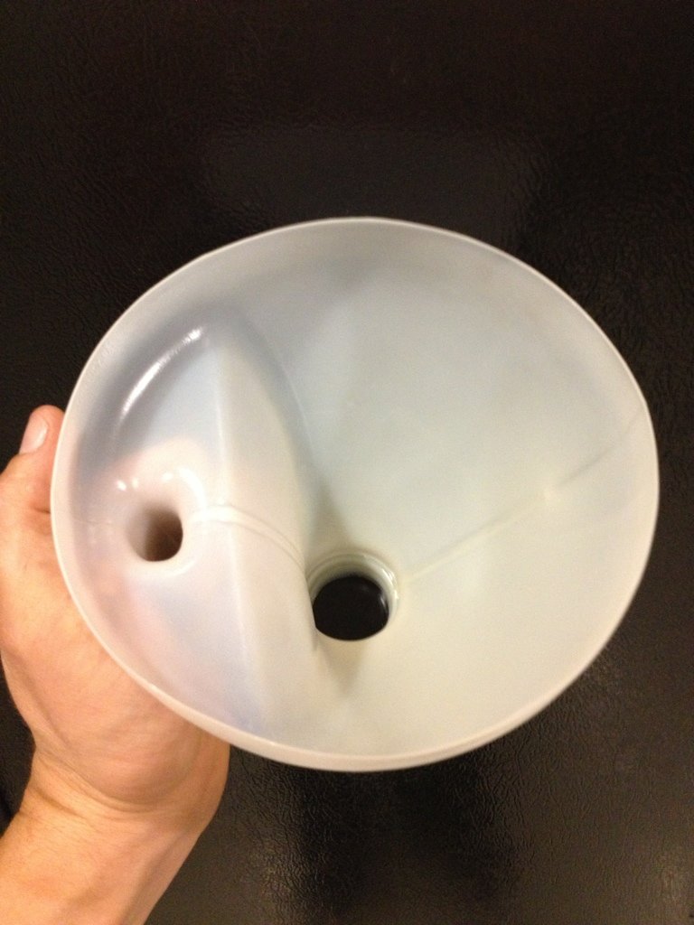

    Congratulations! You now have your finished product! ***IMPORTANT*** Make sure that the inside of the bottle top (funnel) is clean and all debris and loose plastic is removed before use!!:
    81EF95EF-FDA9-40A6-9644-5B7A3EB938C6-423_cb2994d25a66510229809f53041ae399ca4c568b.jpg
    D6BC8929-D771-456A-884C-ED2A6A1ECF56-423_da4a948ba9e8eda90619db05aca44347518353e6.jpg

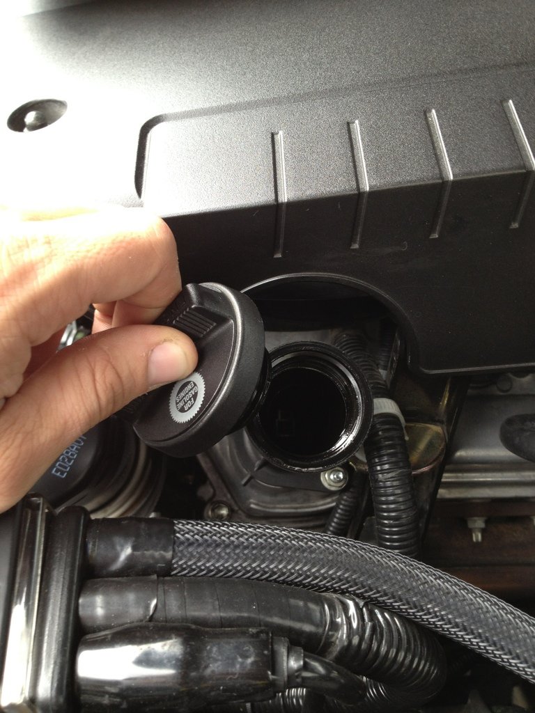

    Your funnel is now ready to use!! Remove the top cap from the bottle and set aside. Unscrew the the oil fill cap and tread the bottle top on to the fill spout:
    5553BBF5-0A79-4128-B1A7-0D48B7FD437E-423_abb5b97802806a9f9aa92cea074d887ec3dc129c.jpg
    That's it!!! You now have a completely stable funnel. After filling is complete, simply unscrew and put the top cap back on the bottom of the funnel and store for next time. Enjoy!!!

    I used an empty bottle of Mr. Moto Bike wash from Cycle Gear. I believe that most all screw top jugs similar to this will work great. I'd be interested to hear which one you all try to see what works and what doesnt.
