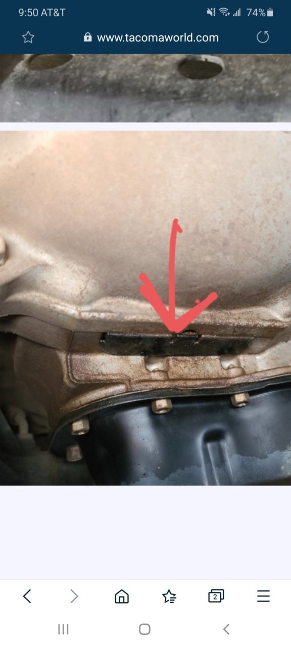

    2016Tacoman
    2016Tacoman Well-Known Member
    Jun 23, 2016
    #190389
    3,484
    J
    2016 Tacoma 4x4 V6 Metallic
    Here ?
    Bleep100 likes this.

    2,178
    19 OR
    Looks like dried up mud or some other stain to me.

    Is this the rear main seal? I suspected that was the leak area 20200511_095159.jpg

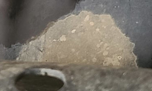

    Dirt

    I checked all over underneath for damages bc I don't want toyota to try to pawn this off on me. I am going to Bellevue toyoya, heard they are pretty good w the offroad scene, my truck is lifted and on 33s so I don't wanna be fighting them doing warranty work.

    Most likely rear main seal. I’ve seen a few leak.

    Rear main is behind that. It's the seal that seals the end of the crankshaft. Where it mates to the transmission input shaft.

    No. It's a weep hole at the bottom of the bell housing.
    It goes around the crankshaft to seal the block where the end of the crankshaft comes through. About the midline of the bell housing, so up several inches from where you see the leak.
    The transmission has to be removed to replace the seal.
    A leaking seal has nothing to do with suspension modifications or using the truck off road. The prime 3 reasons are wear, a faulty part, or a poor initial installation.
    Your truck should be too new for a wear issue if it's been maintained.

    Just got a ride home from Lyft. They said mine was coming from the gasket around the oil pan. I guess they use some kind of silicone. There going to take it off clean it up and put some new silicone around it. They want it to completely dry before I drive it again so I need to go back and pick it up in the morning.
