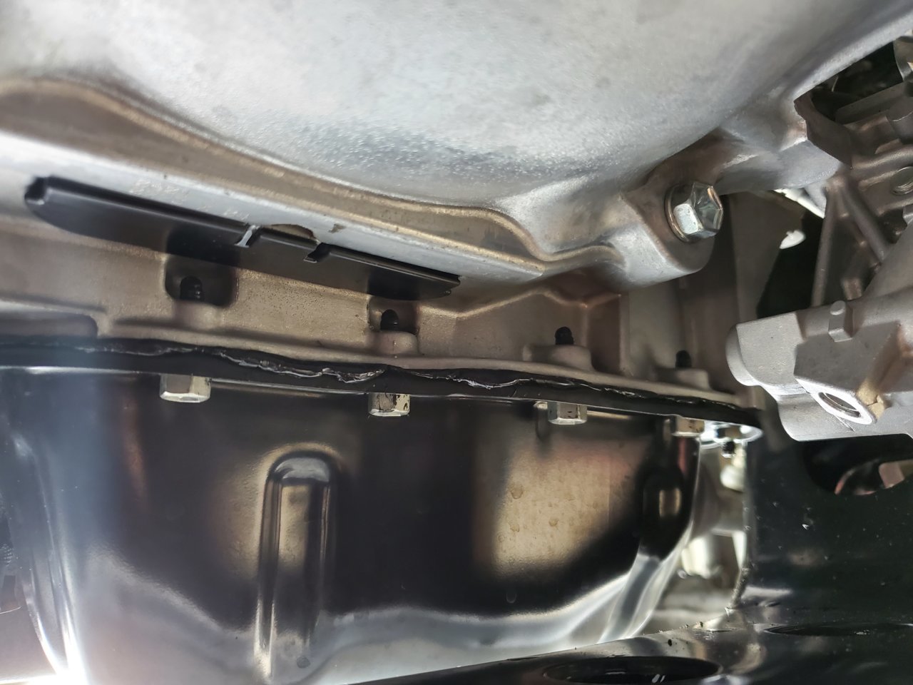

Engine oil leak? Need info plz

    Doubtful it's the oil pan, but maybe. Why didn't u get a rental from them? Aren't u still under warranty?

    Yeah it seems like it was coming from above the pan. Once I get it back I'll clean it up really good and keep an eye on it. They didn't offer a rental and I just needed a ride home, not going anywhere today. My wife passes by there on her way to work so she can drop me off in the morning.

    I doubt its from the pan, but goodluck. sounds like they didnt want to pull the trans

    They should be replacing the gasket, and removing and replacing all the RTV sealant.

    I would just use the black Toyota rtv and no gasket. I use that stuff without gaskets on rear diffs, and oil pans with no chance of leaks. When u pry open a rear diff with black rtv it puts up a hell of a fight.

    When I got mine home I checked it out and there was a little oil on the drain nut. Not sure if it was left over or still leaking. I removed my skid plate cleaned everything up super good and I'll keep an eye on it.

    i would check it every 2 or 3 days and focus on the black bracket looking thing above the pan. if you see oil coming from there take a pic before it travels down to the pan gasket edge. hopefully no leak.

    Went to Bellevue Toyota, determined its either the upper oil pan leaking onto the rear main seal, or the main seal. They plan to pull the motor incase it's the upper oil pan, and then if it's not they will then do the rear main seal. Should be done Saturday next week.

    What is a upper oil pan?

    You clean it and then monitor it. You can get false positives from a leaking oil pan gasket weeping back and up onto the bell housing from wind.

    Why wouldn't they put UV dye in the oil first and find the source of the leak before pulling the motor???

    Idk? I'm not going to drive it for a few weeks and then go back again. They were not suprised it had a leak in one of those two areas, the advisor said it's not common but not uncommon.
