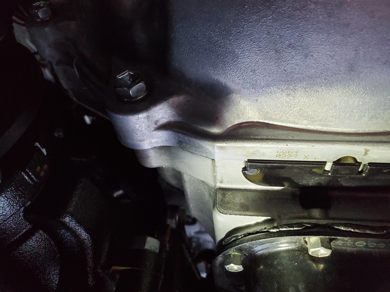

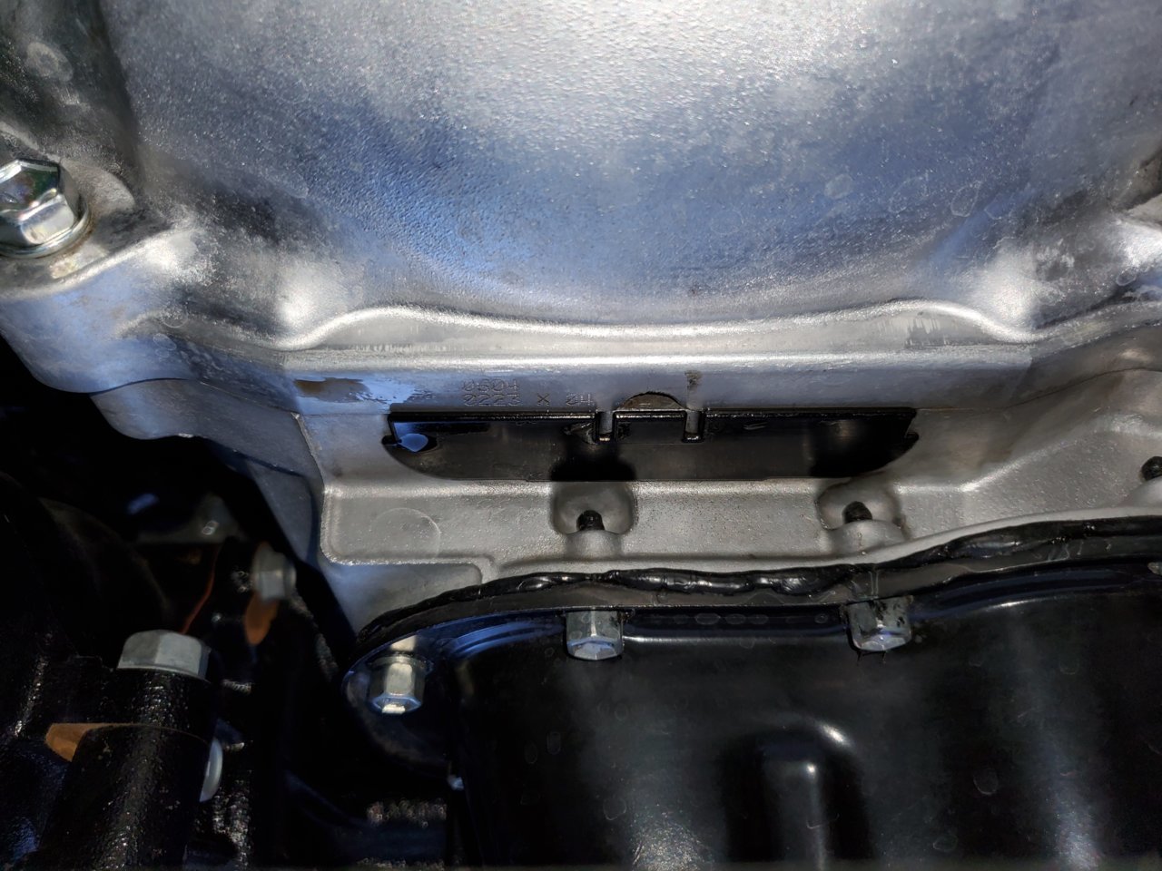

    Donkeythekidd
    Donkeythekidd Well-Known Member
    Jan 4, 2013
    #94450
    376
    Beaumont, CA
    2017 MGM Tacoma TRD Off Road Double Cab
    Yup, just made an appointment to take it back Tuesday. Still leaking and narrowed it down to that black bracket
    So I take it it's also the rear main seal
    Jasonstacoma[OP] and 95tojo like this.
  3. May 22, 2020 at 6:50 PM
    #83
    jruiz555
    jruiz555 Well-Known Member
    Jan 12, 2019
    #279080
    1,192
    Yup looks like it
  4. May 22, 2020 at 6:51 PM
    #84
    jruiz555
    Jan 12, 2019
    #279080
    1,192
    Its a big job, i hope there not trying any quick fix at the dealers

  6. Jun 17, 2020 at 7:27 PM
    #86
    Donkeythekidd
    Jan 4, 2013
    #94450
    376
    Beaumont, CA
    So I took it back in and they wanted to confirm that it was still leaking oil and not just left over so they did the dye test. Next day it was still leaking oil. I had to make another appointment to take it back. They confirmed that it was the rear main seal. Gave me a shitty Kia and sent me home. Next day they had it done. I picked it up and so far have put 800 miles on it and not a single drop.
    Jasonstacoma[OP] likes this.

  9. Jun 28, 2020 at 8:54 PM
    #89
    wcoffman
    wcoffman Well-Known Member
    Jul 7, 2018
    #258631
    594
    '18 TRD Sport DCLB 4x4 SuperWhite
    Fr pass door handle replace, Tyger step rails and soft bed cover, DDSS3 fogs, TRD skid, OR front tow hook, SokieTech hood struts, fr seat covers (neoprene), metal oil filter housing, magnetic oil plug, Cyclone under hood lights, Blue Sea Systems 5025 Fuse Block ST Blade 6 Circuit with Ground and Cover, Blue Sea Systems 60A DC Panel Mount circuit breaker.
    2018 TRD Sport 4x4. 23,400 miles on odo.
    Went to dealer for last 24 month/25K miles service (“oily residue on oil pan” on my punch list). Diagnosed as rear main oil seal leak. Returning Tuesday and leaving all day for the remove / replace.
    Dropped off Tuesday 6/30 and before my ride picked me up they offered a loaner, free of charge. Just retrieved the repaired Taco (Friday 7/3).
    Text from the service order:
    CUSTOMER STATES HE NOTICED AN OIL SUBSTANCE ON THE ENGINE OIL PAN, CHECK FOR LEAKS. FOUND POROUS REAR MAIN SEAL CAUSING OIL LEAK
    RECOMMEND REAR MAIN SEAL.
    90311-A0027 (SEAL, TYPE T OIL)
    HOURS: 5.20
    And the 2nd most important part:
    TOTAL INVOICE $ 0.00
