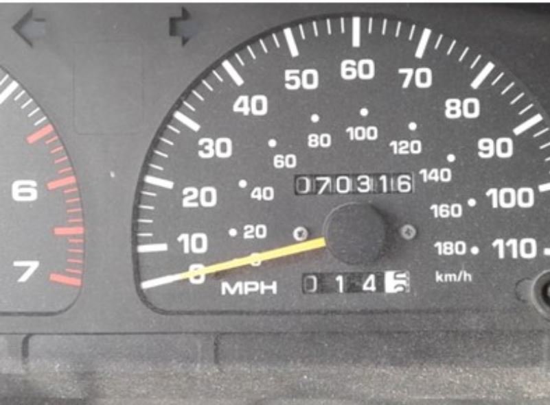

    The engine is from a 98 model 4Runner in Orlando FL with 70,000 miles. It had a clean Car Fax with one owner until it was totaled. I see from CarFax where the 4Runner owner had the car serviced at Central Florida Toyota Scion in Orlando. LKQ is good about providing the VIN and pictures of the donor vehicle.

    Wow, that is a good find, you simply dont see 70K 4runners anymore. Did Toyota use any serials on the engine block that can match it to that vehicles vin? Sure its a reputable junkyard but just curious if you wanted to verify, I may need to do this before long.

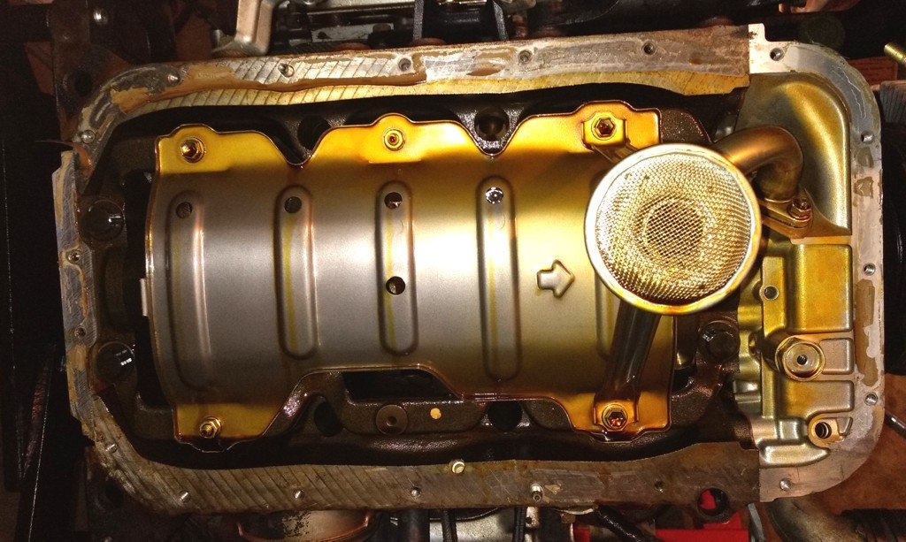

    Pulled the oil pan to get a look. I will be replacing the oil pump tube gasket before I seal it up with new RTV.
    Right now I don't see a reason to pull the windage tray. The bottom of the oil pan was in similar condition.

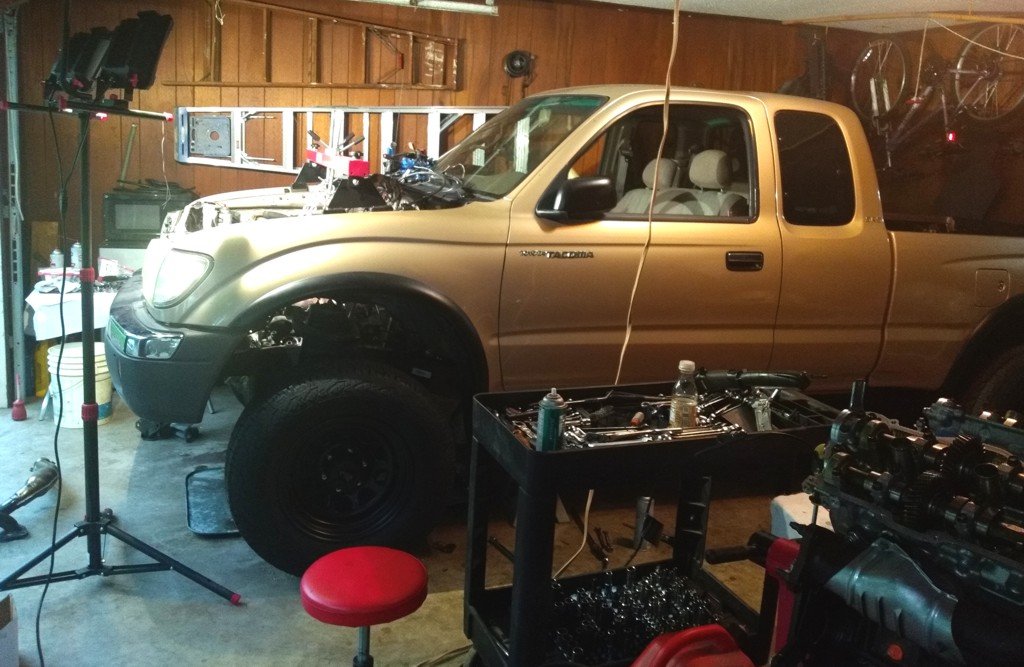

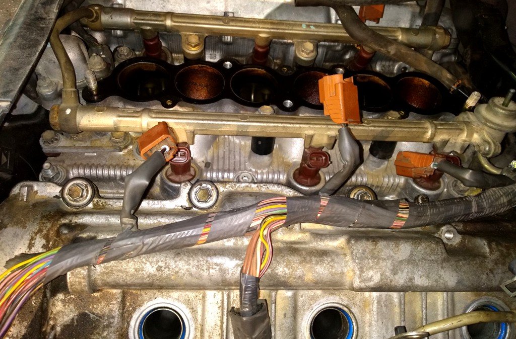

    After spending most of yesterday removing parts to prep for the engine pull, I've found that removing the crossover pipe is worse than just going in to get the top two bell housing bolts from the top. However, I did see a post in the following 4Runner thread about removing the shifter and going after the bell housing bolts from inside the cab. I don't know if this was automatic or manual. Seems like a good idea if it works.
    I have this idea that I can remove the motor mounts, then suspend and lower the engine and transmission just enough get better access to the top two bell housing bolts.
    I like the idea in this thread about making some removable alignment pins out of M12x1.25 bolts. I've used that trick on some other engine work.
    https://www.yotatech.com/forums/f2/3-4-v-6-engine-removal-install-tips-199747/

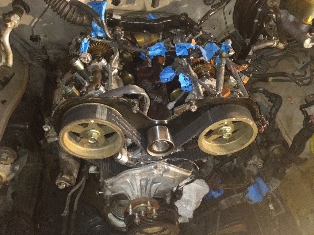

    Yesterday's work on taking down the engine to pull it. Pulling this off gives some clearance during the pull. For the new engine, I don't want to scratch up the valve covers and some of my intake work while hoisting it back in. So I'll finish putting it back in.
    The upper wiring harness has been mangled up. Good, I will rewrap it the way I like to set up my wiring harnesses.
    I've found a bunch of bad work that occurred with the previous owner. Several cases of them using SAE nuts on metric bolts and leaving some bolts with the alternator or PS pump finger tight. Messy work. They changed the timing belt and water pump roughly 3,000 miles ago. But that was about it.
    Also, one of the injector plugs was broken. I've got a spare to fix that.
    After removing the crossover pipe to header bolts (except one) I think I'm abandoning the crossover pipe ides. Too many horror stories from the 4Runner crowd about having to cut the old pipe out in pieces.
    The new engine has a crossover pipe that looks to be in great condition. I've been reading about the flex part of that crossover pipe breaking down over time and people having to replace it. Should I be concerned about replacing the crossover pipe?

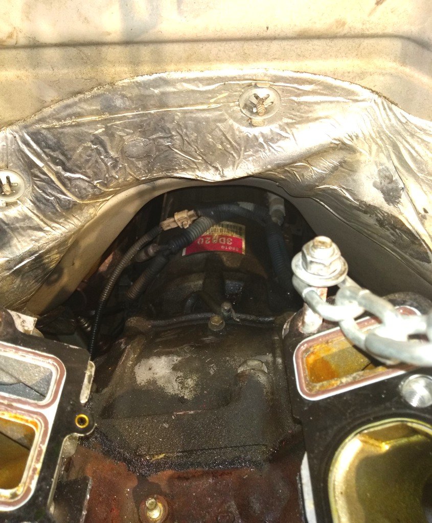

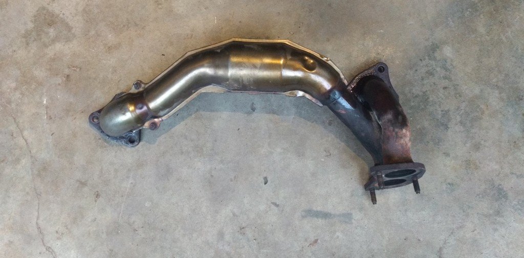

    Ok folks. I did it. This afternoon I pulled the 3.4L crossover pipe with the engine in the truck. I knew that had to be a way to get that blasted pipe off and out of the way for me to access the bell housing bolts. Using my Harbor Freight Engine Support bar helped make it possible. I like to use the support bar with engines during clutch jobs. It lets you maneuver the engine up and down without having to take out the engine hoist and giving up crawling room under the vehicle while accessing the transmission area.
    Here's the old crossover pipe.
    I used the engine support bar to raise the engine just enough to remove the engine mounts. Once the mounts were removed, I lowered the engine so I could remove the crossover pipe.
    I've got all the room in the world to remove the bell housing bolts. What's up with the harness plug that sits on top of the transmission? I bet that is a challenge to access on top of the transmission.
    The engine is PARTIALLY resting on a 2x4 wood block until I finish disconnecting everything and bring out the big engine hoist for the swap. Its weight is balanced between the support bar with a small amount on the wooden block. Though it is rated to support 1,000 lbs, those are Harbor Freight pounds. So I didn't want to leave the engine 100% supported by the bar during the night.
    More to come. I aim to have the engine out tomorrow.

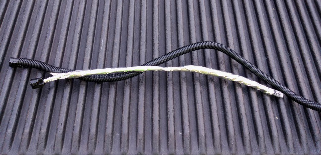

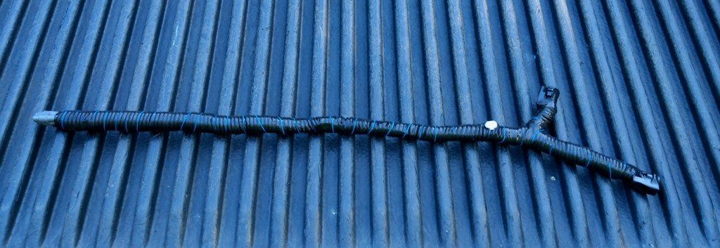

    I have new OEM knock sensors going in with an enhanced KS harness. The new harness has been wrapped in DEI Cool Tape, then wrapped in high temp automotive flex conduit and wrapped again with F4 Silicone Tape. I may need to make an adjustment to it for the tight space under the intake manifold.
    Harness wrapped in DEI cool tape and the conduit material.
    Conduit wrapped in F4 silicone tape.

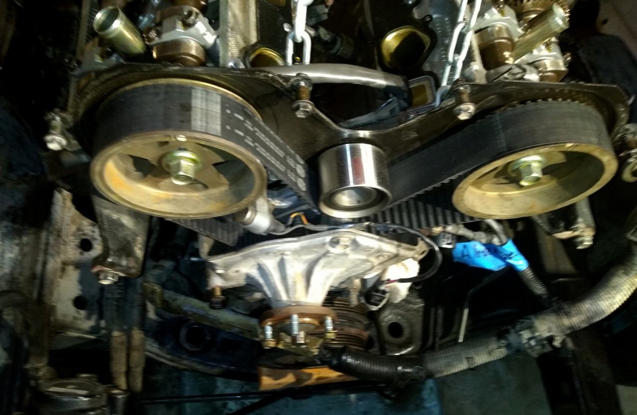

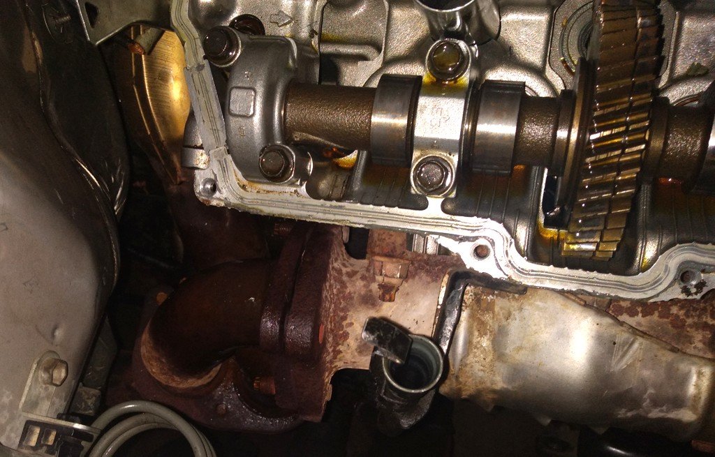

    A really weird thing that happened with the old engine when I shut it down for the last time, the cams and crankshaft landed on top dead center. I still can't believe it. I think I should have bought a LOTTO ticket.
    What are the odds of shutting off an engine for the final time and everything lands on TDC? Look at this picture.
