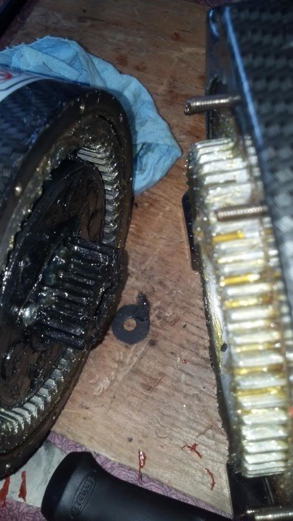

    Taken from another thread, any suggestions?
    I clocked my winch today and now it won't turn when its engaged, the motor tries but i can hear the gears locked, and spins crazy fast when not engaged, i took it apart and can't tell what the fuck i did, any suggestions? Its an engo 10000.

    Talked to Joel at Engo, and I should mention that he picked up on the first ring! He sighed and explained that since there's no documentation about re-clocking the winch this happens pretty often. IT'S NOT A BIG DEAL!
    Don't pull the motor away from the spool at all. If you do you may screw up the clocking of the motor like we did. If you did, you need begin by laying the winch down, standing upright with the gear side down. Then pull the motor side away and reorient the couplers like that of the drawing. Reassemble and cross your fingers (it should have fixed the problem.

    Yep that's it. Great CS one of the reasons I recommend them to people.
