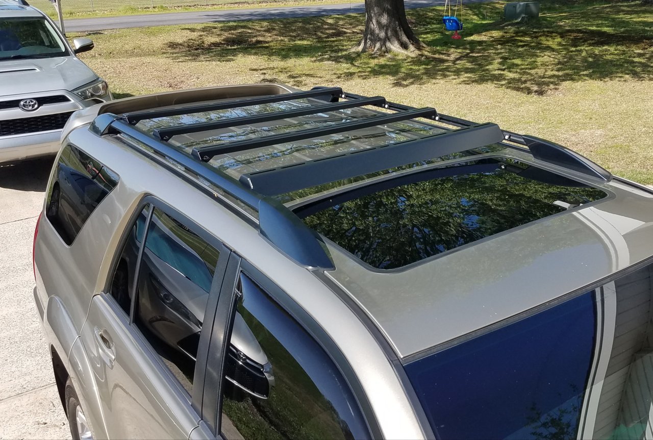

    With the nice weather today I took the afternoon off and installed my LFD ruggedized roof rails. They installed in about 45 minutes but I pulled the factory roof rails off a couple of weeks ago. I'm really happy with how they look and can't wait to try them out. Already looking at cases to mount my Hi Lift and other recovery gear in.

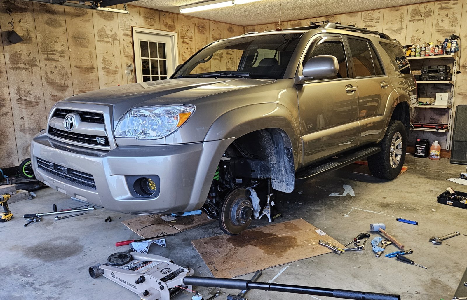

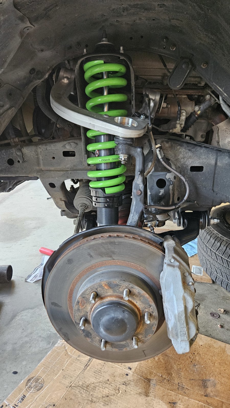

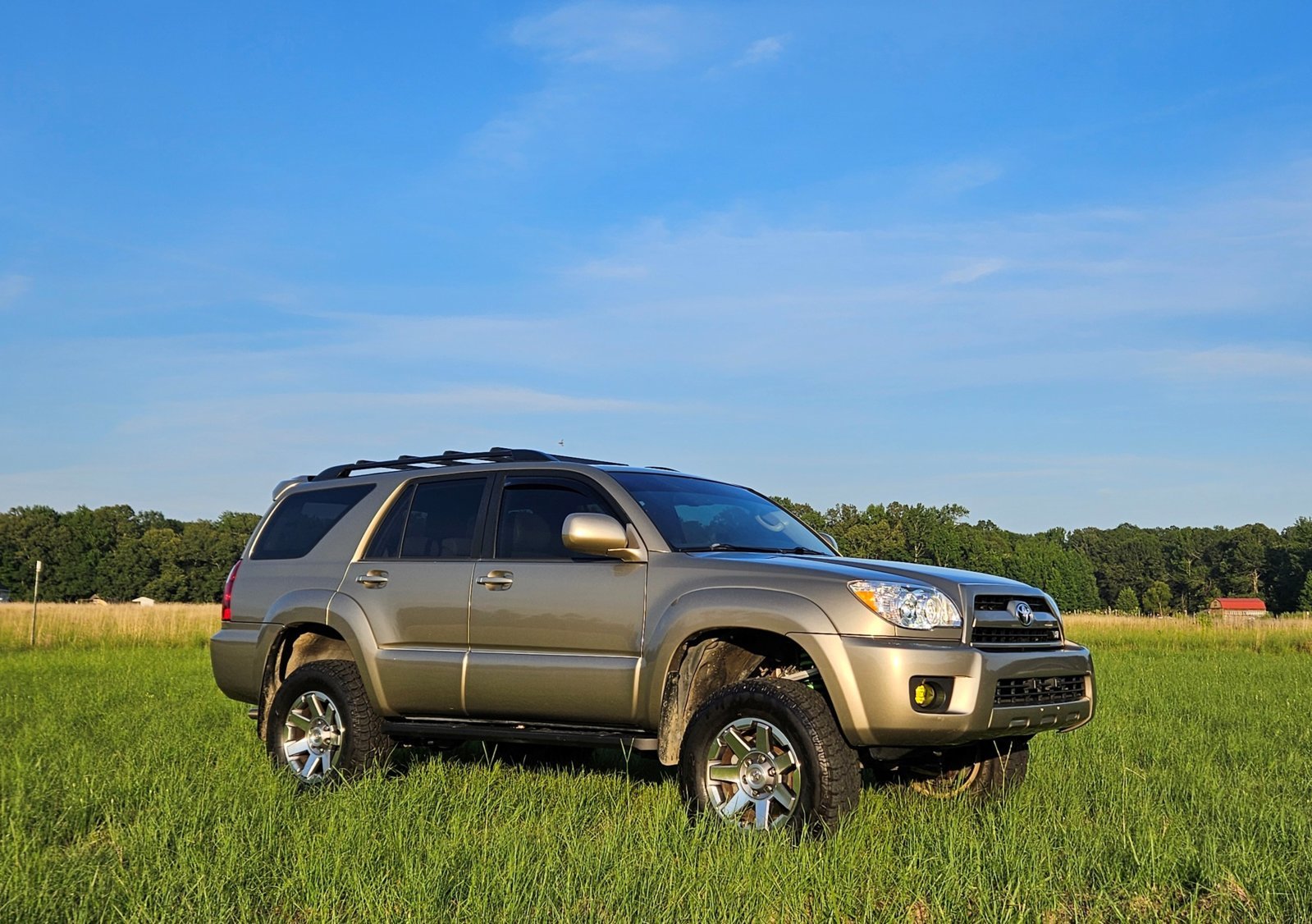

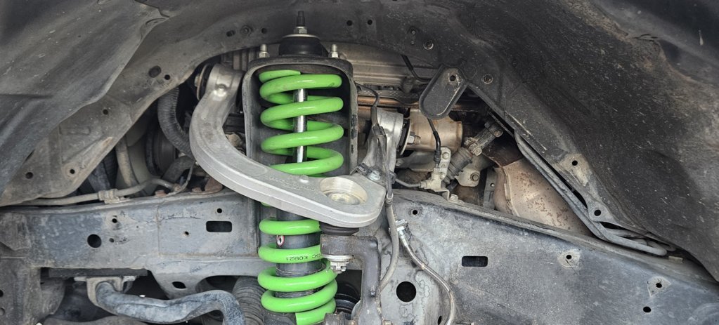

    This is the first update in a long time but it’s a big one. We’re saving to build a house and I’ve been prioritizing that over modifications but my wife (who I think got tired of me taking her 4Runner every time we wanted to go off road) told me to quit stalling and put a lift on mine. I did a lot of research and I really think this will meet my needs. I wound up with an Ironman 4x4 Foam Cell Pro Stage 4 Kit which includes:
    - Front Coilovers (+2.5” Heavy 110-220 lb add’l payload because it’s a V8 and I do intend to put a slimline bumper and winch on eventually)
    - Rear Coil Springs (+2” Medium 0-660 lb add’l payload)
    - Rear Shocks
    - Front Sway Bar Spacer Kit
    - Front Pro Forge Upper Control Arms
    - Rear Adjustable Panhard Bar
    - Rear Adjustable Sway Bar End Links
    - Rear Adjustable Lower Trailing Arms
    I also did a few other things while I was at it:
    - OEM Lower Control Arms with Ball Joints and Bushings
    - OEM Cam Bolts
    - Dr KDSS Bolt on Track/Panhard Bar Correction Kit
    - Rear Diff Breather Extension (run up fuel filler cavity)
    - Crown Performance Extended (+3”) Brake Lines
    - Speed Bleeders (because I’m lazy)
    Even though I haven’t noticed any issues with the existing suspension, the vehicle has ~140k miles on it. I didn’t want to do a bunch of work on the suspension now just to do more later or to be told I couldn’t get a proper alignment because the lower ball joints or bushings were worn out. So I went ahead and did them now. At the rate I put miles on this vehicle, if I overhaul the entire suspension now there’s a good chance I won’t have to touch anything for the next 15 years unless I tear something up on a trail. I also got an Ironman diff drop but did not install it. I’m going to monitor my CV angles and will probably wind up installing it long term when I get aftermarket skids made to accommodate a diff drop. I already have CVJ CV axles with high angle boots.
    I also switched from the Bridgestone Dueler pull-offs to some Mastercraft Courser Trail pull-offs from an FJ cruiser. I bought these a while ago because I wanted a matching spare wheel and got a set of 5 wheels and 4 tires for a little more than I would have paid for a single refurbished wheel. They’ve been sitting in my shop for 6 months or so. The tires have “meh” reviews but they get me from a street tire to an AT without having to spend a bunch of money and they have a ~2 year newer manufacture date than the Bridgestone tires that were on it. I’ll run them for a while and upgrade when needed.
    I didn’t get a lot of photos because I did a good portion of this work alone, it was hot, and I was trying to do A LOT of work over a weekend when my wife and son were out of town. My biggest frustration on this process was the top nut on the rear shocks. It was easy but time consuming to get the factory shocks off with a 17 mm open-ended wrench and using a strap wrench to hold the metal rock guard on the shock. HOWEVER, installation of the new shocks which had a plastic rock guard that wasn’t attached to the upper threaded rod was a pain. I had to hold the top of the threaded rod with a 1/4" open-ended wrench and tighten the nut with a 19mm open-ended wrench. Because of the tight clearances, bushing thicknesses, and the length of the threaded rod it really wasn’t possible to fit the 1/4" wrench and a standard thickness 19 mm wrench in the available space. Fortunately Amazon had a thin wrench for $7.50 and overnight shipping for $2.99. I placed the order around 9 pm Saturday and it was delivered at 8 am Sunday. That was a lifesaver but even with the thin wrench it was a long, tedious process due to a very limited range of motion.
    The second biggest headache of this job was separating the upper and lower ball joints. For the uppers we pounded and pounded on the spindles and they just WOULD NOT separate, even with the load taken off of them. A carefully positioned pitman arm puller solved this issue. I watched multiple videos on YouTube of people driving out the bottom ball joints with a pickle fork but this method didn’t work for us. We wound up removing the LCA and control arm bracket from the vehicle and using a two-jaw puller to separate them. I’m pretty sure separating ball joints is 99% of what I’ve done with that two-jaw puller.
    Overall the install took me Saturday about 8 hrs by myself, Sunday about 8 hrs with my Dad, and Monday evening about 2 hrs going over everything to check torque and button up before putting the wheels back on. I’m glad to have it done and looking forward to enjoying it. I do hope it settles a little on all 4 corners.

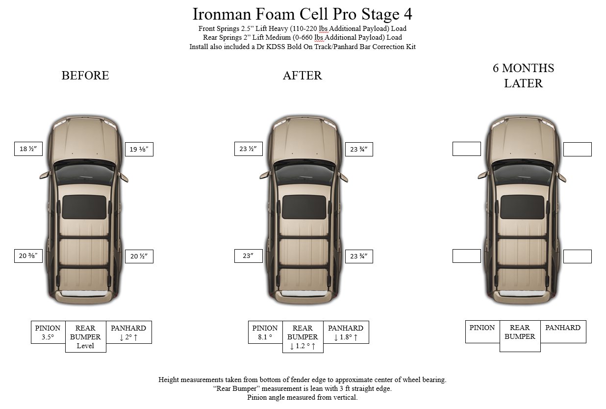

    Here are before and after numbers from the lift. It was supposed to be a 2.5" lift in the front and a 2" lift in the back. It wound up being more like 4-5" in the front and about 3" in the back. I think this is because the old suspension was so worn out. It's sitting pretty level right now but I'll see how it settles. I would like the front just slightly lower than the rear so I can adjust the front if needed. Ironman also makes a 20mm polyurethane spacer for the rear coils so if the rear still has lean after it settles I'll probably pick one up for the left side.

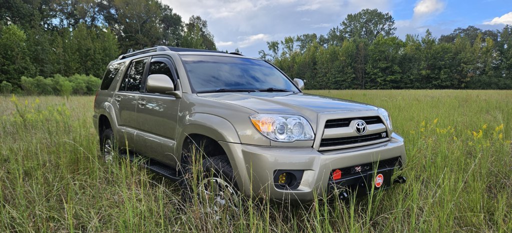

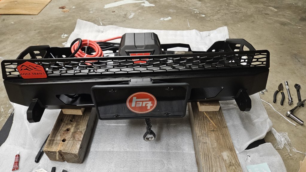

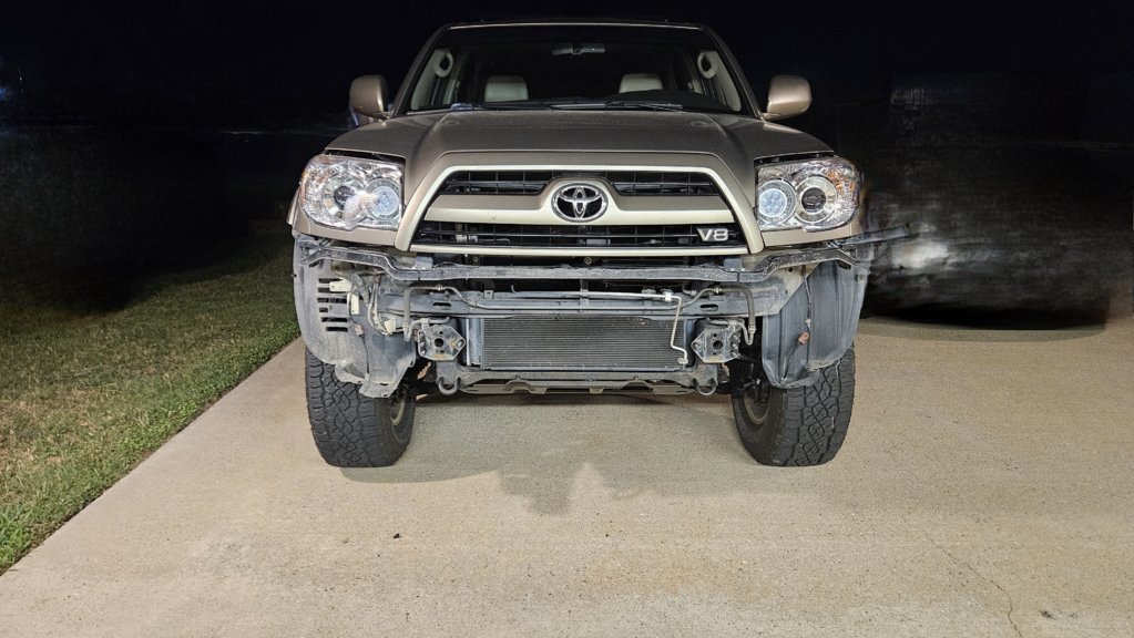

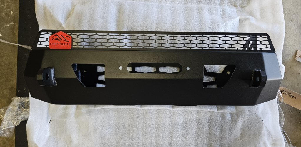

    My cut-in Lost Trails bumper arrived exactly when they said it would, which was refreshing considering it had to be fabricated and I haven't had good luck with companies hitting lead times in the past. The fit and finish on it look great but it was clearly dropped during shipping. Even though it was packaged pretty well, the drop bent the mounting plate on the driver's side but when I bolted it on the mounting plate flattened back out.
    Everything mounted up. I wanted something to protect and somewhat hide the FlatLink so I got a folding license plate mount.
    I actually kinda like how it looks without a bumper but radiators are important so I pressed on.
    I'll have to get some better pictures after I bush hog but I wanted a low profile look so mission accomplished I guess.
    I have a couple of minor adjustments I want to make to the OEM bumper cover when I pull it off in the future to install a light bar but overall I'm very happy with the build quality, fit, and finish of the Lost Trails bumper. I haven't winched with it yet other than to tension the cable but I do have a trip coming up so maybe I'll be able to report back with some impressions after winching soon.

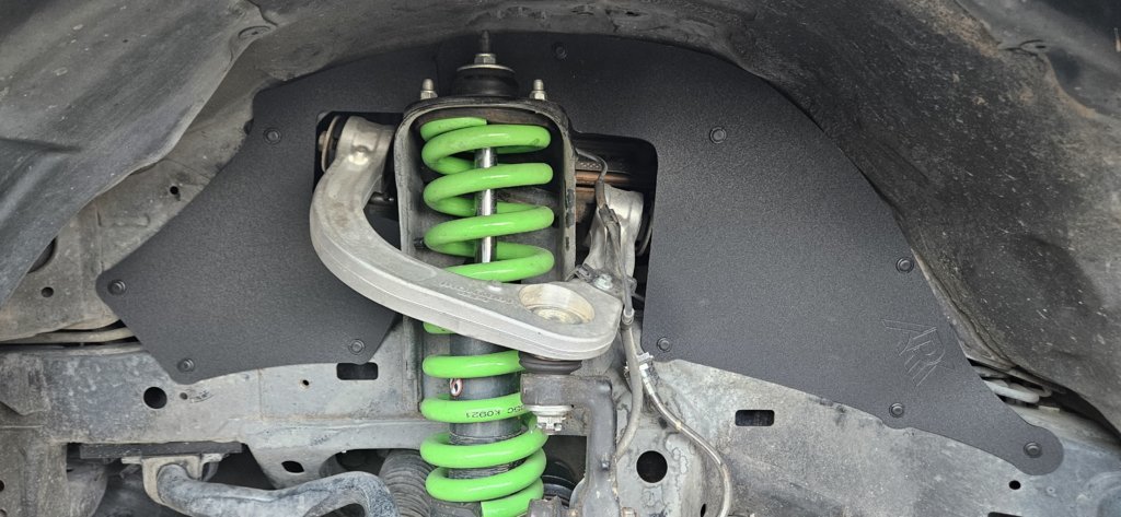

    I spent most of the spring very busy with work and swapping an engine in my DD but last night I did squeeze in a little time to tinker on my 4Runner. The wheel well splash shields were long gone by the time I got this vehicle. It was one of those things that has been in the back of my mind but hadn't thought too much about. While watching a video about something completely unrelated I saw something about Ark Splash Guards and decided to grab a set. Install took ~10 minutes per side including removing and replacing the wheel.
    They look a lot better and should help keep road spray and mud out of my engine bay. Hopefully soon I can find time to go get them dirty.
