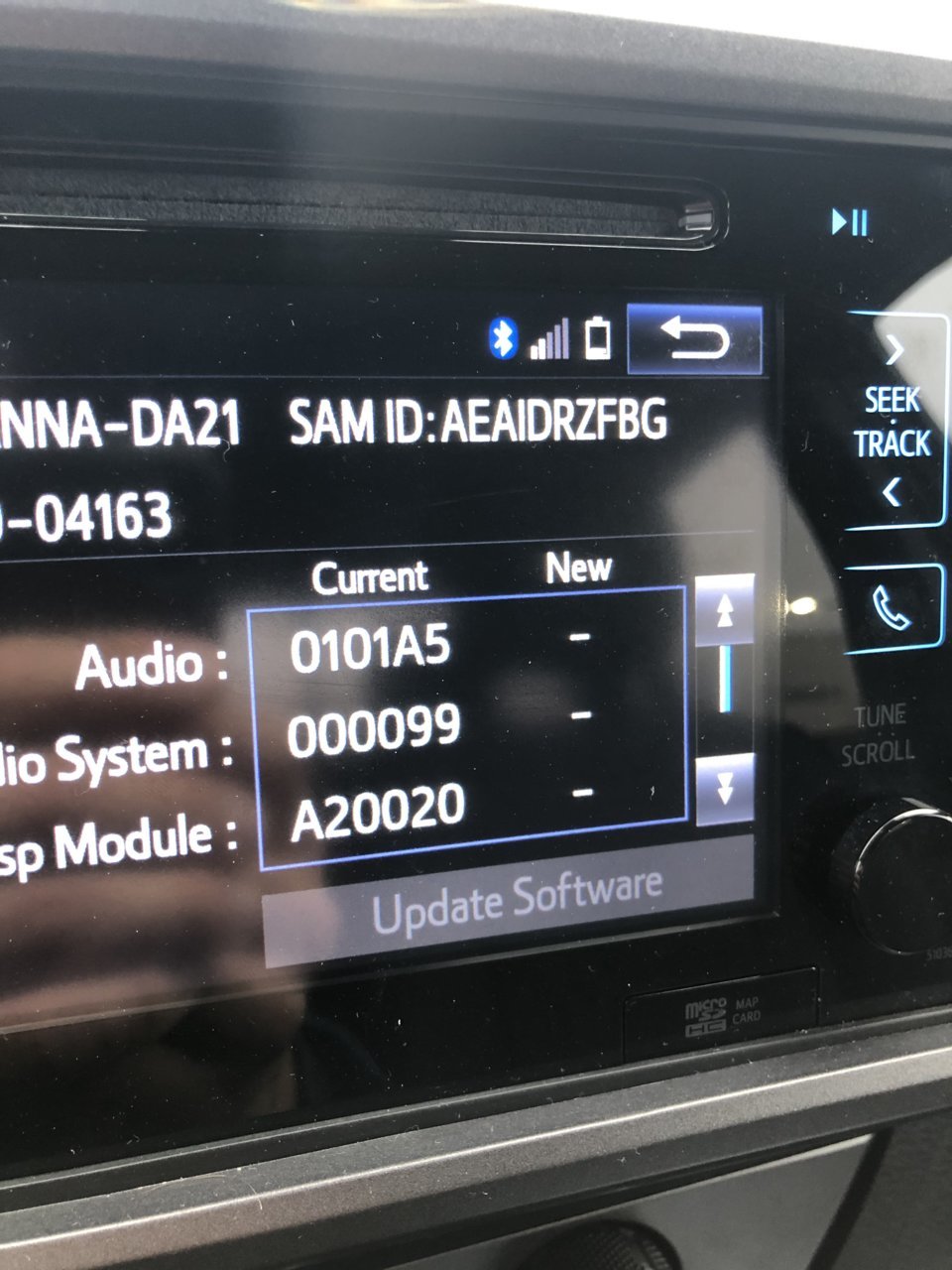

    Hey everyone,
    Just purchased a 2019 TRD off-road with the entune system and it keeps ending my phone calls and dropping them (iPhone X with software 14.2 installed). I searched in the forums about this and it seems fairly common, although it hasn’t been addressed in awhile. I brought my pickup in to get the system updated and updated it with entune app as well. I’ve tried deleting and reinstalling the app, hard resets on the system, deleting my phone and re-adding it to the system and just about everything else. The system will automatically show “call ended” and drop the call around the 2 minute mark every time. Has anyone had these problems, and if so how did you fix them?

    Check out the recent thread from @ktbell444 . He DL'ed the latest firmware.
    https://www.tacomaworld.com/threads/3rd-gen-multimedia-updates.696603/

    I’m already up to date on everything, as the Toyota dealership did it yesterday. But, it’s still dropping phone calls. Any ideas?

    Ah! I thought it might have been longer, esp as that TSB was recently updated to add newer versions.
    Typically, the FW update is what fixes the problem. The only other hope is waiting on a phone OS update.
    For the issues I had, it was a combo of the H/U and phone update to fix it.

    A Google search seemed to find a few possible solutions to try:
    1. Turn off LTE in the cellular/roaming function
    2. Connect your phone to the charger while driving
    iPhone's are a PITA when it comes to connecting to anything that isn't an Apple product.

    I already brought it into them and had them update it, I’m thinking it’s my phones problem actually. My fiancé’s iPhone 8 works great on it. Might just have to get a different phone.

    Well like a lot of people here my iPhone 12 OS 15.1.1 keeps dropping calls. I got the latest software that was posted above 1017A I believe it is. I installed it. Then I forgot the Toyota in Bluetooth settings on my phone and rebooted. I then removed the iPhone from my Tacoma's Blue tooth and restarted the truck. After pairing everything again the problem still exists. The new software didn't fix it.

    I’m in the same boat. Just about 2 weeks ago, my phone calls started resetting the headunit when on Bluetooth. Now I need to start searching the threads for an possible solution. Had the dealer to the TSB update 0003-20 per the link above and it didn’t help.
