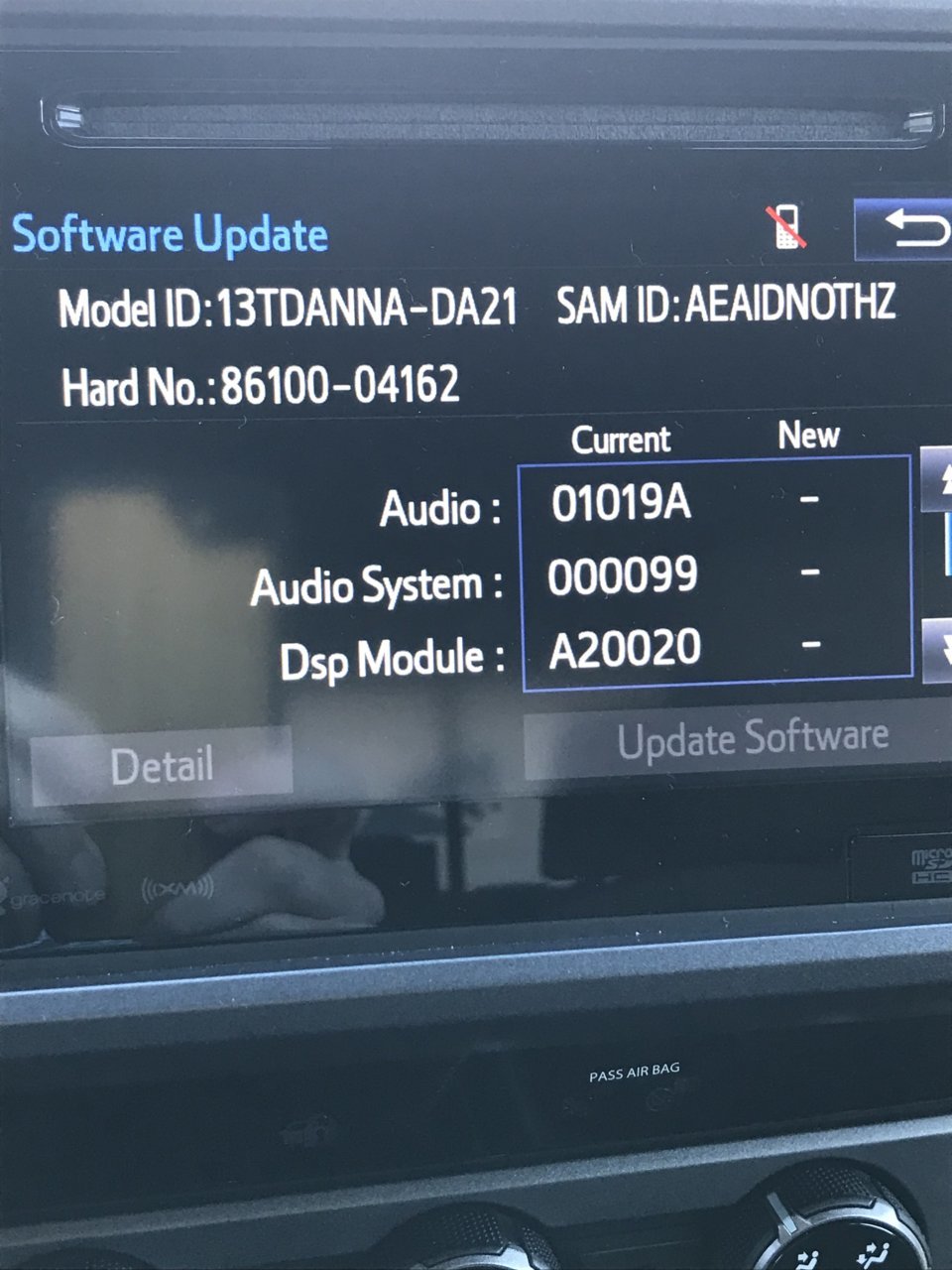

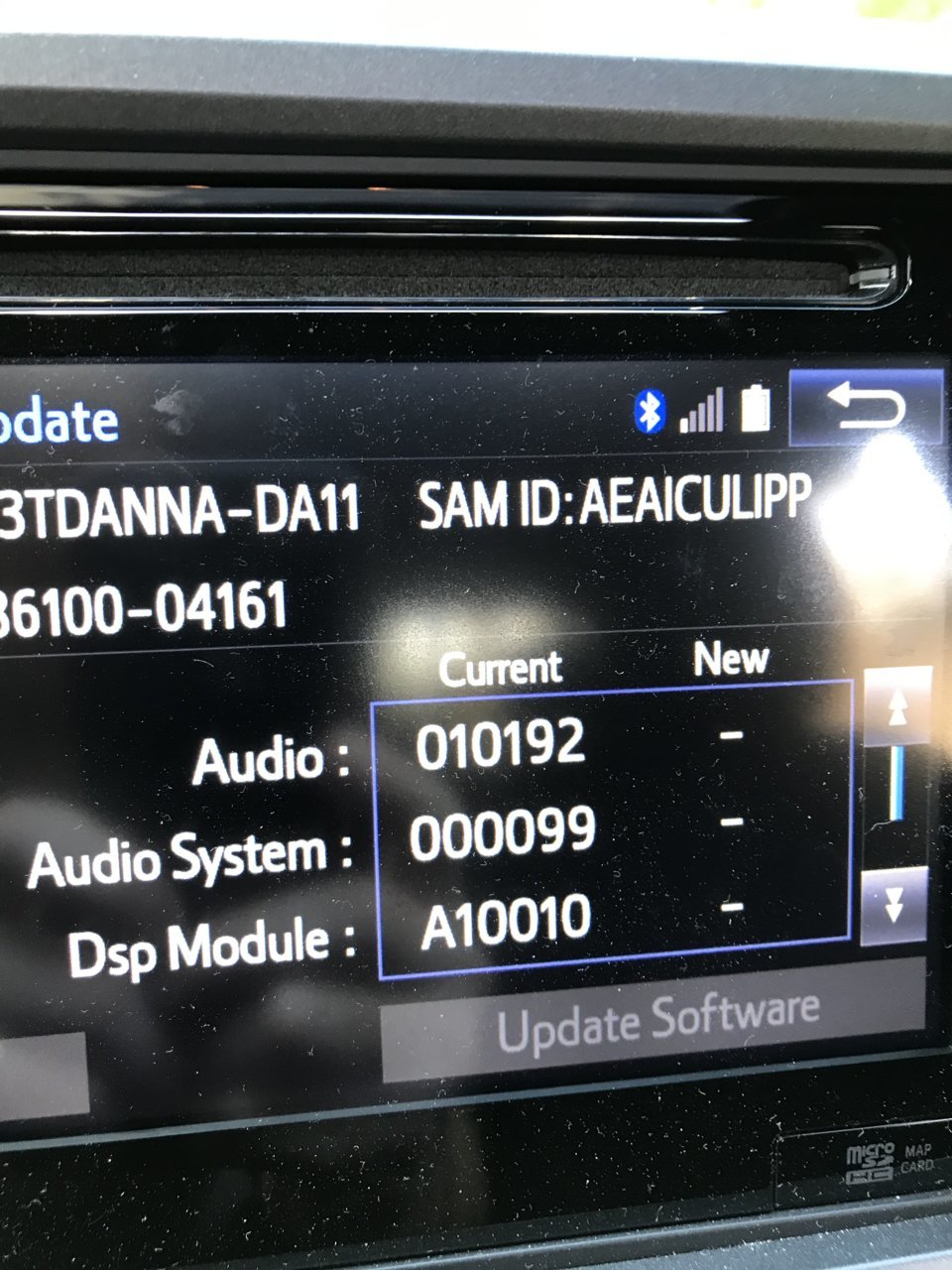

    Is it this version?

    Mine shows a bit different

    Log into Toyota’s website and download the latest update from September to a thumb drive.

    Is this different than the update Toyota pushed out to Entune over air in November?

    I'm not sure what pushed out over the air, but the update on the website is from September 2017.
  20. Dec 15, 2018 at 11:43 AM
    #20
    thetikicarver
    thetikicarver [OP] Active Member
    Jun 17, 2018
    #256647
    34
    Tom
    2018 Tacoma TRD Off Road
    I bought the truck new in June 2018 so I definitely have the latest
