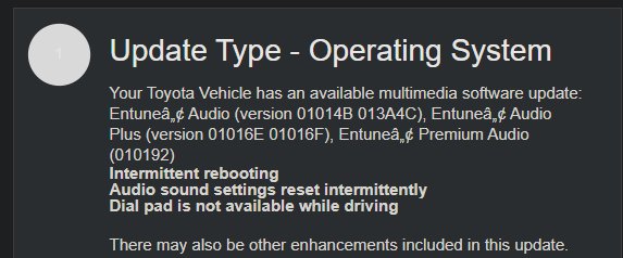

    tonered
    tonered bartheloni
    Sep 25, 2017
    #231055
    31,203
    tony
    Lynnwood, WA
    That is what is says:
    STrooper[QUOTED] likes this.

  8. Nov 12, 2019 at 6:13 PM
    #88
    KAP63
    KAP63 Member
    Feb 12, 2019
    #282826
    19
    San Juan, PR
    TACOMA
    SIDE STEPS, DIAMONDBACK HD BED COVER & STORAGE BOX, CERAMIC COATING (CAR BEAUTY SYNERGY PRO), LETTER INSERTS TAILGATE/GLOVE COMPARTMENT
    Get the latest software updates for your vehicle's multimedia unit.
    Zoom Plus[​IMG]
    Entune™ Premium Audio Systems
    Currently no updates available for this multimedia unit.
