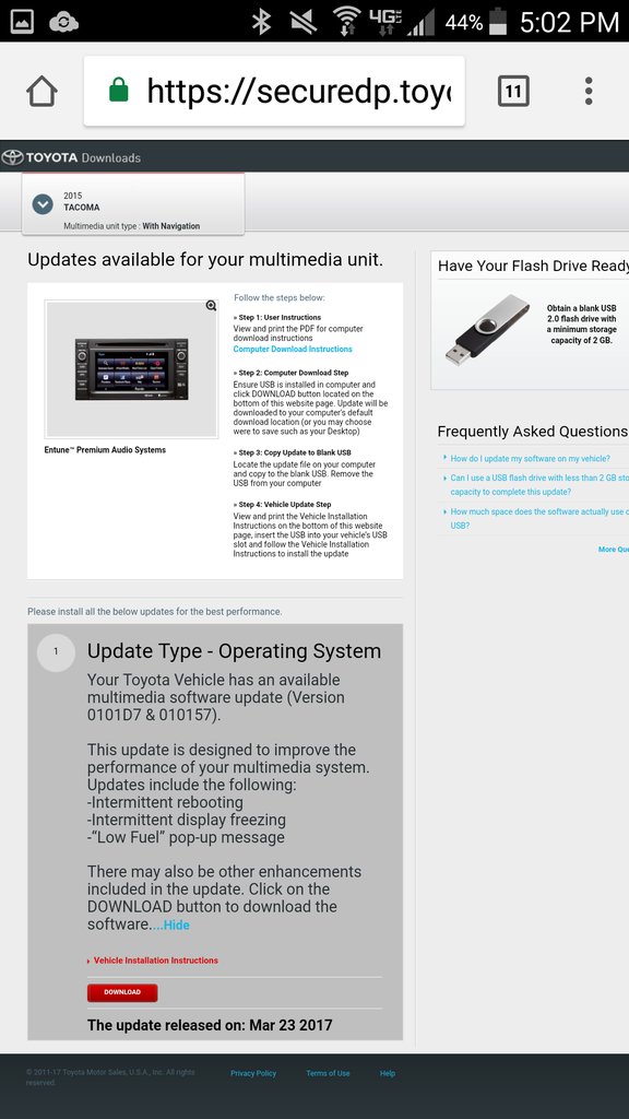

    No need to go to the dealer for software updates. Here is a link to the Toyota website to download updates to your Entune system. Mine had a OS upgrade dated March 2017 to fix the random reboot issue. I downloaded and installed the update. Time will tell if it's fixed.
    https://securedp.toyota.com/download-app/getUpdates

    Must not be any for yours. I've been waiting forever to get an update for my 2nd gen. Not sure how long this website has been around but it hasn't been too long. Used to have to have the dealer update the software. Glad Toyota finally let us do it ourselves.

    Hmmm...seems not all updates are on the site. It had what I needed though. Keep checking back for future updates...

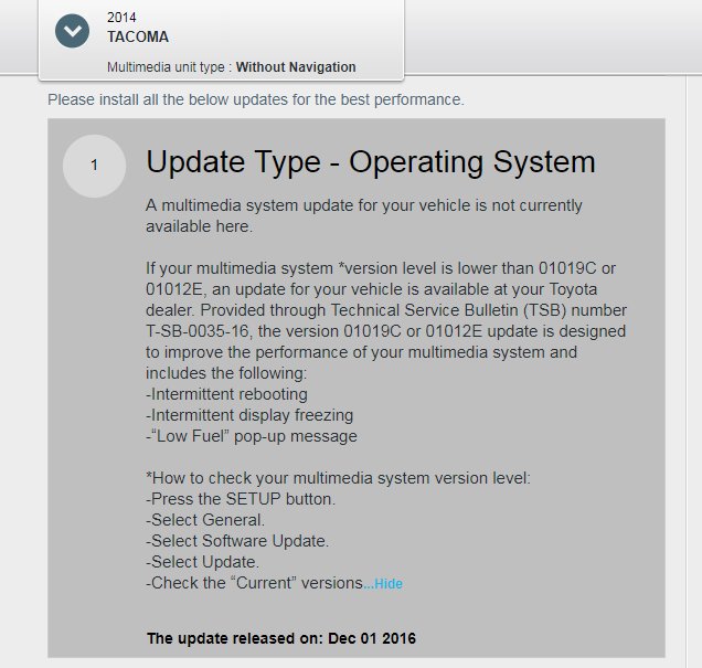

    Mine has an update, but apparently not available on the website, still have to go to dealer. Oh well. 2014 Entune audio plus w/o nav

    Any update to this besides going to dealer and doing TSB?

    You have to go to the dealer, they will not let you do that update online. Just had mine done on my 15 fixed All the problems, freezing up and rebooting. If you have access to Toyota Techstream you can view all the updates.
