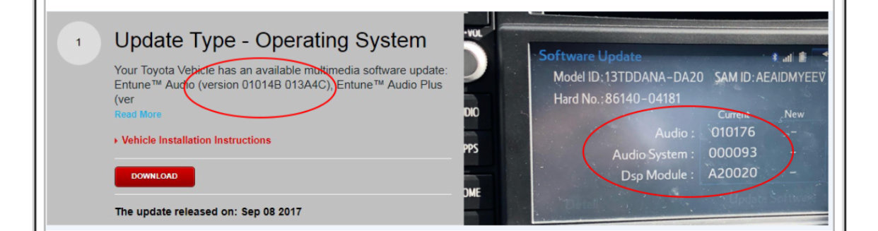

    Below is the changes
    https://securedp.toyota.com/download-app/getUpdates
    Update Type - Operating System
    Your Toyota Vehicle has an available multimedia software update:
    Entune™ Audio (version 01014B 013A4C), Entune™ Audio Plus (version 01016E 01016F), Entune™ Premium Audio (010192)
    • Intermittent rebooting
    • Audio sound settings reset intermittently
    • Dial pad is not available while driving
    There may also be other enhancements included in this update.
    ...Hide
    Vehicle Installation Instructions
    The update released on: Sep 08 2017

    I tried to update the software but the update button almost gray-out.I bring it back to dealer, they said that my version is lasted. When go online to check it, I saw the vesion online currently different with my one. I dont know which one is newr.

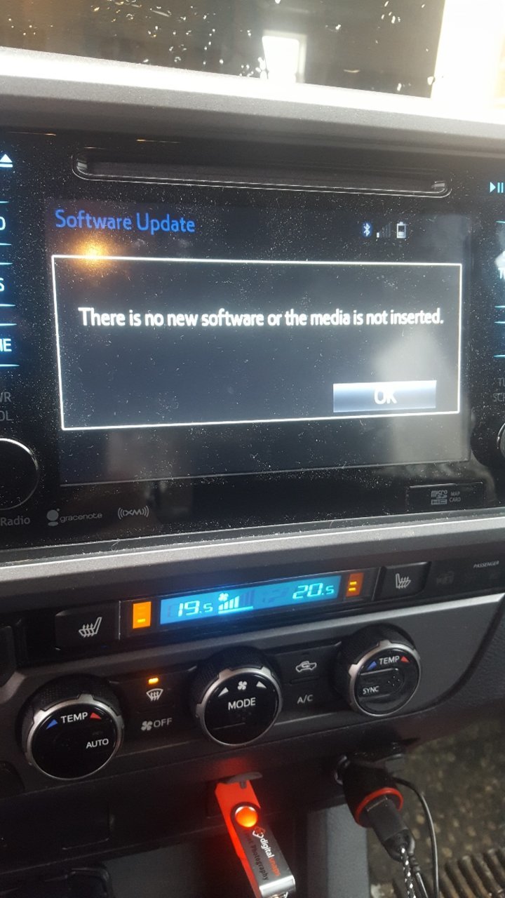

    Here is what I have on my 1 day old 2018
