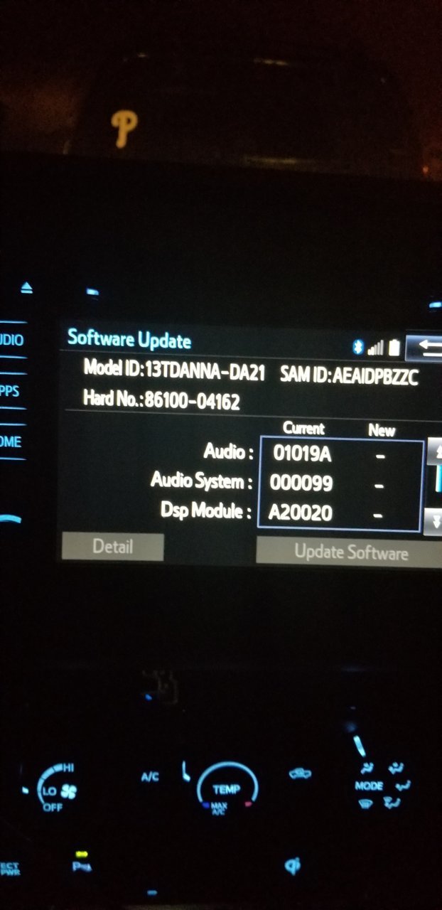

    I just tried again after months first semi warm day, but still update is grayed out. not sure if the site version is older than wats already flashed on radio

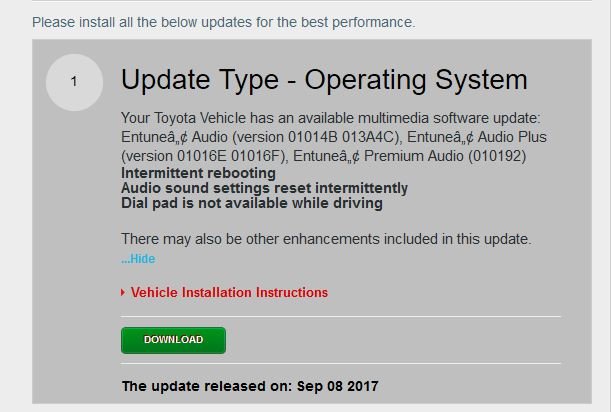

    When upgrading for the second time now, I noticed the Device Driver, Audio, etc all shows the new version number each time and gets updated, but the 'Operating System' at the top of the list never listed the new version number, just a "-" so it remains on the old version. Is this normal?
    When using entune app on my phone, would it prompt me to update too or are the apps just to play music through?

    Just upgraded my 2013 from 2.1 to 5.2 and exFat didn't work. I had to run DISKPART to format my USB to FAT16 to get the HU to detect an update. The update took about 5 minutes. Sure beats paying the stealership $100.
    So far I see zero difference and MAPS is still the only app. I'm guessing maybe it updated some map info. Not really sure if this HU has Entune, but the NAV is handy.
