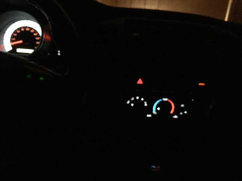

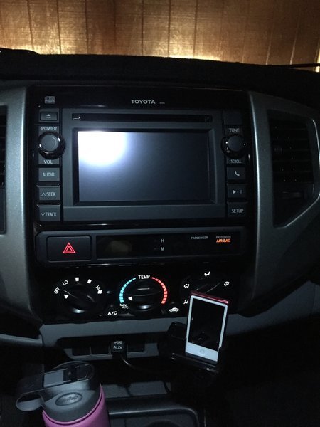

    Ugh! This seems to be my problem now! I don't have an entune stereo though! But I just don't know what's going on! A month ago I had my truck rewired from tapping into the doors for my sub/amp to going into the back of the factory deck. All was working great until a few weeks ago when it all started with my Bluetooth acting funny with not picking up calls then all of a sudden the whole stereo, including the clock going completely off for a bit then coming back on. Done that off/on quite a bit then it went off again for days without coming back on! Checked all the fuses and they were all good! Rode around with no music for a few days and even the USB port wouldn't work then all of a sudden it comes back to life! Long story short I took it in today to our local stereo installer guy and he took the deck out thinking maybe something was loose in back but nope all wires are in solid and even he is baffled! He suggested swapping out the deck for an aftermarket one just incase the stock deck has a glitch and so we ordered one with our fingers crossed that this will work and fix the problem! I just don't get what's wrong! If this is a coincidence with this happening after the back of the deck was touched and it's just a stereo going bad versus a bad electrical problem I don't know what I or what could be done! Any advise or thoughts would be greatly appreciated! Thanks guys! :)

    Honestly I don't think its the deck problem, its probably firmware. now I do have entune on my truck but I don't know if the non entune stereo has a firmware you have to upload. cause I had some what the same issue as you on my truck I had to take it to the stealership to have them update my firmware on my deck. and I did that 3 times before it started working and function the way its suppose to do. but I hope your deck problem gets solved from aftermarket deck GL

    Hi there. Although I don't think my stereo is an entune stereo because I don't have the app button that I've read about. :confused: Yet again this morning I had the black screen of death and I just don't understand why my clock goes out and also my USB/aux outlets don't work as well? Is this an electrical problem and not stereo related? :eek::notsure:

    yeah I think they do it through USB to update firmware. but if you already replacing it with a aftermarket deck then no worries. but if anything u probably can sell that on ebay or something but I would just cross reference and see if you can update that deck.
