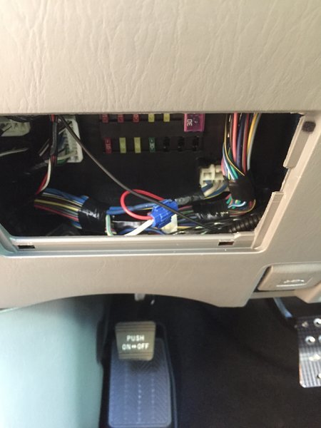

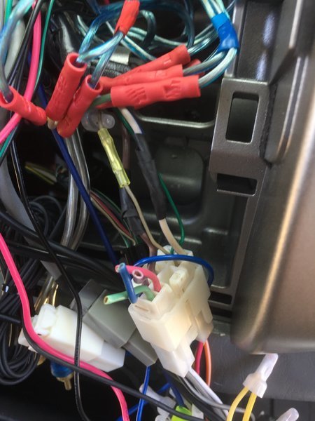

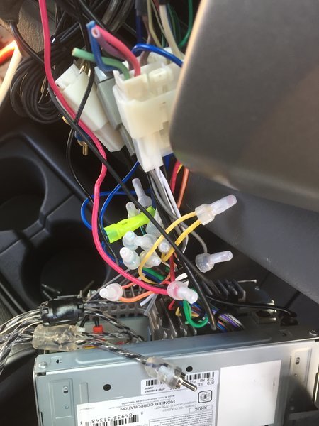

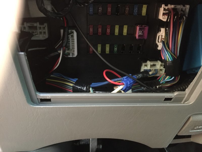

    Ok, so finally got my truck looked at again and the installer found out that the accessory line has a problem from the fuse box. When he tested that area it was dead at first and then started clicking off and on. I was told the stock harness looked ok even though wires were cut from it. He said he ran his own wire from the stereo tapping into the fuse box by passing the accessory line to make the stereo work but its over his head being that the problem is the fuse box and I need to take it into Toyota to get it looked at. Yay for me because that's gonna be expensive!! I tried to get pictures but wasn't there long enough while he worked but managed to get a couple that I don't know if will help or not but here you go. :)IMG_7219.jpgIMG_7220.jpg IMG_7221.jpg

    What the hell?!?!?!?.... what a mess... so I can see you have an amp in there powering your speakers but the pics don't unfortunately do any justice. Is the radio out or put back into the dash? Also, do you know if ANY other accessories ( cig socket, dome light etc ) stop working when the radio power was lost? Did he say if the radio fuse was blown? If nothing was wrong other than the radio and he truest did bypass the factory wiring ( still can't tell by the pics ) then no need for the dealer. I see factory wiring go bad for some reason all the time. In an earlier post of mine I told you what wires needed to go to the ignition harness for the installer to do IF he had to run new wires. NOT. The fuse box but it is what it is

    Yes it is a mess!! Pardon my French but it literally is a cluster fuck!! Sorry about the pictures that is all I could get. The radio is back in with that by pass wire and although I know you told me which wires to connect to do that the stereo installer did it his way cause I'm just a girl and what do I know. From what I could gather he only did 1 wire from the stereo to a wire in the fuse box to by pass the bad accessory thing! Anyway, the dome light still worked while the clock, USB and cig socket did not. Fuse on the deck itself was still good and wasn't blown. I have to call Toyota tomorrow and will probably end up having to give them my first born for payment for whatever this will cost!! I took a picture of the wire he put in to get it to play (red wire to white wire with blue strip) but I'm sure that still won't help. :( it's weird that if you jiggle that accessory fuse itself the power goes off and on. So as of right now my clock, USB and cig sockets are working for the time being! Thank you again for all your help and advice. Wish you were here in Hawaii because I'd definately take my truck to you!! Hopefully I won't end up having to sell it! IMG_7224.jpgIMG_7223.jpg
