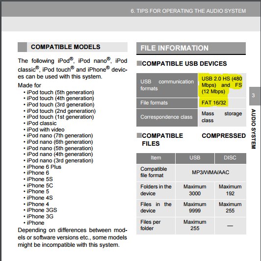

    Question: What is the biggest supported USB memory size on the stock head unit?
    I currently have a 16GB stick and was looking at the Amazon specials going on and wanted to expand.
    I looked through the manual and nothing was found. Manual link.
    Thanks!
    The only thing that I was able to find was this....

    File count appears to be the LIMFAC as opposed to size.

    9,999 files
    32 gb or 64 gb is plenty
