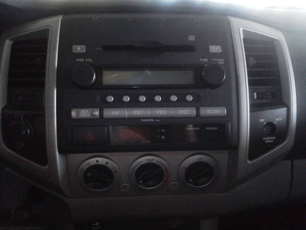

    Pretty sure you'd have to replace the entire "underpinnings".
    The 12 radios and 11 and older do not properly fit the plastic surrounds.
    Major ordeal with the AC vents and airbag controls being different.
    Wait...
    That listing indicates it's for the older model.
    Where are you getting that it's a '12?

    Lol I forgot a few key words in my post. I'll rephrase it. Can I get environment controls like the 12 to match that radio for the 05/06?

    Ahh....
    Okay.
    That's not "like the 12"
    That's the black face, which was used in the RC, I assume to reduce glare from the rear window, and possibly all base models.
    Yes. The enviro controls from any '05-'11 will plug right into your '06
    Put up a WTT in the Marketplace. A lot of RC owners (myself included) would like to replace the black controls with silver to match aftermarket head units.
    If you were local I'd drive over today and do the swap.

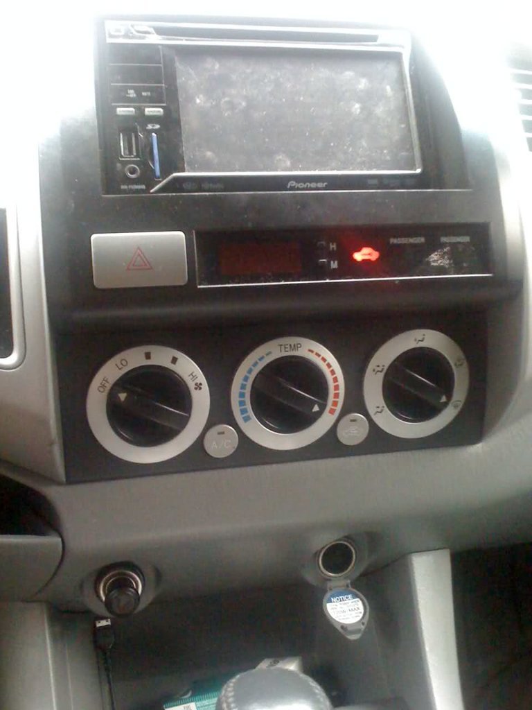

    Ya, silver to black is easy.
    Black to silver.... I've just never had good luck with silver rattle cans.
    Without a clearcoat they always end up transferring aluminum to anything that touches it, and ends up with stains and dark streaks.

    Well he's wanting to go from silver to black. So he should have no problem. Buy some satin or flat black paint, and matte clearcoat and have at it. I sprayed mine with 3 coats, and 2 of clear. it's holding up perfectly fine on my AC controls & dash kit

    You might wanna just paint it. The black ones are hard to come by. Black radios, black clock/hazards & black ac panels are scarce. Have to luck out on a part out or somethin. I lucked out, I have full black and full silver ac vent piece, stereos, clock/hazards & AC panel setups so I can switch out or mix/match without painting anything back and forth. Putting silver buttons on the black stereo and black buttons on the silver stereo or leave them silver on silver/black on black is also option.
