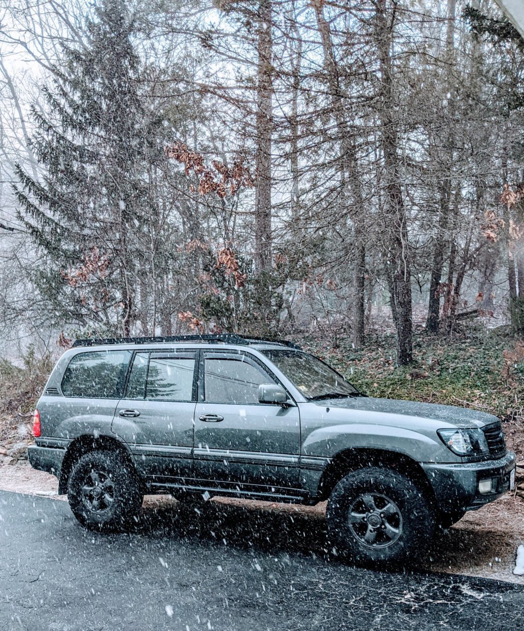

    Just happened to catch a little snow squall in action...

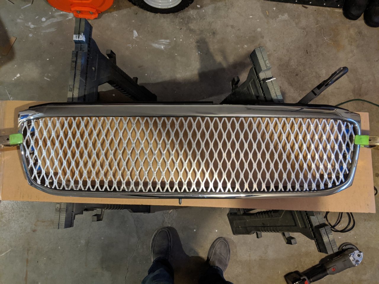

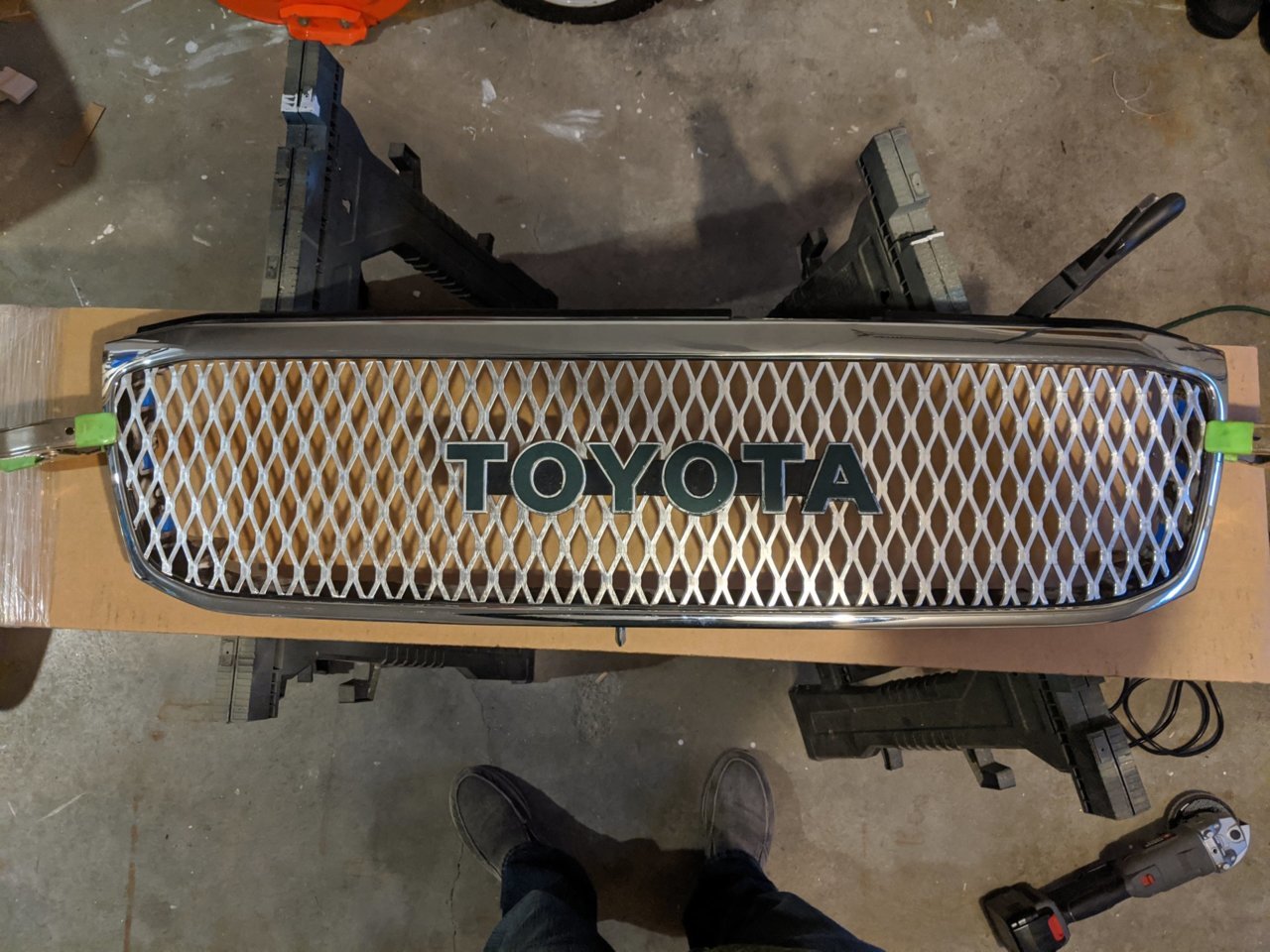

    I've been working on a diy custom grill on and off for a little while now. Here's where I'm at today. Still need to make the attachment points and paint it all black. Toyota will be River Rock Green, and outlined in silver.

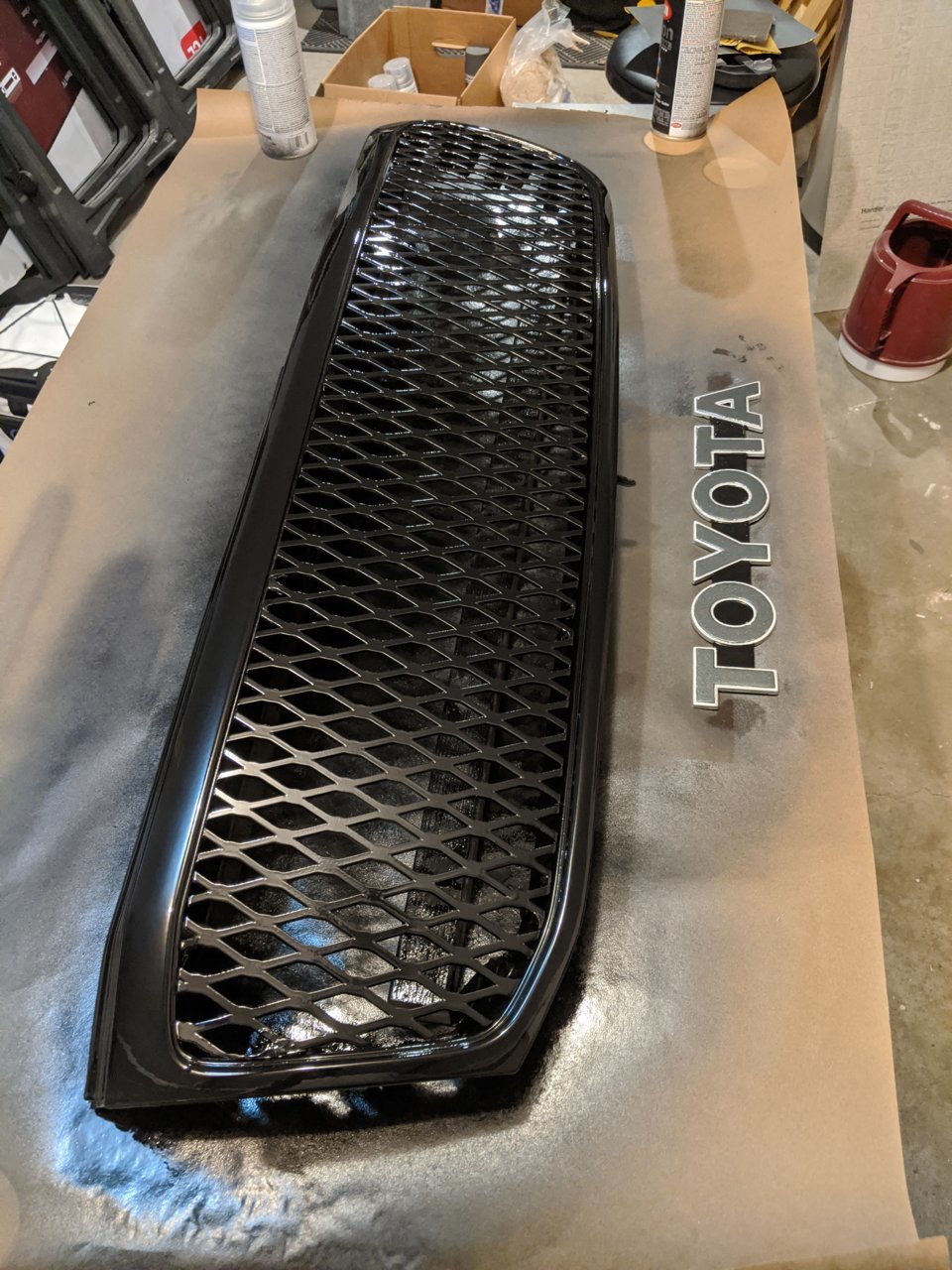

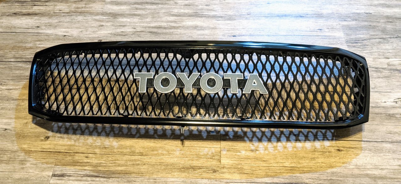

    Painted up tonight, hopefully have it on the truck tomorrow!!

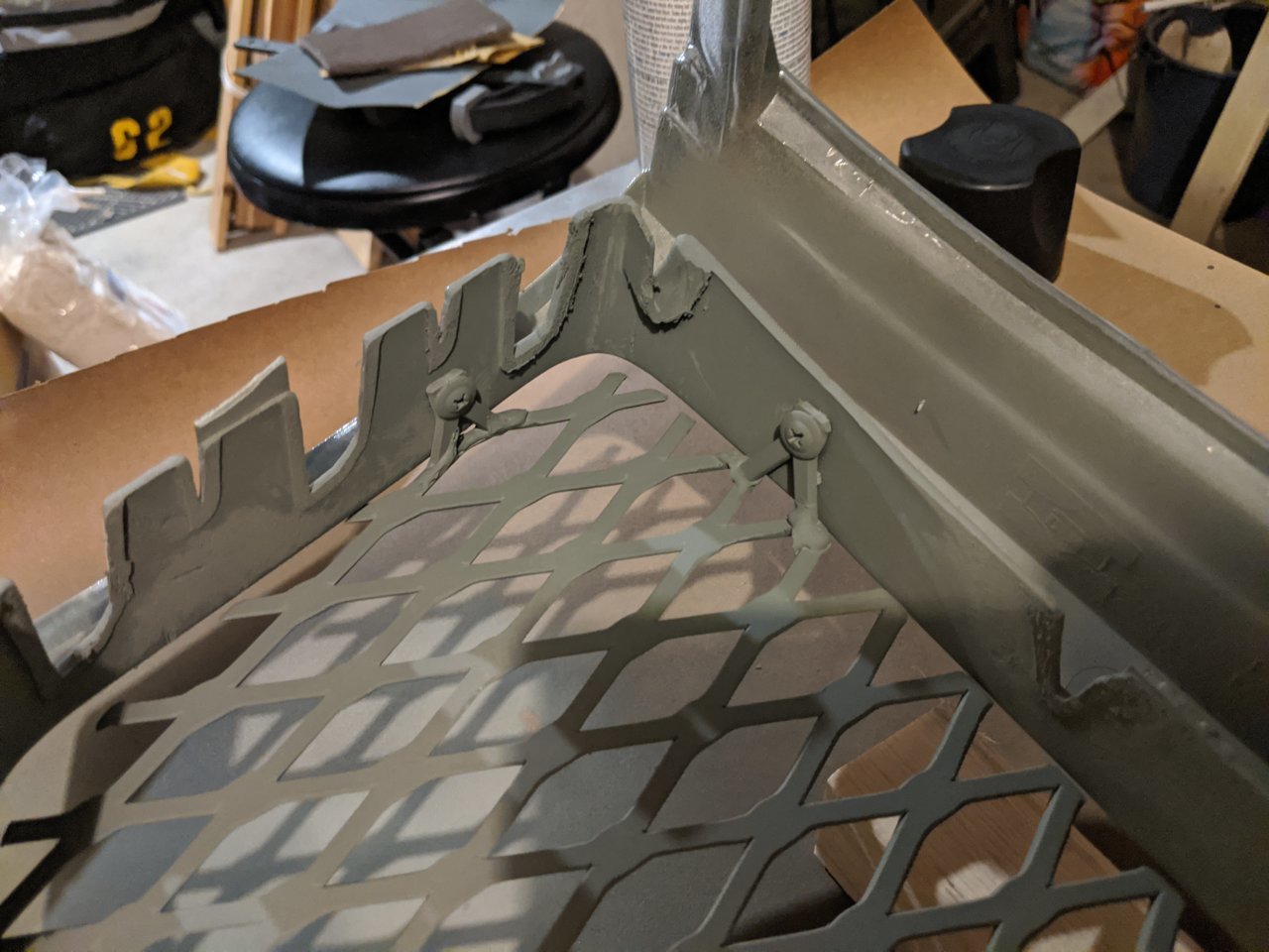

    Nice. How'd you attach the expanded metal to the grill?
    ERMB[OP] likes this.
  9. Feb 2, 2020 at 6:30 AM
    #209
    ERMB
    ERMB [OP] Well-Known Member
    Mar 11, 2011
    #52813
    10,395
    2002 Land Cruiser
    I used Alumiweld, it's a low temp rod that melts using a butane torch. I made tabs out of the scraps and welded them on at about 10 different points.

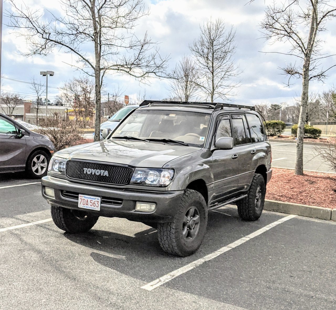

    Finally mounted up and out in the town!

    Are those 33s?
  12. Feb 2, 2020 at 8:43 AM
    #212
    ERMB
    Mar 11, 2011
    #52813
    10,395
    2002 Land Cruiser
    Yes, 295/75/16 they're 33.4

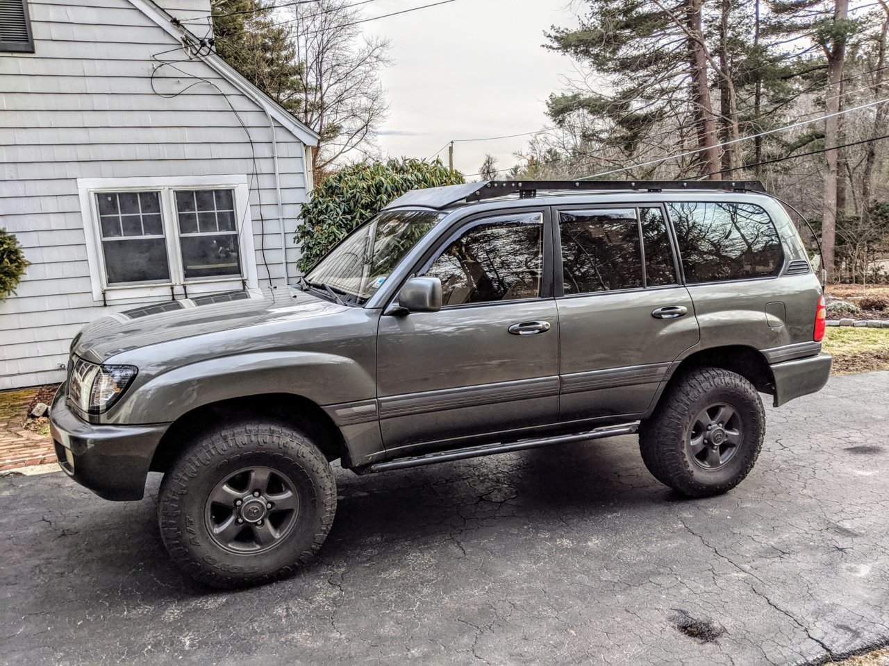

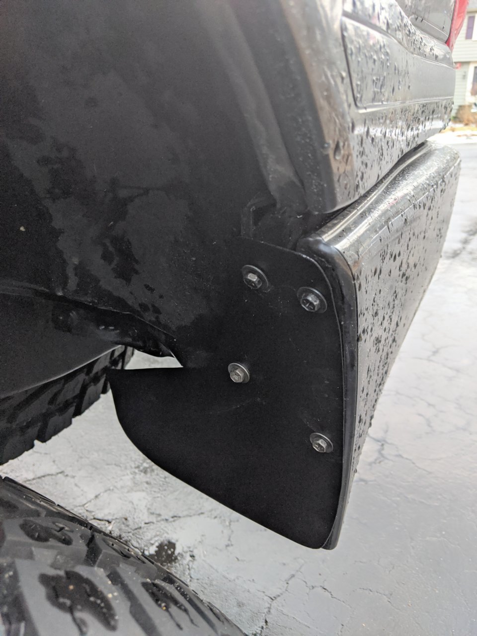

    This past weekend I finally finished up some small projects that I had been putting off. I made some mud flap delete panels to cover the area behind the bumper and add a few more inches of clearance. I also made a fairing for my roof rack.

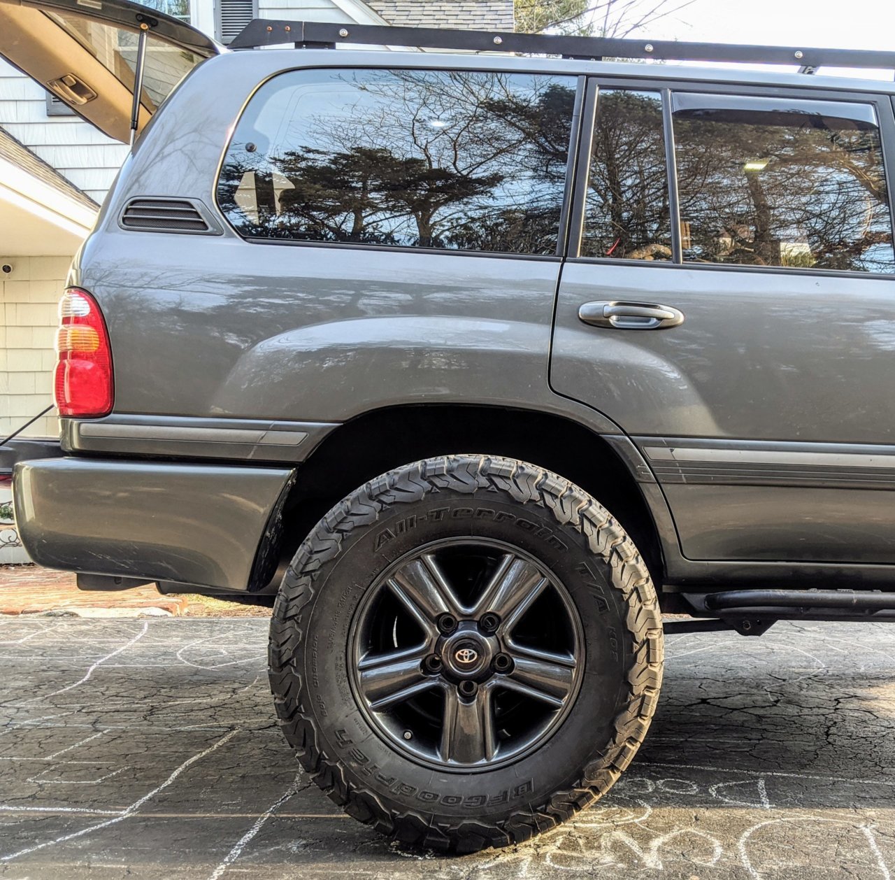

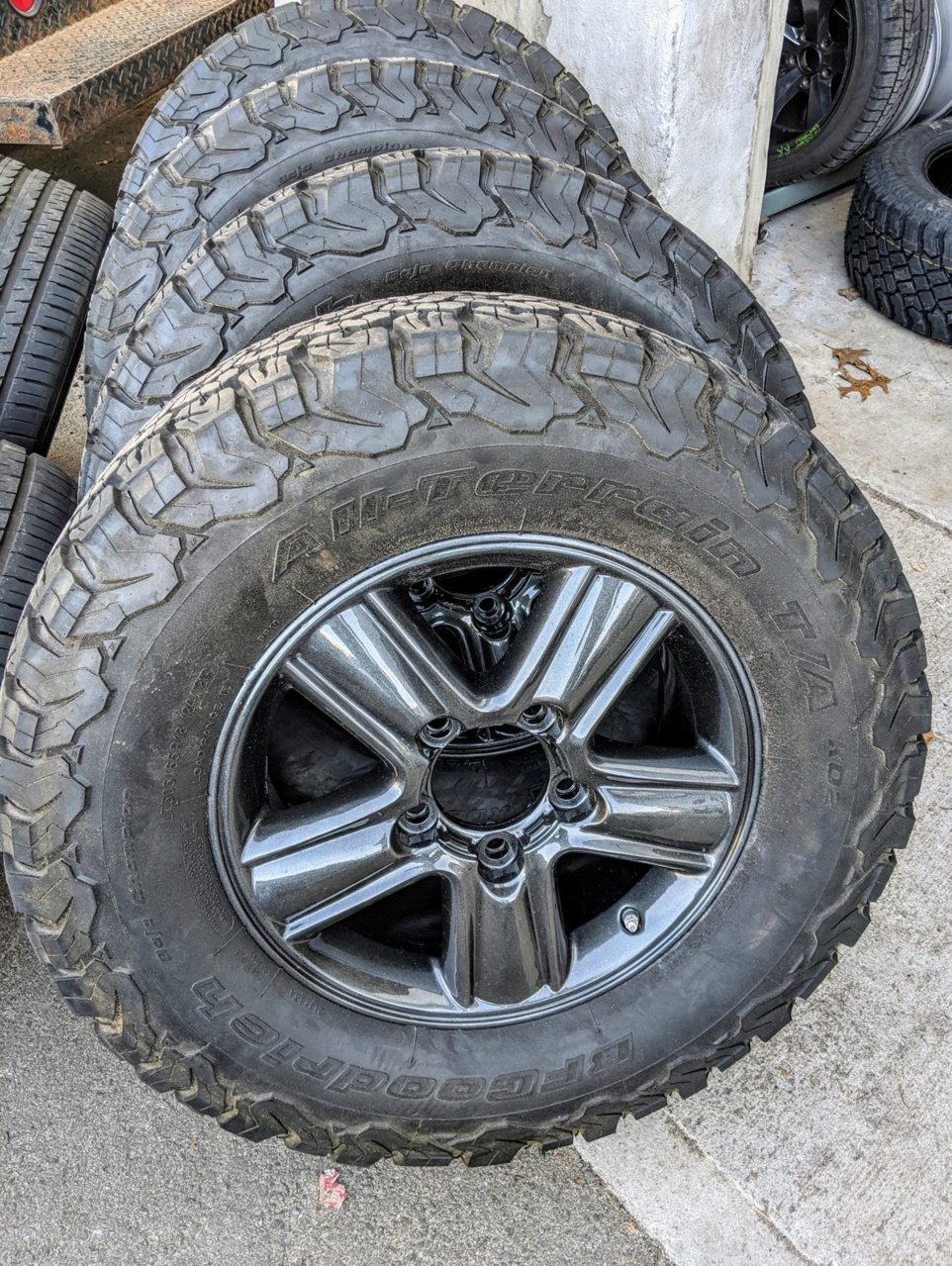

    Had a set of LX wheels powder coated a Dark Metallic Gray. Need to get some work done before they get put on but I'm looking forward to the new set up. Tires are BFG 305/65/18

    Damn 305s look so good on a landcruiser

    BFG's not Toyos? :goingcrazy:
    Lol
  19. Feb 26, 2020 at 4:36 AM
    #219
    ERMB
    Mar 11, 2011
    #52813
    10,395
    2002 Land Cruiser
    Haha, Yep! I got a smokin deal on these awhile back and they have just been sitting in my garage. I still need to get some front end work done before they can go on, so hopefully I can do that pretty soon.
